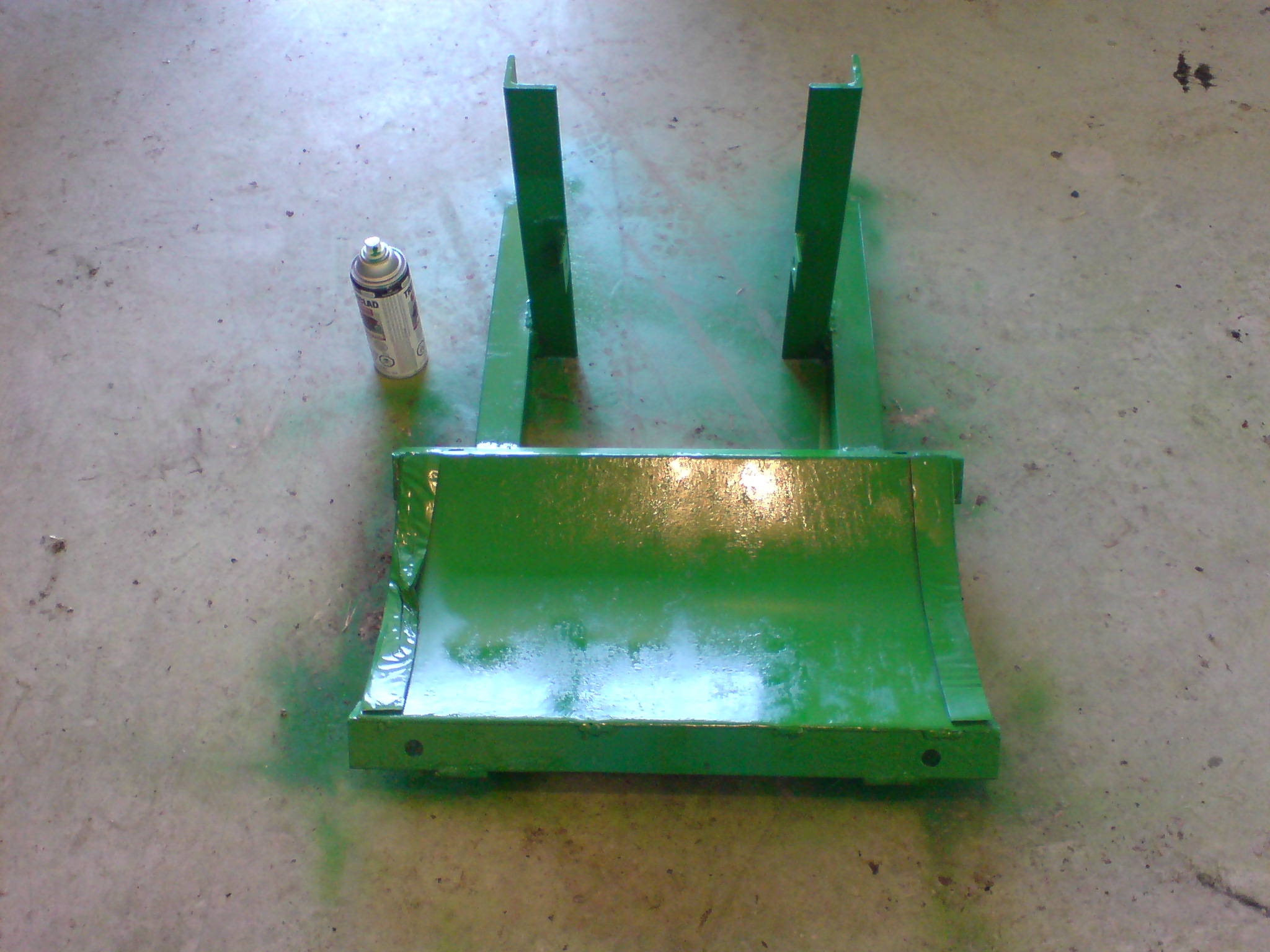

I had someone give me a bucket scraper. I'm thinking I could fill it with something to use as a ballast.

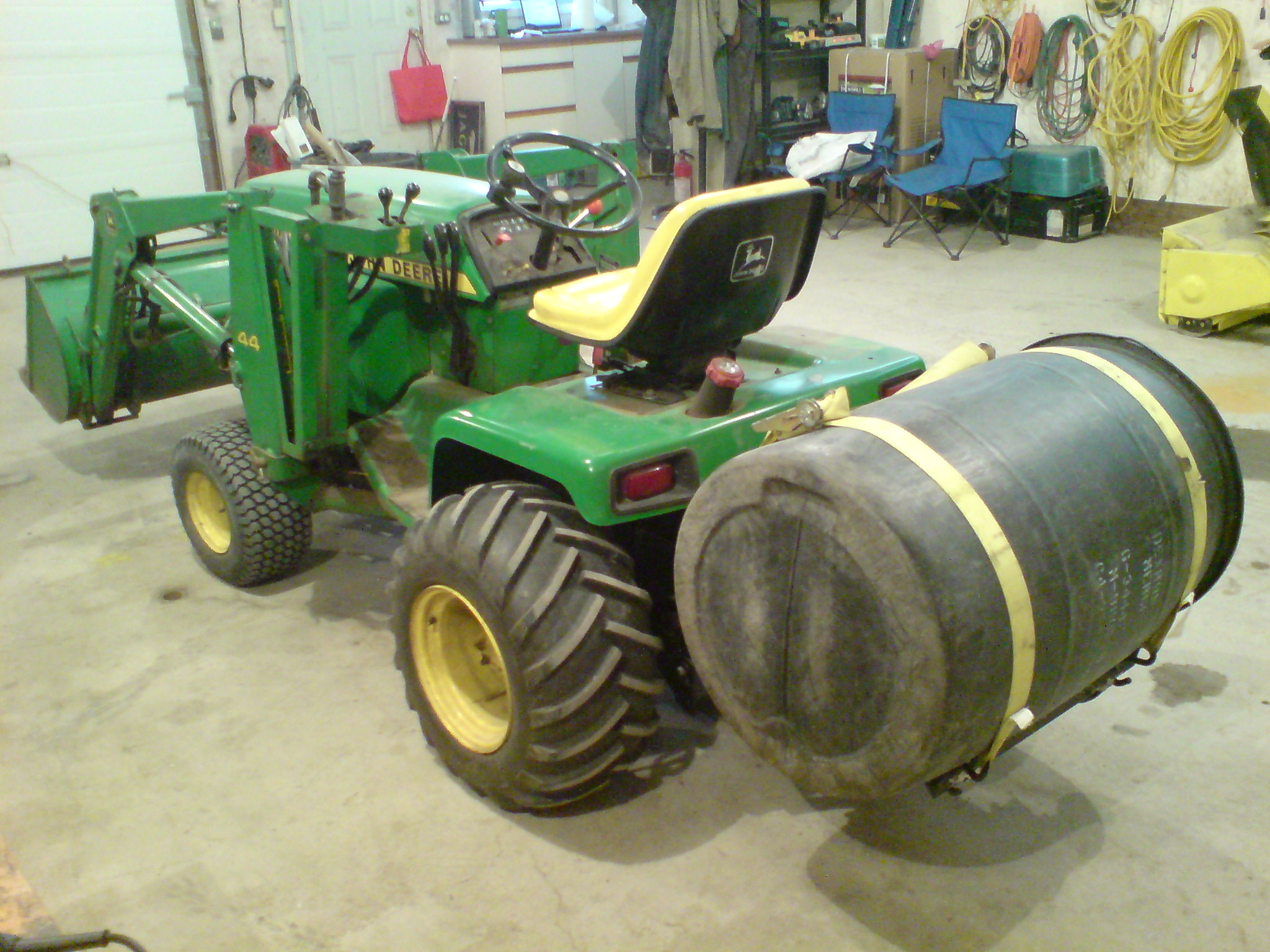

This is what I used
   / Rear Ballast Gentlemen, Rear Ballast #43
Looks pretty sweet.
What's in that puppy ?
   / Rear Ballast Gentlemen, Rear Ballast #44
Just water. I don't use the loader in the winter so I can empty it and store it till next summer.
   / Rear Ballast Gentlemen, Rear Ballast #45

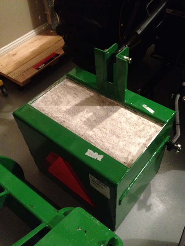

I've only had my tractor for a few weeks and decided to start with the ballast box filled with concrete. I like the idea that I cal take the weight off when I mow. If I need more weight, I'll get the tires filled. It's been good so far...
