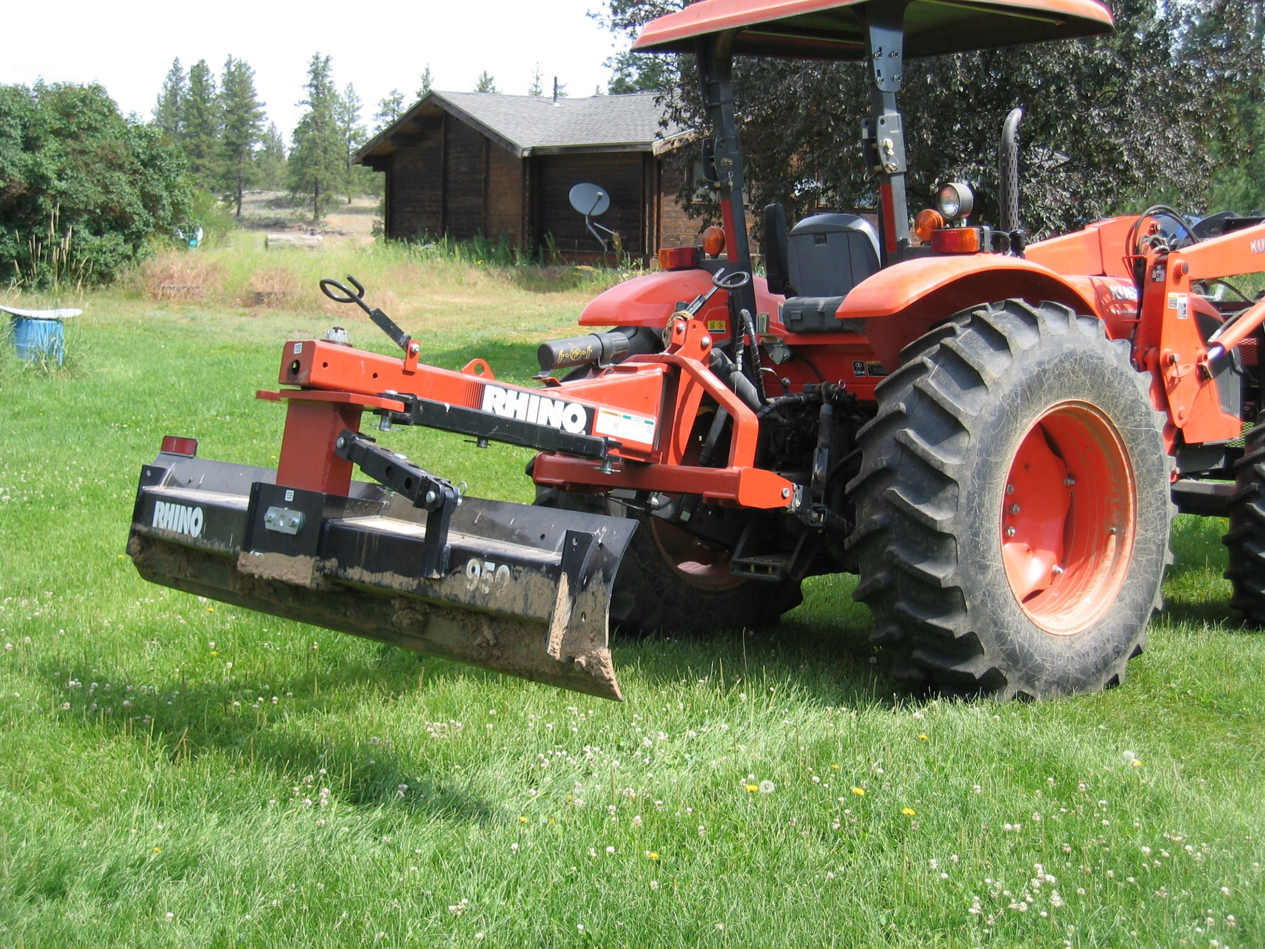

WoW! Somebody with a setup almost identical to mine. I have everything except the cab. I have an 820# Land Pride grapple - SGC 1560 - on the FEL. With my Rhino rear blade, RimGuard filled rear tires & grapple - it tips the grain scales @ 10,100#.
I initially had a Land Pride 2584 rear blade on the M6040. It was not wide enough nor heavy enough. When offset and angled the "cut path" was simply too narrow. And it was not heavy enough to cut into my summer time, concrete like, driveway. Up/down - back/forth on the driveway. All it did was make sparks and create frustration. I have a mile long gravel driveway. After forty years the surface is now gravel, sand, silt & volcanic ash. Turns to concrete after the spring rains.
So........ I upgraded to an eight foot 950 Rhino. 96" and 1050#. WHAT A WORLD OF DIFFERENCE. Along with my FitRite hydraulic top link - I'm now a real grading machine. The Rhino works well on the M6040. I've done grading with it to the point of completely stopping the tractor's forward movement and had all four wheels digging.
It's an expensive Cat 2 rear blade but it really shines behind my tractor. You won't be sorry if you choose a HD Rhino.
BTW -- the only hydraulics on my rear blade is the top link. The remainder are all manual.

DPSailor - I had to drive to a small town and buy the Rhino from the AGCO dealer. 65 miles one way AND he only had a ten foot Rhino 1450 to look at. I bought the 950 sight unseen. It is the ONLY implement I've ever purchased and not seen it first. It was really difficult to visualize the 950 while looking at the 1450. The 1450 would be for 100hp tractors and larger. And the last bit of info - in 2017 the blade cost $3295 brand new. Plus our state sales tax - $310. The blade with tilt, angle and swing hydraulics was around another $1200.
I know it's a whole lot of $$$$. But in my case I need all the weight I can get to grade my driveway with any success.
BTW - CoyPatton - #13 above, makes the points I would have made - no need to duplicate. I DO reverse the blade quite often. Plowing snow when the driveway isn't frozen up rock hard. Drag & smooth lumpy ground.
Blade width and the ability to offset is very important to me. It allows me to plow snow off the driveway in spots where there is a substantial drop off right at the edge of the driveway. I don't have to put the tractor tires right on the bloody edge of the driveway to get the snow plowed off the driveway.
