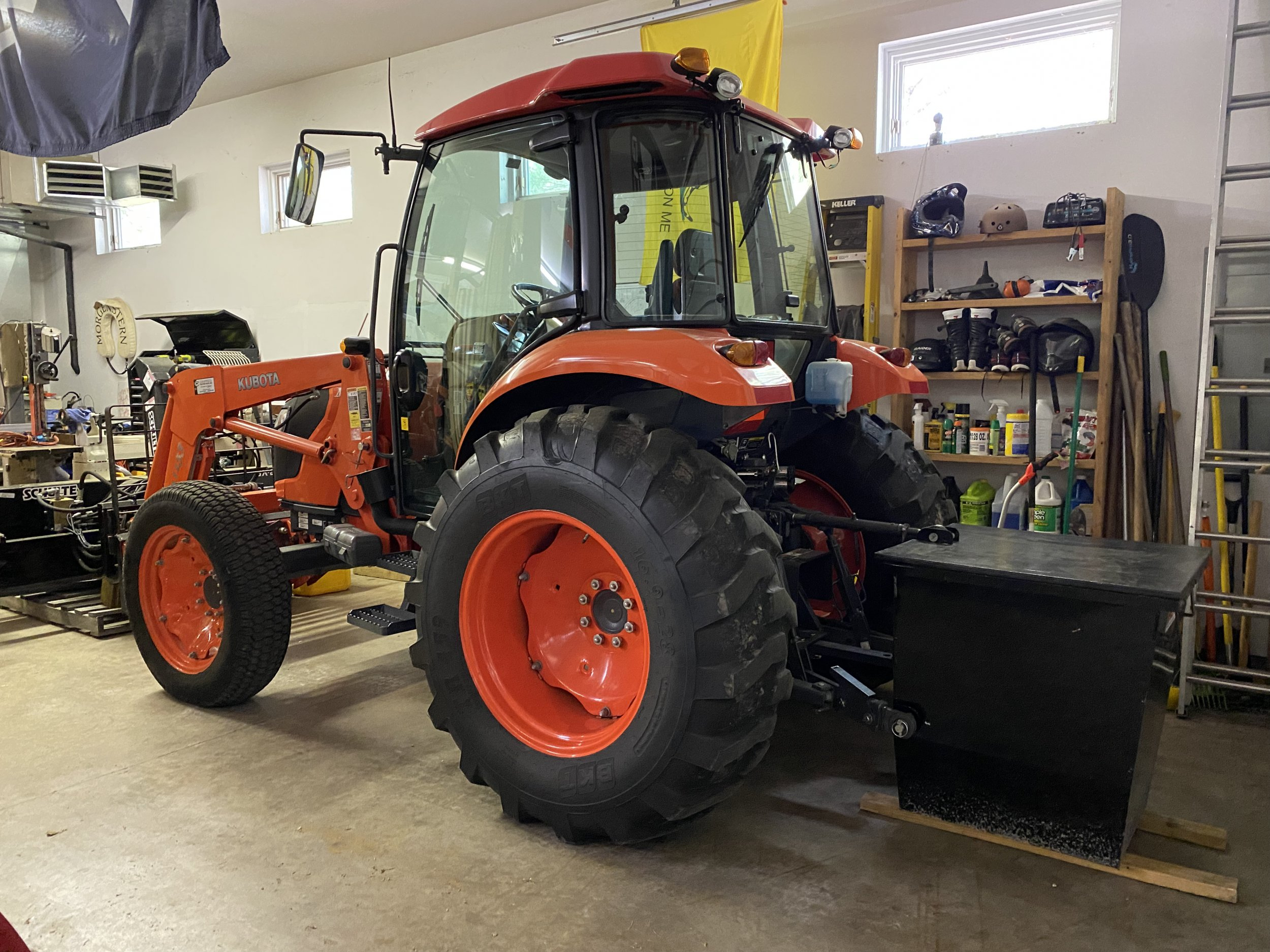

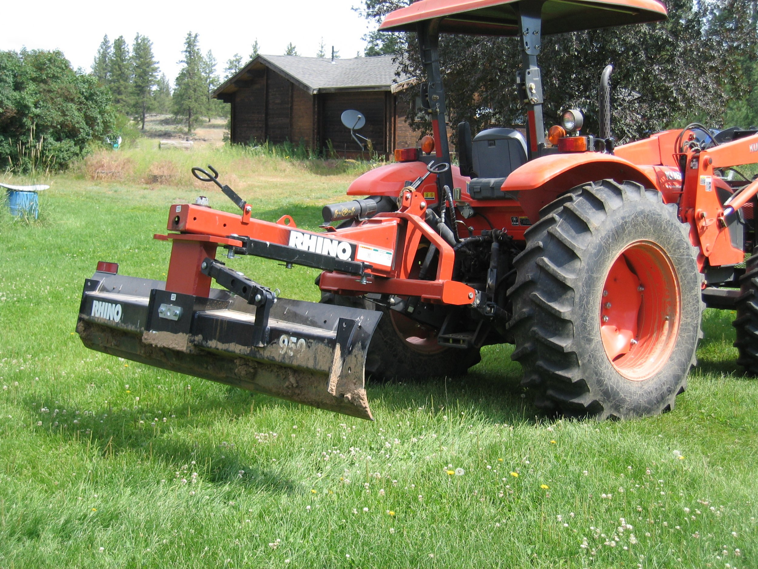

I have a Kubota M6040. The tires are 82” wide so leaning towards an 8’ blade. With filled tires and the loader, I’m right at about 10,000 pounds. I’m in NH so rocky soil. My intent primarily is improving my trails in the woods so cutting into hillsides to level off. I’ll also do some ditching. Not likely for snow removal.
I do have a box blade on order, EA, and not likely to see that until fall.
Locally, I have a Landpride RB3796 and a Mahindra heavy duty 8’. Same price for both. The Mahindra is at 700 lbs, 40 more than the Landpride. I was set on the LP but I went to look at it and the welds were filling a gap where the angled support brackets met the crossbeam. The salesman assured me this is how they are made but I’m a little leery.
I could order an EA but would like to be working on this prior to the fall.
This is my first tractor at this property and would appreciate anyone’s input.
Are either of the local blades sufficient? Should I look at other brands or models? I don’t think hydraulics are necessary for me.
Thanks

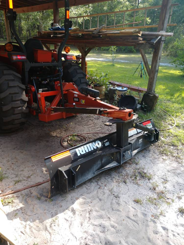

I had a light weight blade and quickly broke it, I think it was TS. Last year I found a used rhino 850- 7' blade. It weighs a little over #900. It made the other one seem like a toy. The weight makes a big difference in cutting so IMHO the heavier the better. The second factor is length behind the tractor. The further back the smoother the finish. The third and most important it blade adjustability. A 6 way blade will do more and you'll use it more. Hope this helps. BTW if my tractor was as big as yours I'd go with the rhino 950 with hydraulics and the tail wheel option

Thanks everyone for the replies. I’ve got a call out to the Rhino dealer in Concord to see what they have.
The 850 and 950 both look like tanks.

Nothing less than 800lbs, heaver the better and an 8 foot blade for sure. 7' is to narrow for your tractor and a 9 footer would be the tail wagging the dog IMO. Might want to keep an eye open for how much offset capability the blade has if you have ditches and the like to clean out. They do build them different, ranging from 24" up to 35" I believe for a good 8' rear blade.

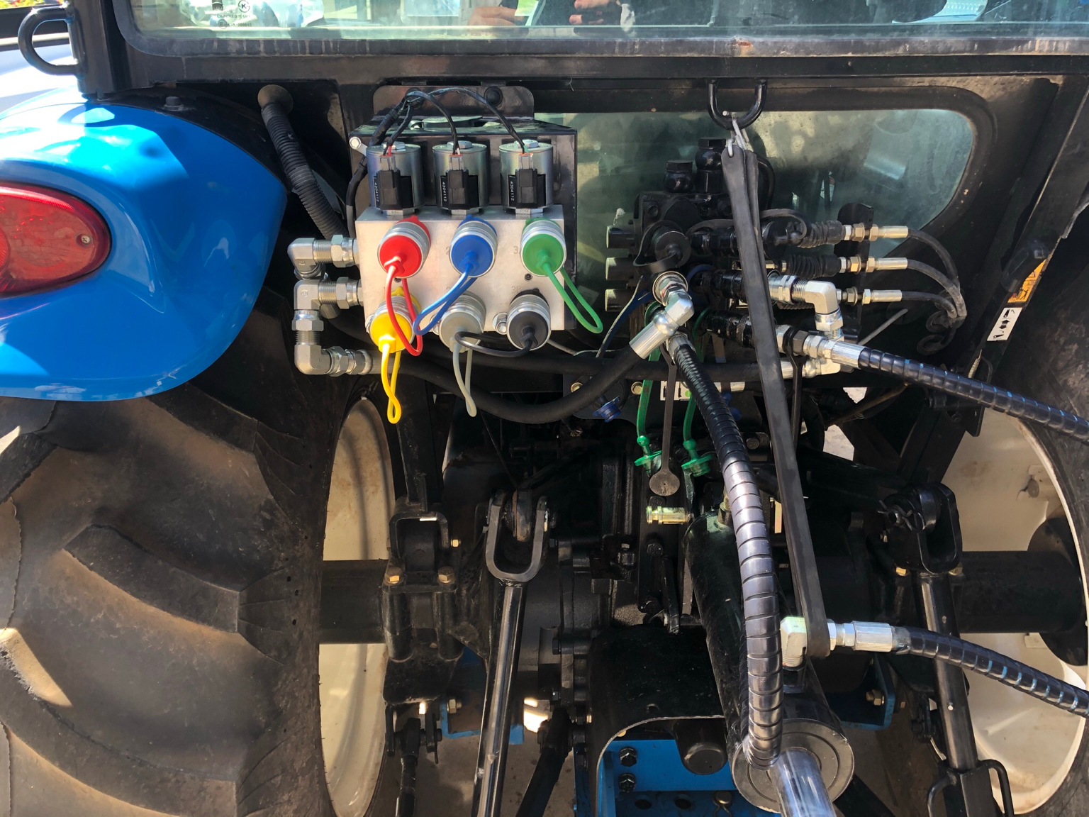

I just received my 96” EA blade. It seems very well built, but other than moving some loose dirt and gravel, I haven’t put it to the test yet.
I opted for the manual tail wheel, so once it’s set to grade it can’t drift or be moved by bumping the wrong hydraulic control.
I installed a Summit 3 stack multiplier so I can operate all three functions and the hydraulic top link and still have my detented remote free.
/ Rear Blade choice #10
Mr. 3LFarms, greatly interested in details on the Summit setup.
Looks like you have an original set of 3 remotes, and the Summit is using one set, your Top & Tilt are using the others?
Was it plug and play to add, or were there significant modifications necessary?
Did you have to order the hydraulic lines separately?
Any chance of seeing a photo of the control box?

WoW! Somebody with a setup almost identical to mine. I have everything except the cab. I have an 820# Land Pride grapple - SGC 1560 - on the FEL. With my Rhino rear blade, RimGuard filled rear tires & grapple - it tips the grain scales @ 10,100#.
I initially had a Land Pride 2584 rear blade on the M6040. It was not wide enough nor heavy enough. When offset and angled the "cut path" was simply too narrow. And it was not heavy enough to cut into my summer time, concrete like, driveway. Up/down - back/forth on the driveway. All it did was make sparks and create frustration. I have a mile long gravel driveway. After forty years the surface is now gravel, sand, silt & volcanic ash. Turns to concrete after the spring rains.
So........ I upgraded to an eight foot 950 Rhino. 96" and 1050#. WHAT A WORLD OF DIFFERENCE. Along with my FitRite hydraulic top link - I'm now a real grading machine. The Rhino works well on the M6040. I've done grading with it to the point of completely stopping the tractor's forward movement and had all four wheels digging.
It's an expensive Cat 2 rear blade but it really shines behind my tractor. You won't be sorry if you choose a HD Rhino.

Some recommendations
•width—you want enough width to cover your tread stance at an angle of 45 degrees
•weight-for digging into hillsides this is your best friend ever! Buy as heavy a blade as your budget allows that your tractor will lift without struggles
•hydraulics—they will make a world of difference in what you are able to do. Not only do you get the connivence of making adjustments from the seat, but more importantly is you will make those adjustments to get the desired results instead of settling for what it is (after several trips off the tractor, fighting with a heavy implement and getting even less accomplished that ‘settling’ for results becomes more common and more frustrating). Get as many hydraulic adjustments as possible.
•offset blade—if digging/cleaning wet ditches this is a must. Hydraulic adjustable is a nice benefit if doing several jobs or differing depth ditches. This is also a nice feature for hillside cutting as it allows the tractor to remain away from the slope of the hill as you cut into the hill side.
One draw back to hydraulic angle adjustment is if you like to use the blade in a reverse and forward orientation. It typically requires more work than pulling a pin and pushing the blade around. But it is most folks opinion this is far outweighed bu the benefits gain with hydraulics.

DPSailor - I had to drive to a small town and buy the Rhino from the AGCO dealer. 65 miles one way AND he only had a ten foot Rhino 1450 to look at. I bought the 950 sight unseen. It is the ONLY implement I've ever purchased and not seen it first. It was really difficult to visualize the 950 while looking at the 1450. The 1450 would be for 100hp tractors and larger. And the last bit of info - in 2017 the blade cost $3295 brand new. Plus our state sales tax - $310. The blade with tilt, angle and swing hydraulics was around another $1200.
I know it's a whole lot of $$$$. But in my case I need all the weight I can get to grade my driveway with any success.
BTW - CoyPatton - #13 above, makes the points I would have made - no need to duplicate. I DO reverse the blade quite often. Plowing snow when the driveway isn't frozen up rock hard. Drag & smooth lumpy ground.
Blade width and the ability to offset is very important to me. It allows me to plow snow off the driveway in spots where there is a substantial drop off right at the edge of the driveway. I don't have to put the tractor tires right on the bloody edge of the driveway to get the snow plowed off the driveway.

Straight blades are typically used set to an angle (45 degrees) so tweaking one is a chore. You really want it to cover your rear tire stance at the 45 degree angle
