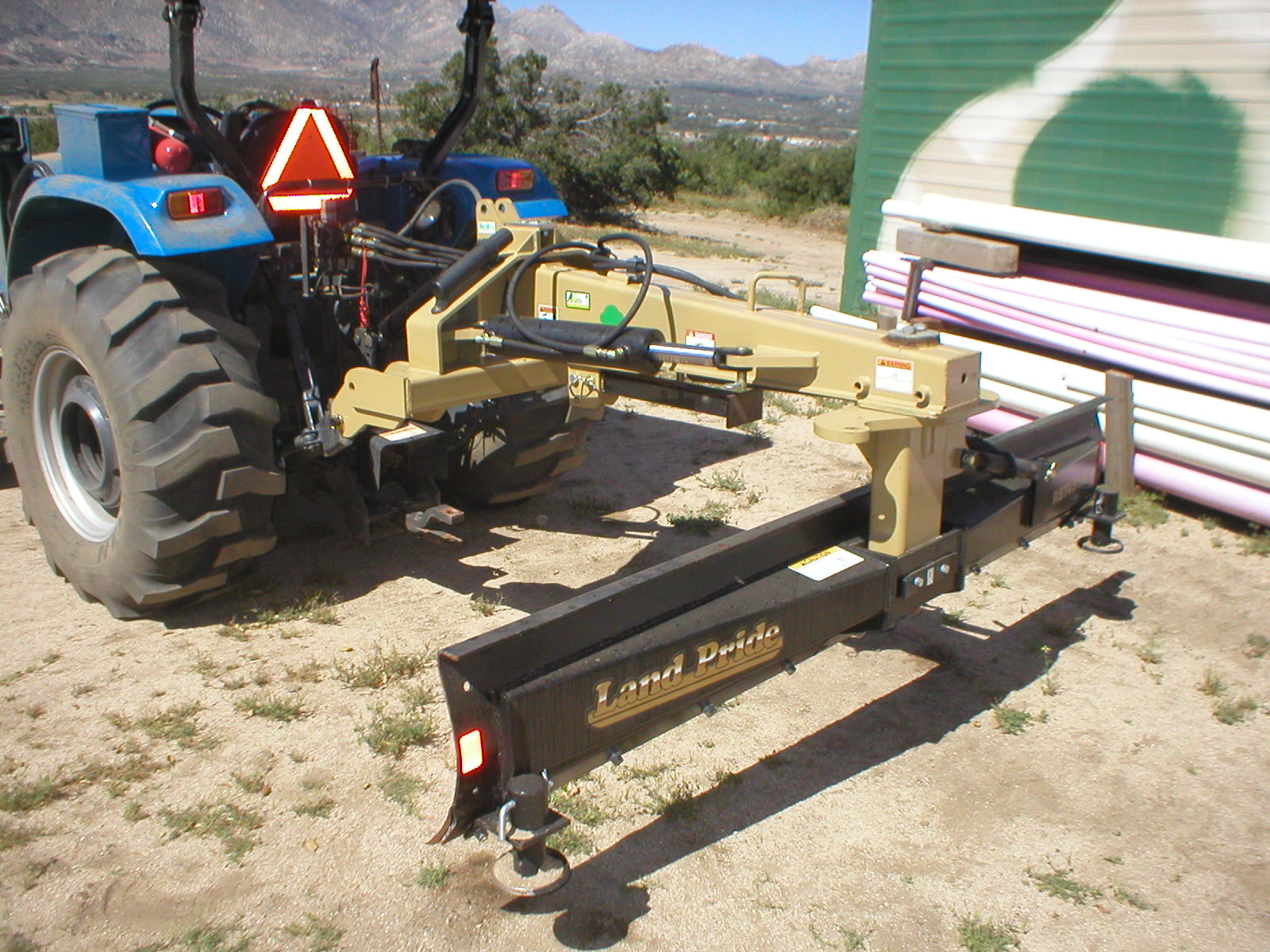

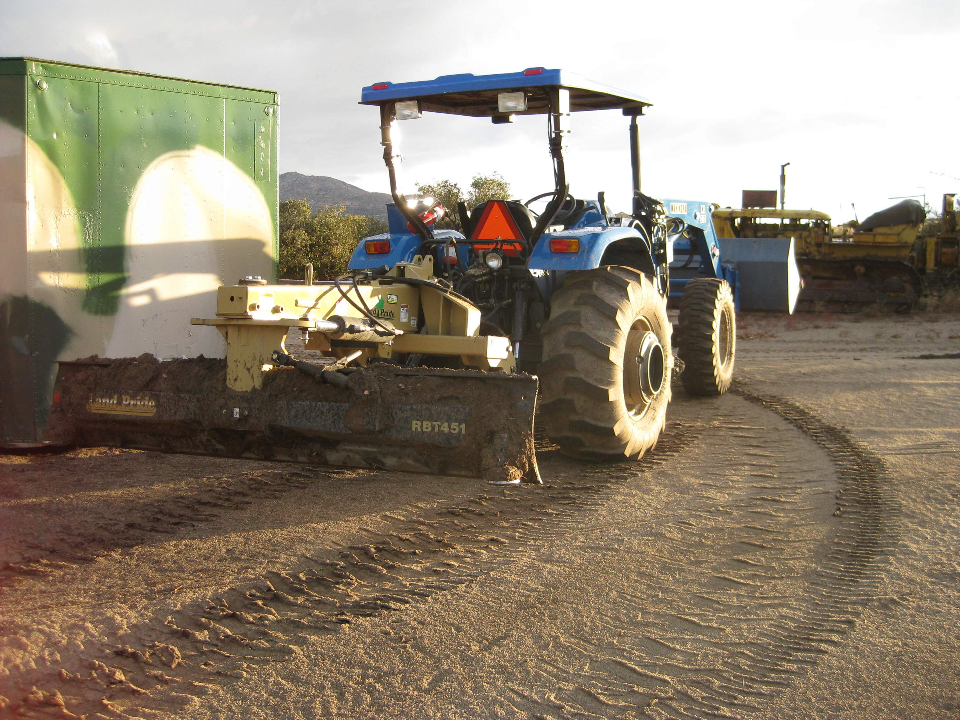

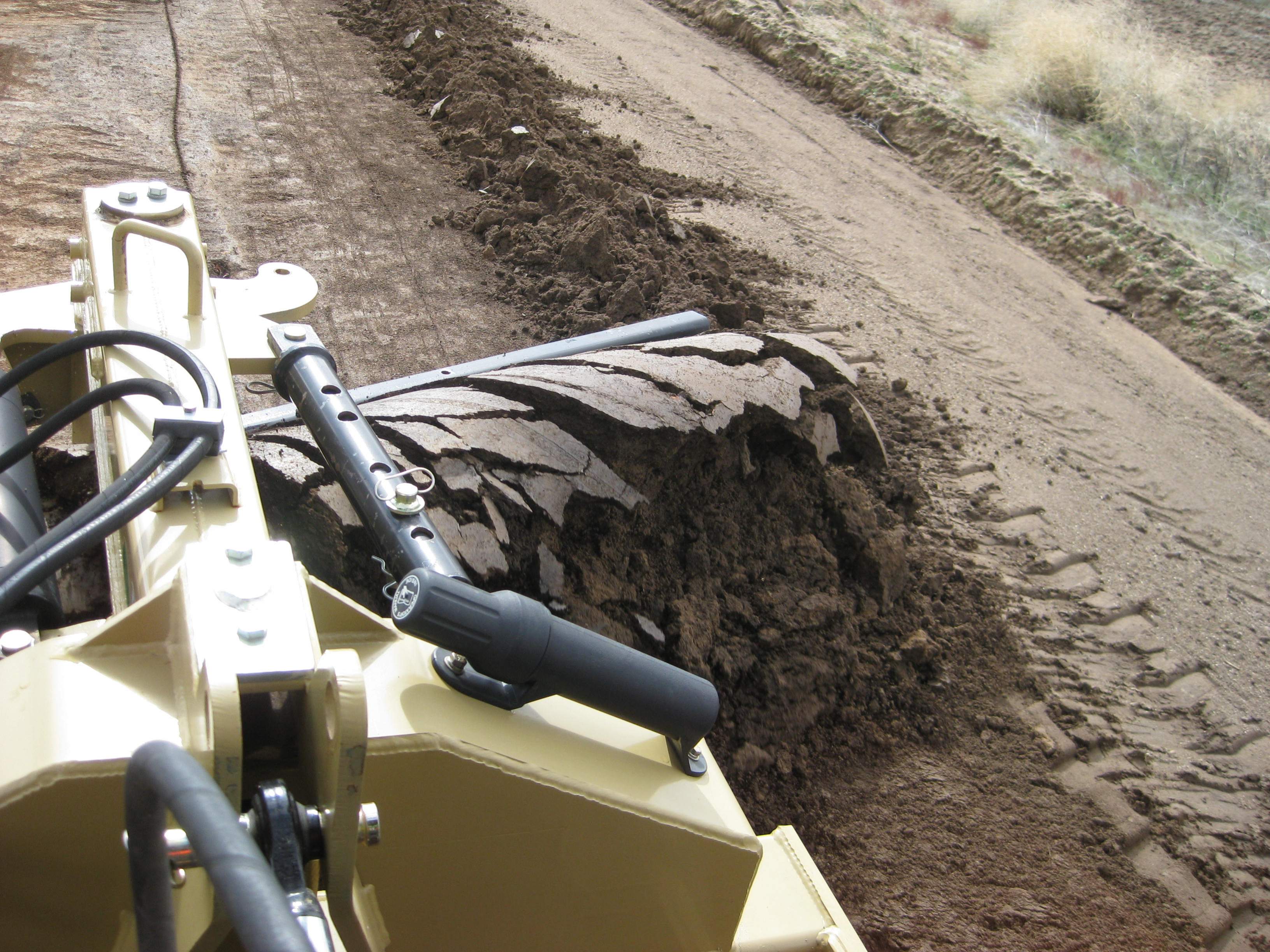

To start with, I don't think that you will tear your tractor apart if you get the used blade, but you will never be able to use that blade to it's capabilities and depending on what all you will be using it for, could actually be a hindrance for you IMO.
Several variables to consider.
How heavy is your tractor?
How aggressive do you want to be able to cut?
Are you grading virgin ground?
First off without actually seeing the conditions of the different things that you will be doing, all any of us can really do is get you an educated guess.
My initial feeling is to go with the RBT96. But if you have the tractor ballasted up to or over 10,000lbs, then the RBT108.

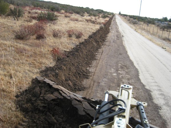

I have an RBT108. My tractor is 75hp and over 12,000lbs. If I happen to get to big of a bite or hit an immovable object under the surface I can be going side ways very quickly. :eek: This gets magnified a lot as the blade gets wider, (I use to have an 8' blade and this never happened to me) thus my recommendation against getting the 10' blade. Also keep in mind that there is a reason these bigger blades have a cat 2-3 hitch, to be used behind a cat 3 size tractor far more capable than the cat 2 machines.
With our cat 2 size machines, sometimes it's like the tale wagging the dog type of thing. I ended up with the RBT45108 series because it was the only cat 2 rear blade rated for over a 10,000lb machine and like you mentioned, could cover my tracks when angled a little more aggressively. Although I have found that I typically use the blade at a 35*-40* angle and vary rarely have it at 45*. But then I don't use it for snow, and that seems like it would be a good time to have it over at 45*.
I also highly recommend skid shoes and learn how to make use of your draft control. Makes for much better and easier grading. No tail wheel required once you get draft control dialed in. :thumbsup:
One last thing, again without knowing your exact situation and conditions, I highly recommend a top & tilt set. Makes it so you have hydraulic tilt capability with all your implements , not just your rear blade. Get the rear blade with a manual adjust blade tilt. My blade recommendation and to save some $$$ is to get the blade without any hydraulics or blade offset or angle adjusters at all, simply because of the tie rod cylinders. You can get welded cylinders which are typically better quality for less money than what LP charges for the tie rod units that they provide. You should be able to get the welded cylinders for about what LP charges for the manual adjusters alone.
But all of this may be to much of a hassle, then just get the std LP stuff and be happy. All the RBT series blades are very good units IMO.
Good luck with your decision. ;)
