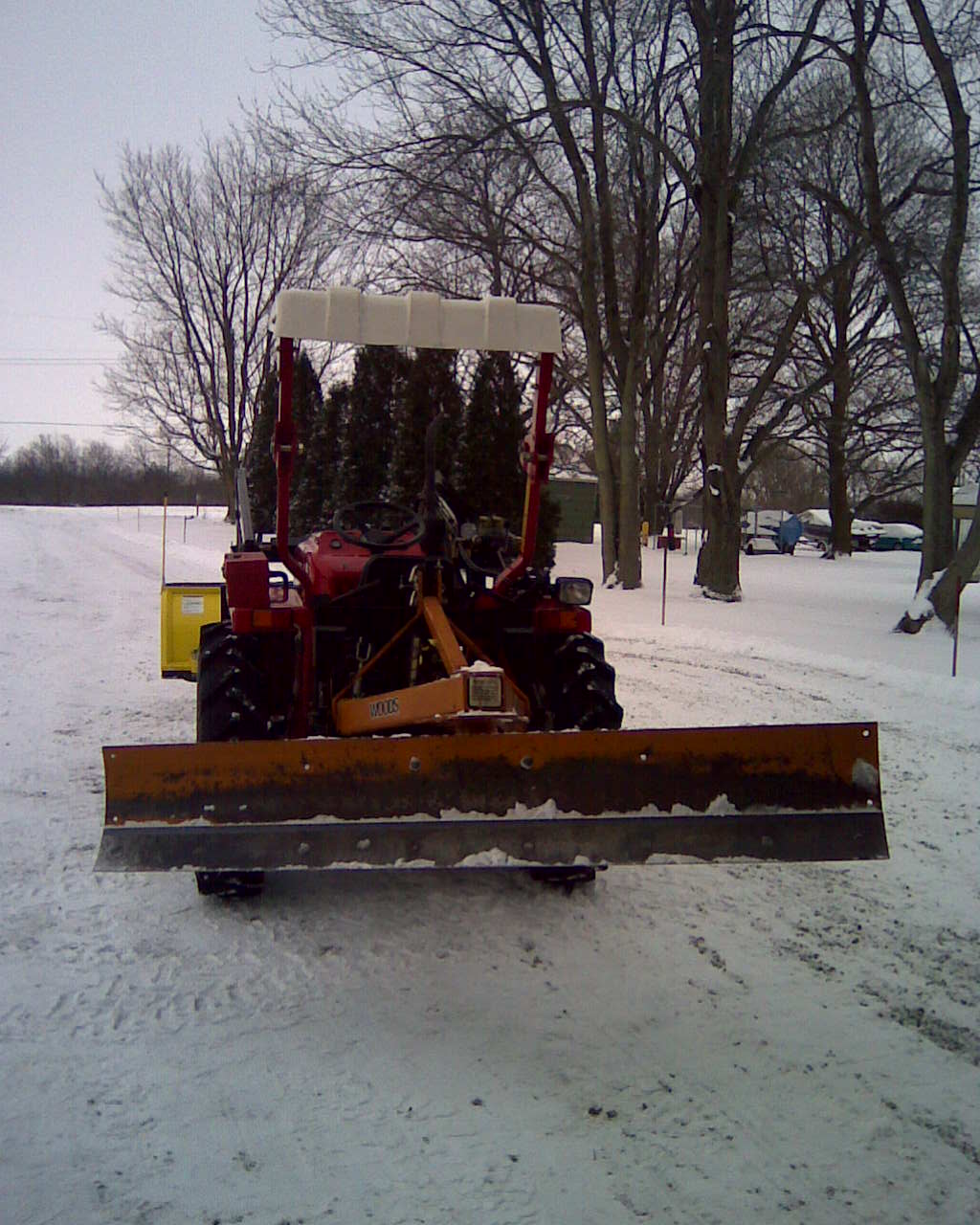

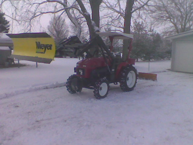

I have exclusively used a rear blade for snow removal. Now I want to do what cspot did with an old snow blade I have. That way I can work in both forward and reverse just like I do with Loader Buddy the other three seasons of the year.

I found that on a dirt/gravel drive it is much easier to plow with either skid shoes or a pipe over the cutting edge. I tried the black abs pipe and it just wouldn't stay on so I fabbed up a 1 1/2" section of water pipe and attached it to the skid shoes, works great and is really fast. The only drawback is that since it doesn't cut removeing sections that have frozen solid isn't as easy.
I live on Northern California and most the snow tends to be wet and sticky so sometimes when plowing I just have to stop and raise the blade to get out of the giant pile I'm dragging, I can then either push it out of the way backwards or move it with the loader on my way back.
A couple of things to remember if you get lots of heavy snow tire chains are the way to go. We got a couple of late season snows after I had removed mine and depending on the snow I was sliding all over the place. Gravity is your friend, I have one grade on my drive that can be hard to plow going up so I try to do the bulk of it going down hill.
I think one last thing to remember is what quality of plowing do you want, does it have to be down to bare eart/asphalt or like us do you have 4wd vehicles so some snow isn't a problem.
With all this said I still want a front blade mounted to my loader I think it would save time, but a rear blade works fine also.

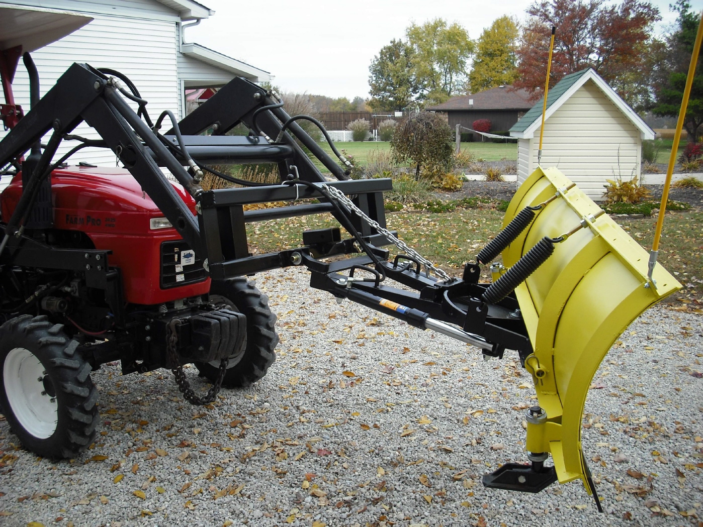

Thanks to everyone for the helpfull advice. My concrete drive is around 200 ft and is level except for the last 20 feet which slopes down to meet the road. I was worried about damaging the drive with the blade so I'll definately do the black pipe deal. Hopefully I want have any trouble getting it to stay on the blade. I love your setup Cspot. I've welded since I was 15 so this is something I could do with some coaching and some detailed pics. I'll go with the rear blade this season and see how well this works for me. I didn't think about tire chains. I guess I'll invest in a set of them also. My daily driver is a lifted Jeep Wrangler 4 door and it is amazing in 8in snow.(That's the most snow I've ever seen.) From talking to all the good local folks, I know I'm in for alot more snow than that. I'm a Georgia native but have lived in Texas, Missouri, and now here in NE Indiana. This winter is going to be a new experience for me.

I have been doing it with this combination for about 20 years now. Just recently had a snowplow from a truck given to me so when I get some time I am going to build a setup to put it on the loader. Hope to pave the driveway next year so the front blade should be an advantage. As I have stated in previous posts, on my gravel drive I used the blade backwards and had very little stone to rake from my yard in the spring.

I have skid shoes on my back blade and use the hydraulic top link to engage them (top link retracted) or the cutting edge (top link extended). Kind of the best of both worlds for my gravel drive. Gotta get that front blade done......

If you decide to go with the rear blade you will want one large enough to cover your rear tire tracks with the blade angled 30 or 45 degrees.
To figure the length you need for 30 degrees, multiply your rear tire track width by 1.15 To figure the length you need for 45 degrees, multiply your rear tire track width by 1.4.
