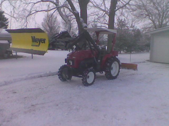

North of I 70 its night a day different and the more north east you are like me 12" dumps are common and its wet and heavy. R1 tires are the best on a 25 to 35 HP 4x4 tractor or chains will be a must. I used a 7' grader blade and my FEL on my 28HP Jinma with the tires loaded and front and rear weights, about 5,600# and have had no issues.

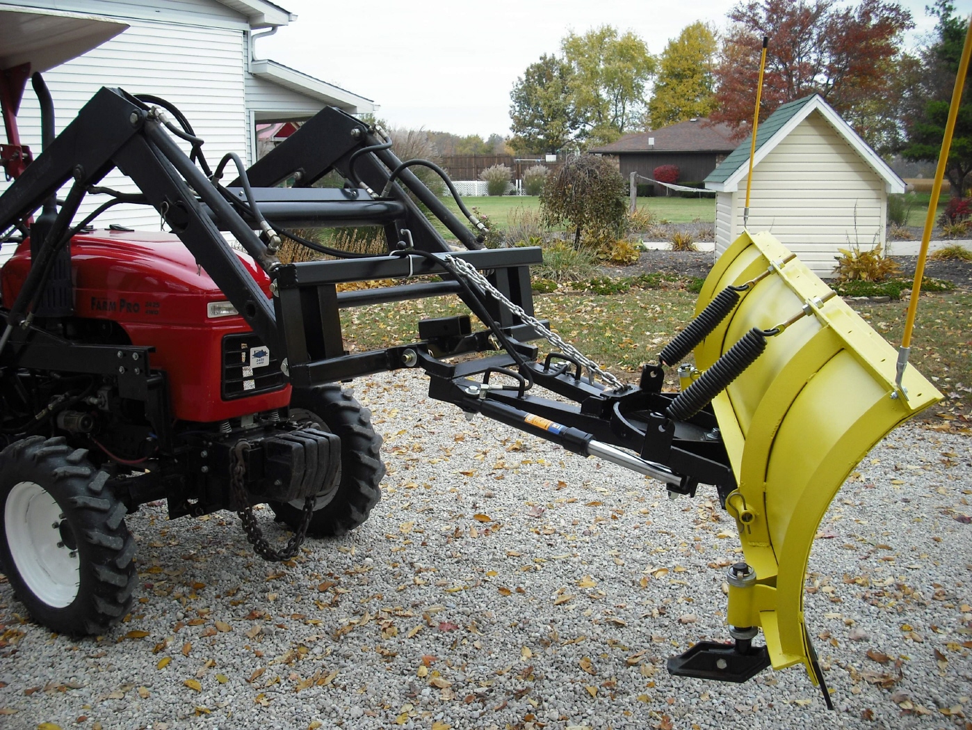

2 years ago I upgraded to a 7' plow that fits on my FEL in place of the bucket. It has angle capability and cuts the plow time in half or more.

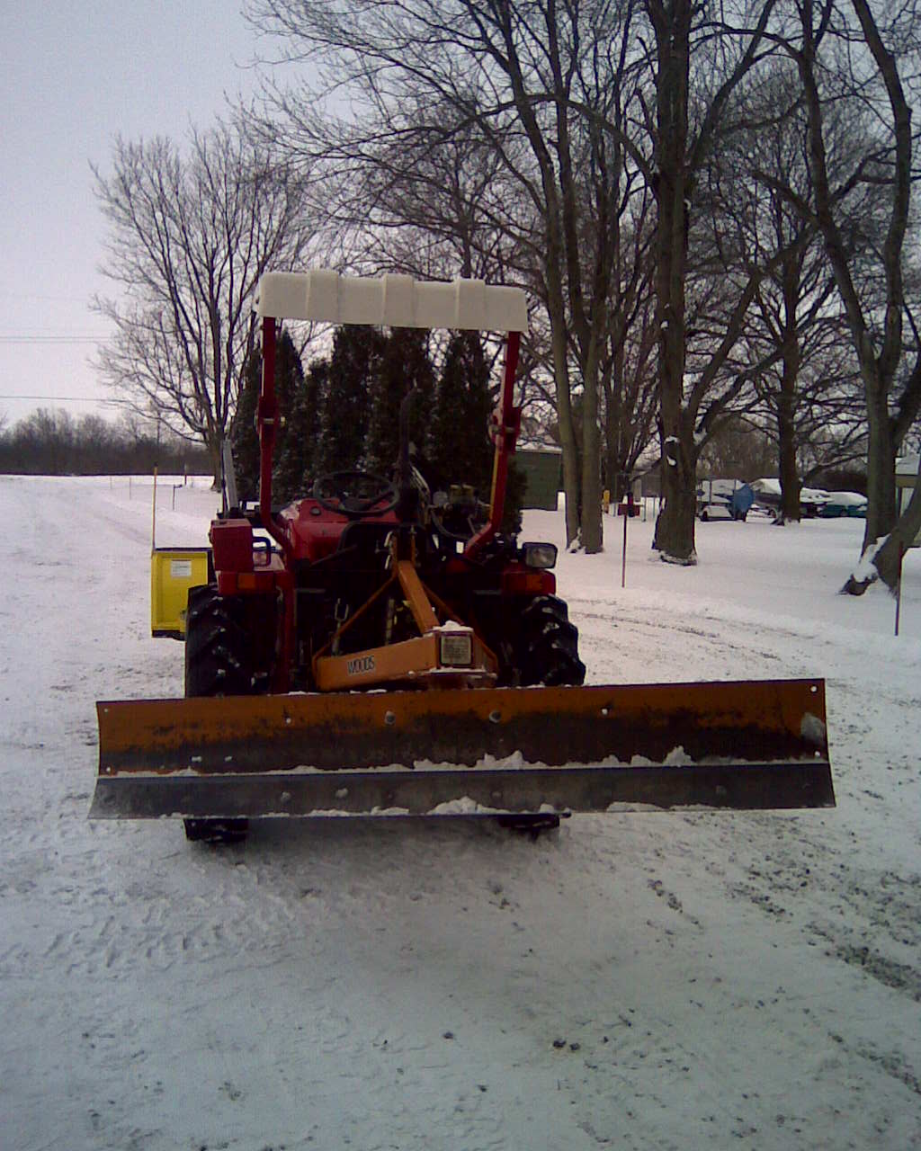

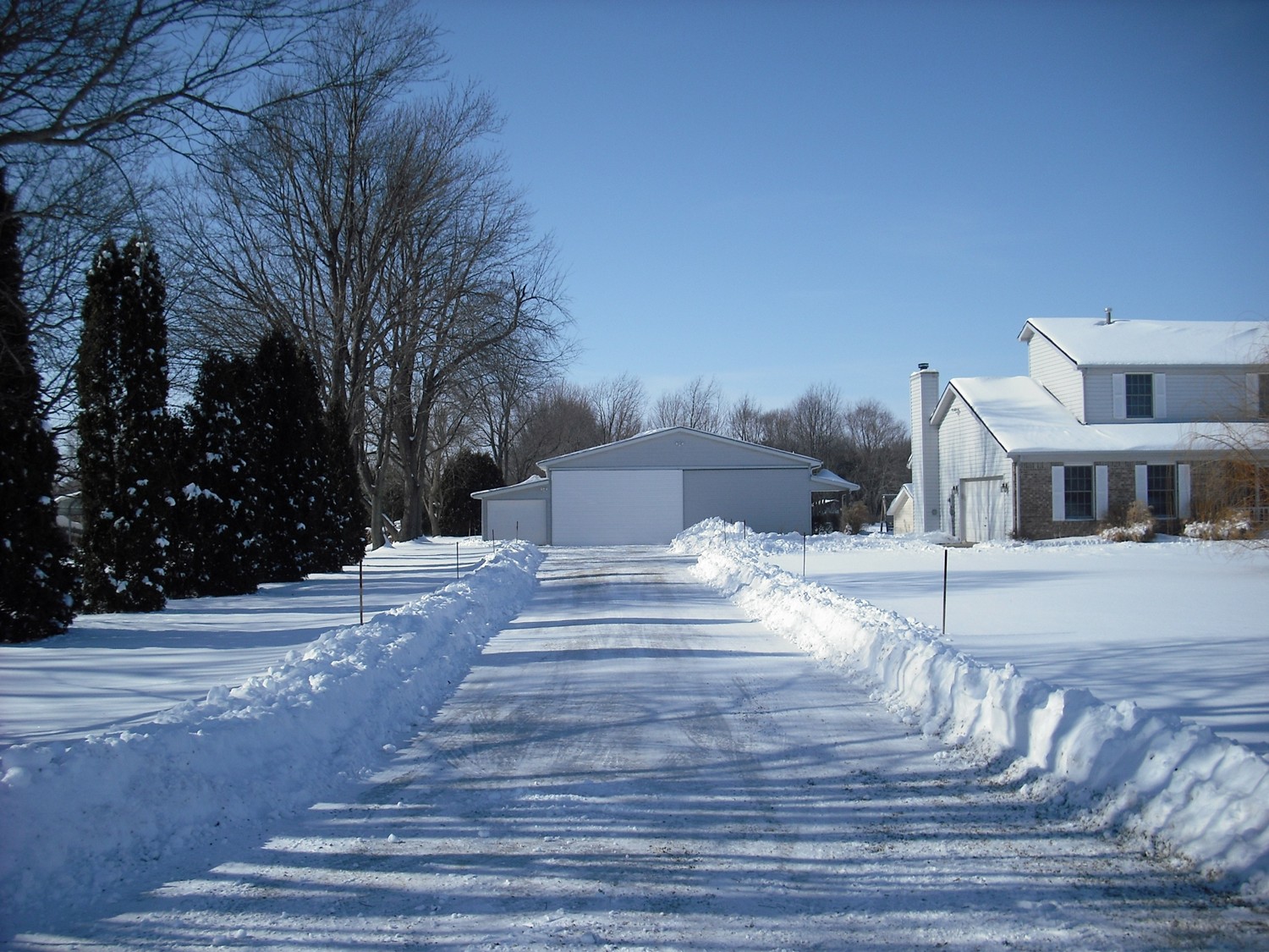

Here are some pics of my rig and the last 18" dump we got last winter. I have since had my drive paved. Its 280' long. Got tires of scraping up all the gravel. As for the blade doing damage I have a 40x20 and a 25x30 concrete apron in front of my two garages and have been plowing on them for 10 years with no issues.
