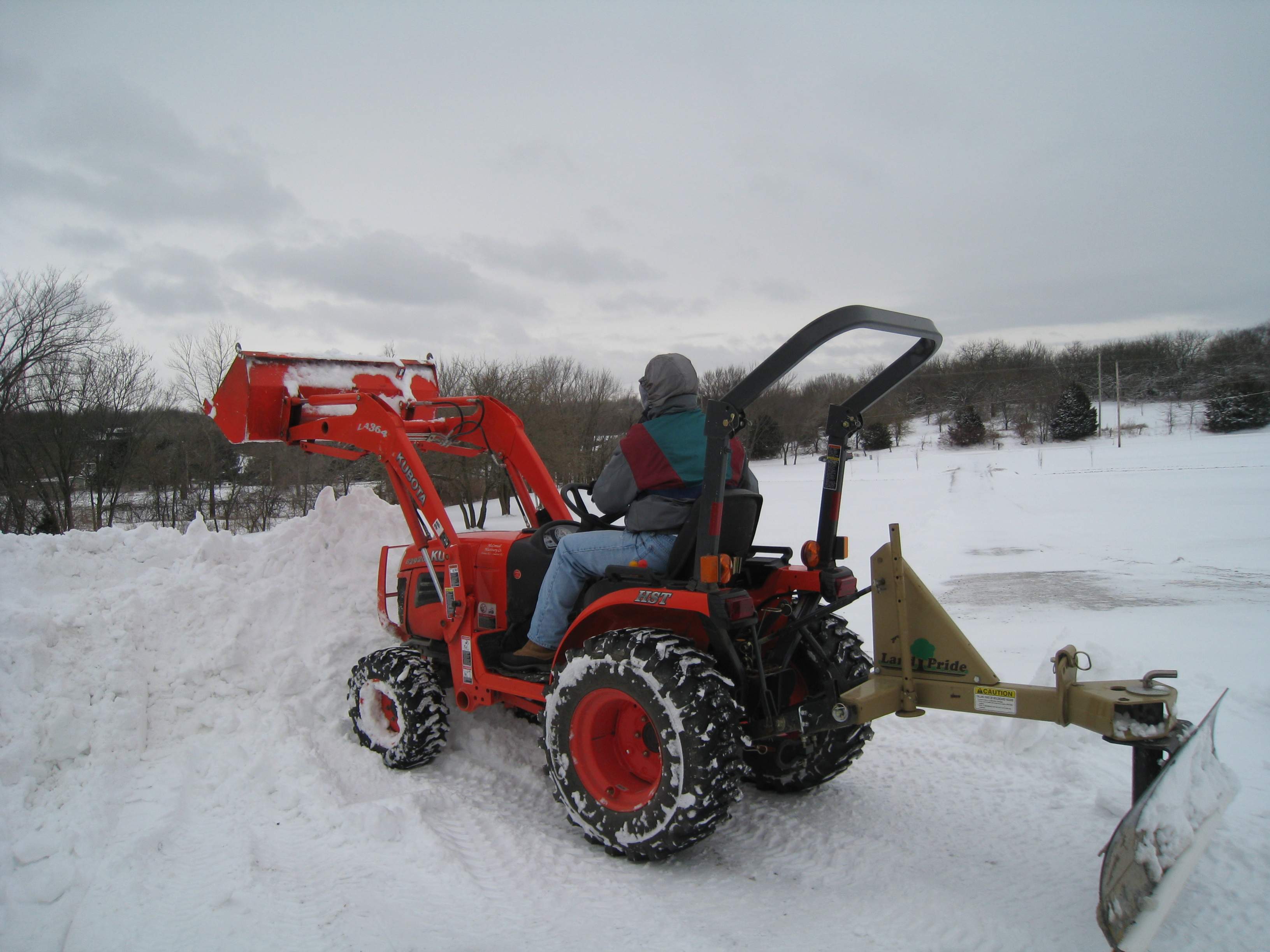

   / Rear Blade question #18
To give you a visual, this is my 5' blade on the back of my B2920. I was using the FEL to clean up a drift that was too much to push. But as you can see, lift the pin on the top and you can easily spin it or adjust it to any angle. There is still plenty of clearance for a 6' blade to clear the tires.
I have not posted any pictures before, so hopefully this works.
