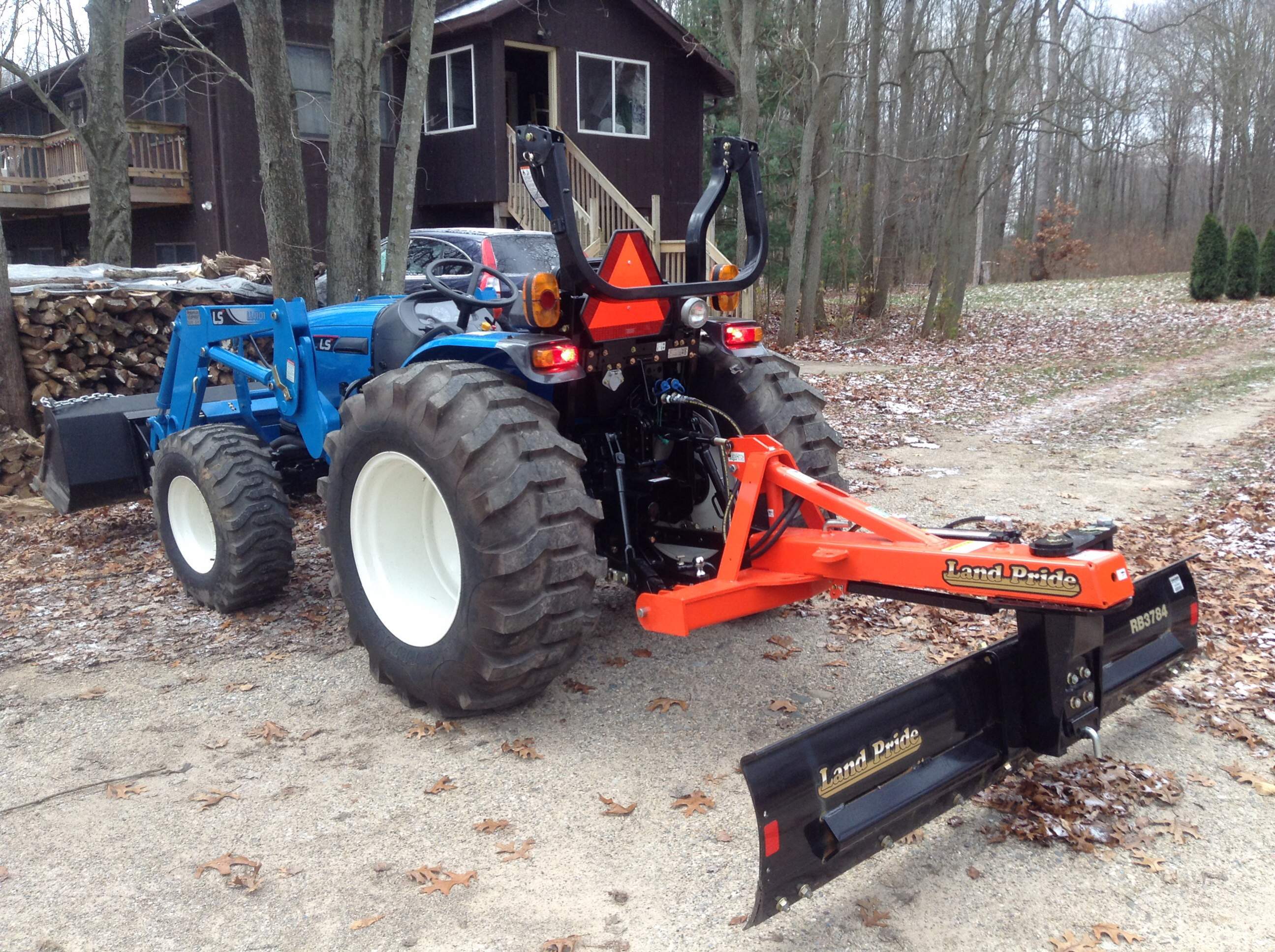

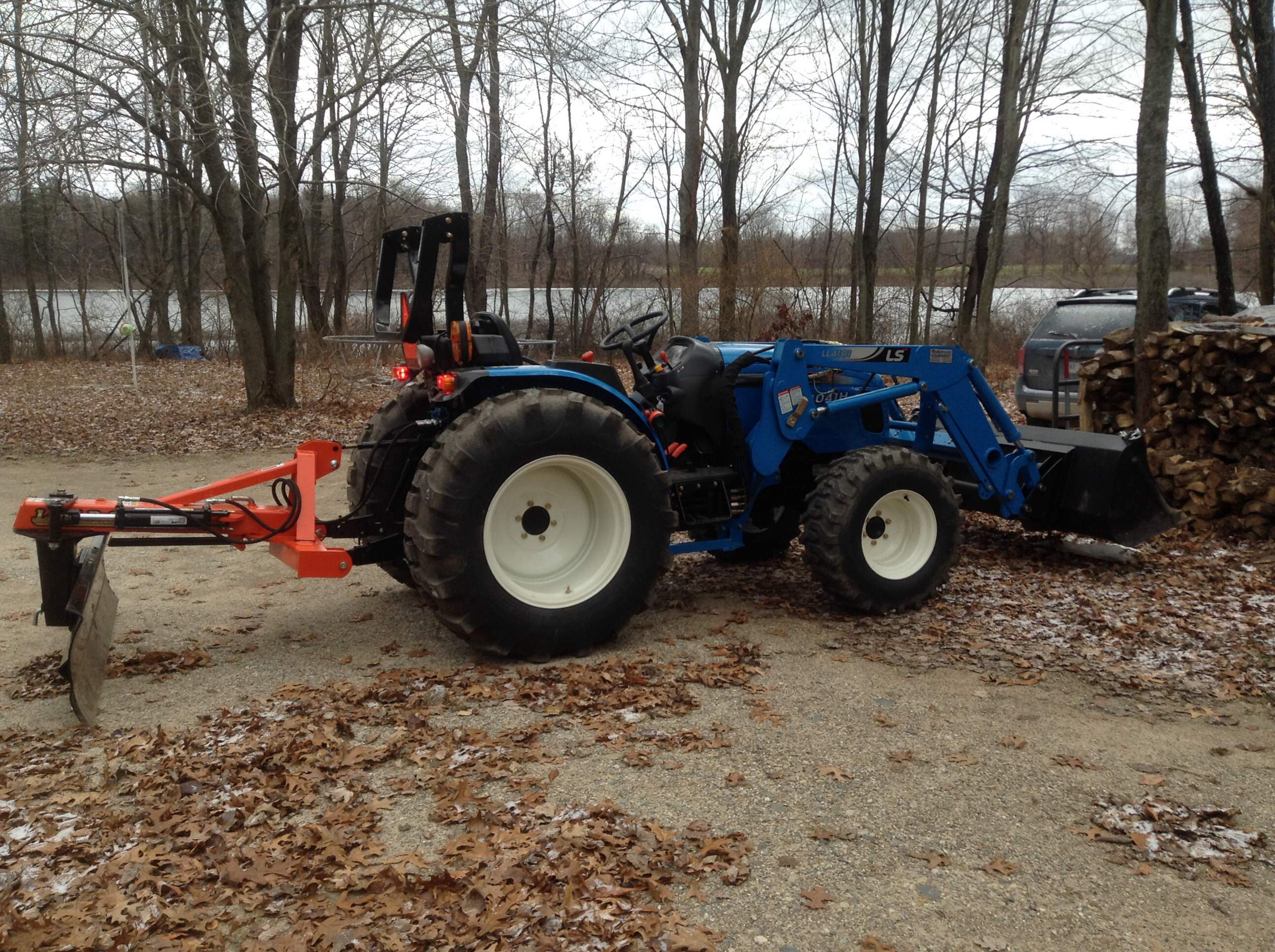

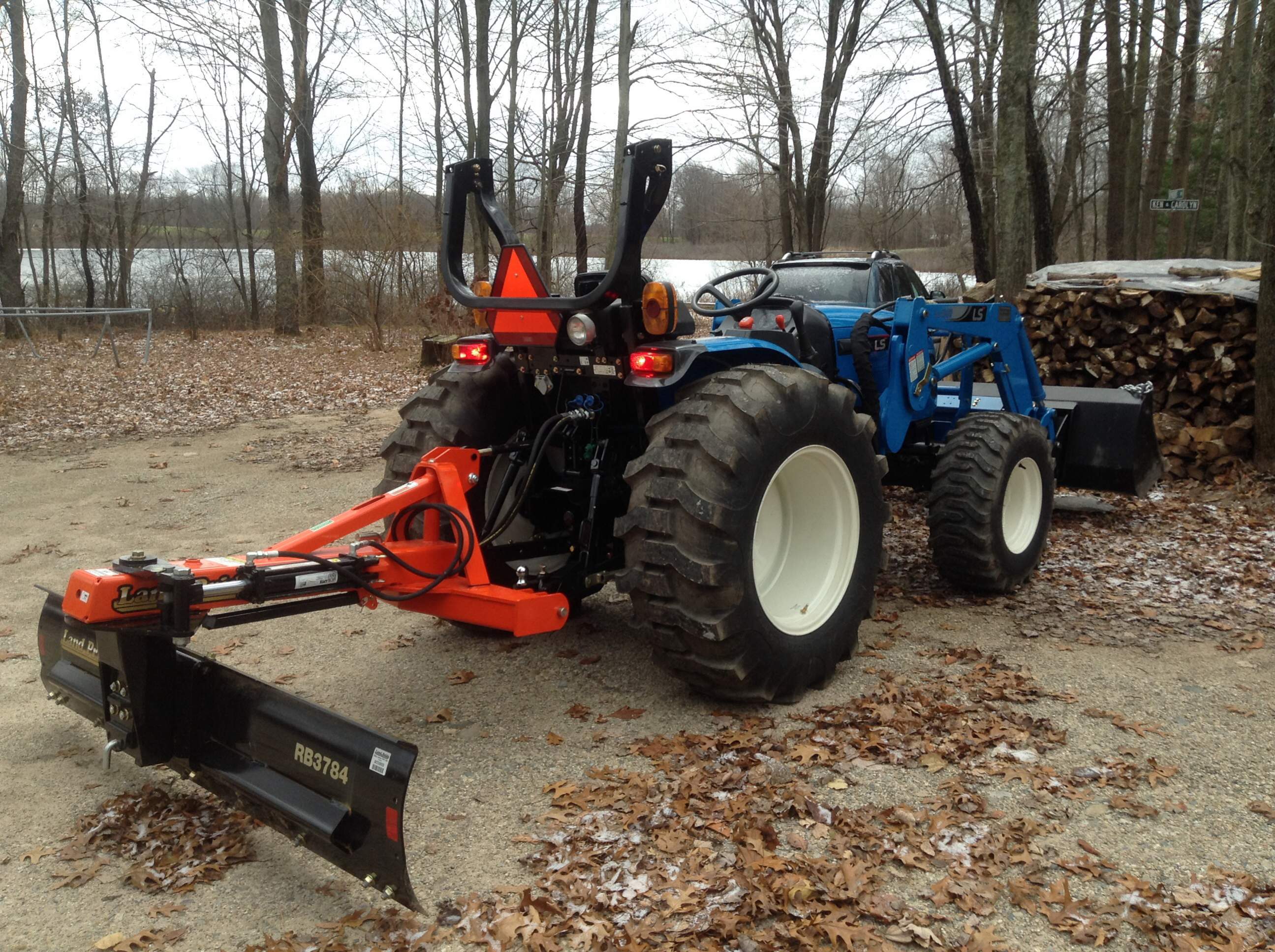

This is what I did about a year ago;
"Thanks for every one's input here, I really learned a lot. I bought a Land Pride RB3784 ($1330.) & Hydraulic Angle Kit ($275.) It is a 7' blade and weighs 630#, can't wait to plow some snow with my new Tractor & Blade."
