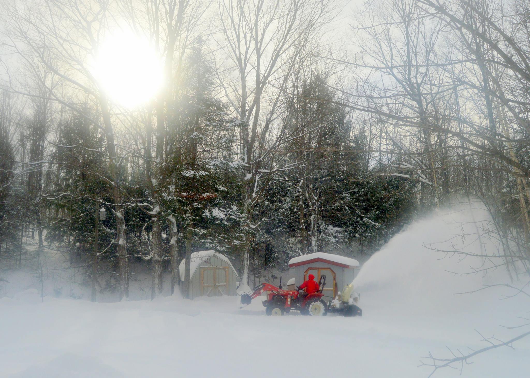

Sorry to muddy the waters, and I hope this doesn't come out like a manifesto... I live just on the edge of one of Lake Superiors lake effect bands so i get snow, lots of snow. I can count on getting pounded a few times a year with anywhere from one to three feet in as many days. I can also count on getting just an inch or so a day for literally weeks on end...(so annoying after awhile) So here is my evolution of snow removal for the past three/four years. Please bear in mind that in the many many hours i spend moving snow around you can count on me thinking of one of two things. One - what it would be like to be laying on a beach bathed in hot sun. Two - how can i make this process more efficient. Not to say that any of my ideas are good, but I they are well intended....
I used to blow snow with my John Deere lawnmower with a 48" snowblower attached on the front. I did a decent job but I drove that thing like it was stolen and i would frequently get stuck in the middle of my road waiting for one of my neighbors to come around the corner and side swipe me:eek:
So i bought a 2210D. For snow it came with an old, crappy, home made narrow snowblower, 6' back blade, box blade. Never even tried the box blade in the snow - tractor had stock Yanmar Ag tires. I had the makings of what I wanted, but as equipped it actually took longer to move the snow, and the results were not as clean. Blower was just next to useless, back bladeing worked, reverse/pushing proved tedious; pulling the back blade fair, but lots of post clean up. I was unable to blow or blade up the one big hill on my drive.
So first order of business was to buy a brand new 6' - 3 PT snowblower. Vast improvement over the old one, but i still couldn't blow up my hill, and unless I got 4" or more of snow the blower wasn't worth it...slow and scattered as much snow as it blew. So i would switch out the blower with the blade, or just use the bucket when snows were <4".
The next purchase were turf tires. I had them filled and was thrilled the first time i blew snow up my hill!!! :cool2:
My final snow removal implement is in the design and acquisition stage at this time. I have been looking at craigslist for months now trying to buy a 6-6.5' snowplow meant for a pickup truck. Once I pick one up I will take it to my local welder and have him fabricate the means to attach it to the front of my tractor in place of my bucket. I will also have him box in each side of the blade so that i can operate it like a scoop - at lease one of these 'box sides' will be removable so that I can also use it as a 'normal' snowplow.
With this final addition I will be able to move snow in two directions - push the snow forward with the blade - drop the snowblower and blow snow while I back up. When I get a small snow I will only use the blade and/or will make windrows of snow that I can then blow away with the blower...
THIS FUNCTIONALITY DOES NOT COME WITHOUT RISK!!! A plow on the FEL arms of a small tractor like mine can/will be subject to damaging lateral forces if and when you hit something solid on one side of the plow. If not careful I have no doubt that you can bend you loader frame. Having the blade boxed in and simply pushing forward un-angled will help some...
I plan on spending some extra $$ to have my bucket replaced/interchanged with the plow. But for you maybe you could do what others have done and have the snowplow attach to your bucket? I have seen many snowplows in my area that are selling for $100-$200, and welder said he could make an method to hook to my bucket for $200-250.
