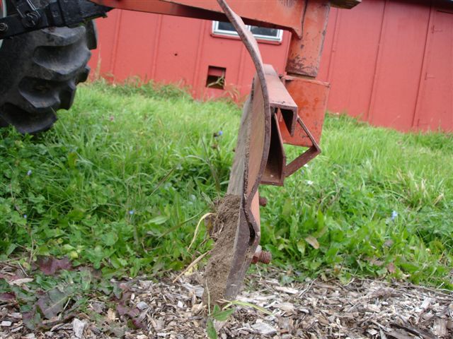

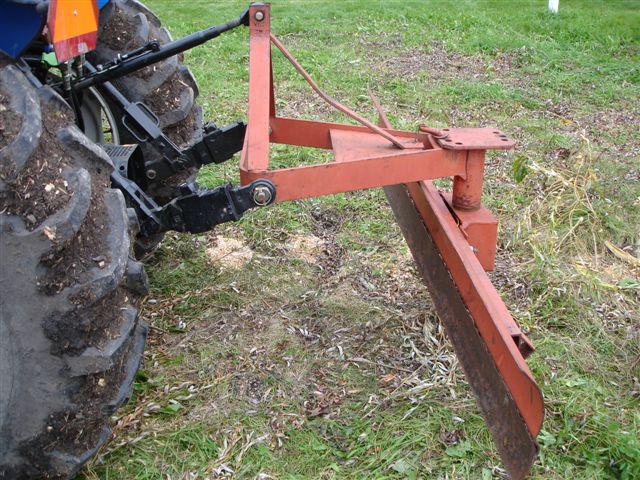

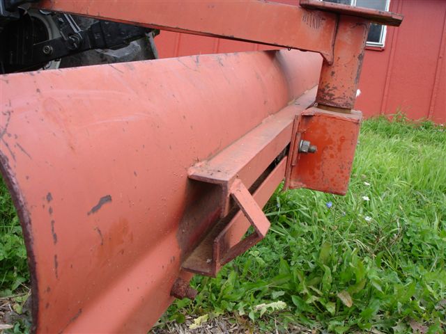

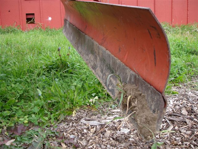

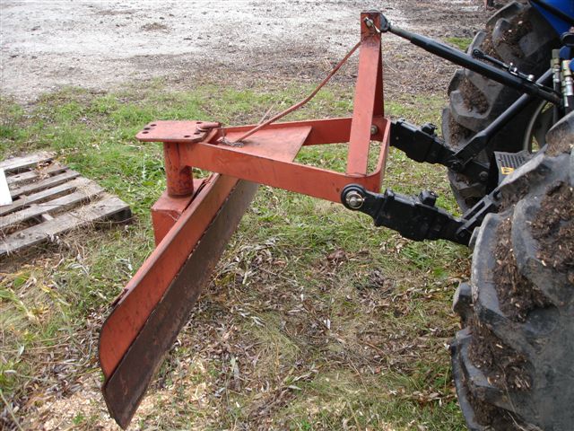

I got this rear blade that hooks onto my 3ph for free. I have no experience with any 3 ph blade. Can you tell me what I can do with this thing?

Bob, be very carefull with that blade. It is waaaay to small for your TN70. Your tractor will bend that up before you can count to 2 .:rolleyes:

I use mine to remove snow, driving forward. The rear wheels don't pack it too hard. Run it straight down the middle. Then angle it using those holes to do the sides. Actually, I can usually just do both sides, and the side-dos do the middle as well.
Neighbor has one, too. He angles it down and uses it to pull his gravel back onto his roadway. You angle it by using adjusting your adjustable 3ph arm. You can poke it more out to the side by loosening those bolts at the back and sliding it over and retighten the bolts on yours.
The back blade is better for rooting out a roadway on a slope than the FEL because you can angle it by adjusting the 3ph arm.

Yes, I think it is way to light for a TN70:D . As I dragged it around for a little while, it would bend (at least I think I saw it bending :rolleyes: ) whenever I engaged some dirt. By the time I see it breaking, it will be too late. But I have to use it for something.
I am having 20 tons of 3/4 traffic bond delivered for my driveway (touch up). Do you think it would be up to that job? I really don't want to break it.
