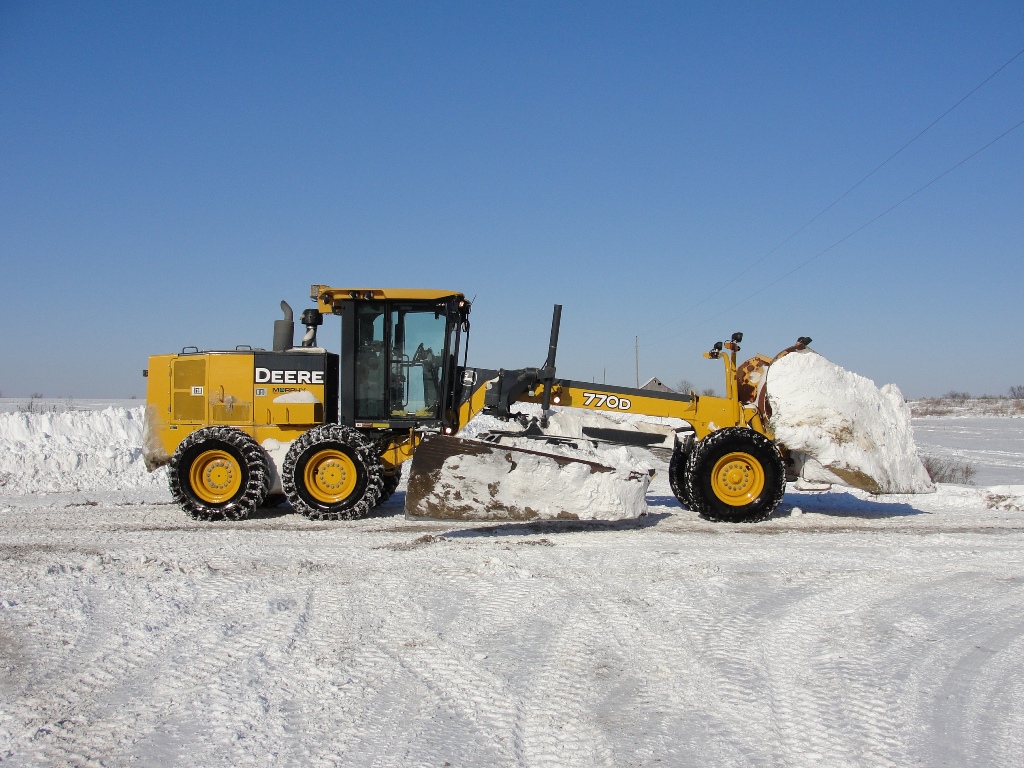

I've ran a road grader for 30 years. I've never used a tensioner. I've never lost a chain. The lateral stresses on these chains are greater than anything you can do on a tractor.
