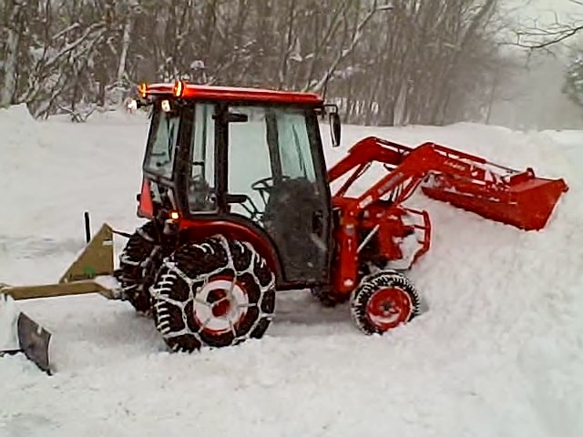

I used tirechain.com; they are good people. You will only need one tenioner per tire. They will advise you of this. If you plan to run chains all winter, then just buy em for the rear tires. If you only need em to get out out a jam, the fronts are the way to go. Simply raise the front tires with the bucket, then put the chains on. Some say you can snap an axle with chains. As your rear axle has more meat, that's the one I would chain. Show you my chains in use.
I forgot to say: "In the land of snow, the man with chains is king!"
