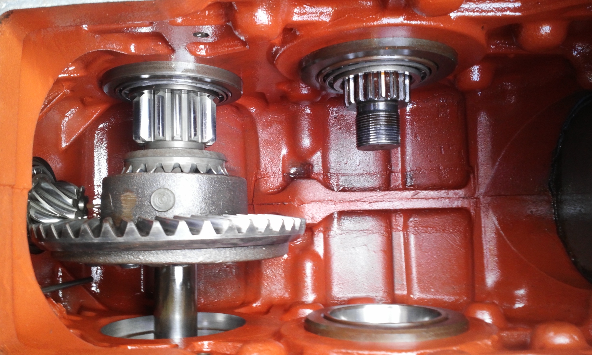

ok I ordered part # 12…and a new set of #15 the shims…mine are all knarley….I already started spraying the final drives with brake clean and getting them all clean…I was thinking of doing the same thing in the differential…just keep moving and spraying and clean up the bottom of the housing with rags…I'll have to work on that bolt though. Thanks again…pics to follow

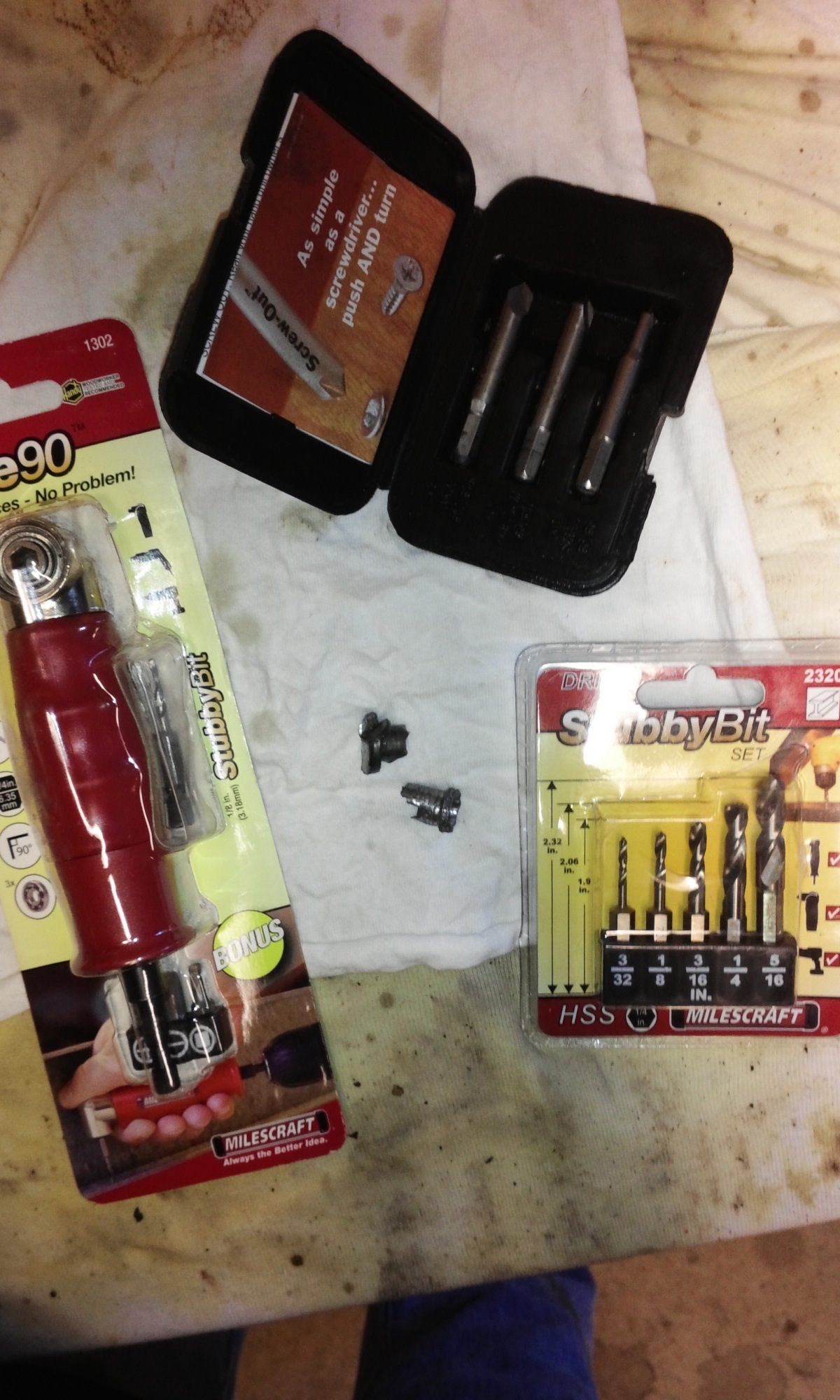

Went to Sears (I hate Sears) Got this little 90 gizmo drilled it a bit, and used my easy out set, and the broken bolt eventually came out. I was looking for an adapter that I could have put on my 3/8/ air ratchet, but this is all they had. Worked really well. Bits were awesome. I thought it was going to be crap and been returned within an hour, but she's a keeper.

Bathed in Diesel…Waiting for parts…Will clean with brake clean prior to reassembly…Im going to call the case dealer to see if I can get that bolt…The parts book does not show it as a separate item...

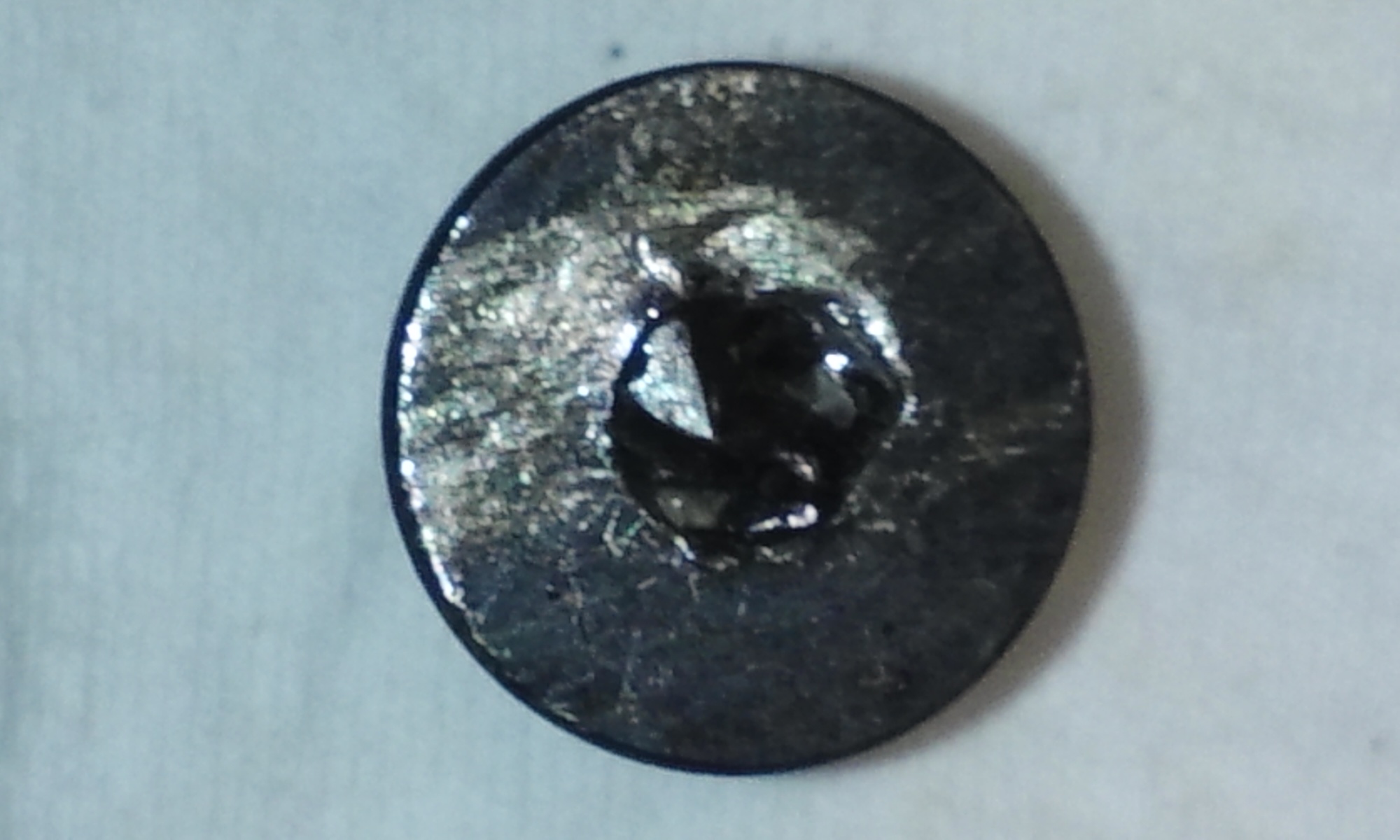

ok now I'm a little concerned…Again I'm no mechanic, so I do not know the severity of any of this. I could do what you said and maybe go to a performance shop and have one of those bolts made… I was going to leave it out…lol…there are 15 other ones in there …anyway…I can do that…here is the real problem…

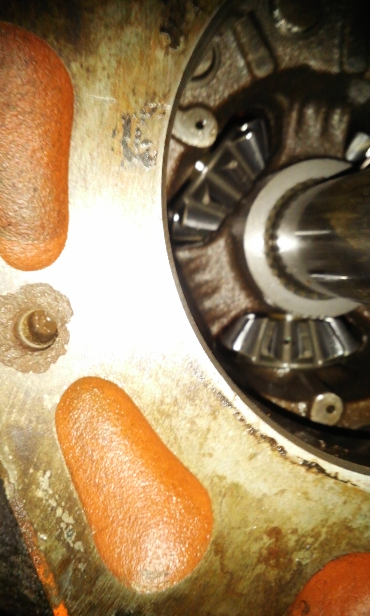

The set screw that you talk about for the carrier plate…was changed out to an allen head at one time…. I could not get that bugger loose….I actually snapped an allen wrench inside while trying to remove….(the least of my problems now)…I figured this was just a set screw to aid in reassembly…While removing the carrier plate (using some force)… the bolt actually broke away with a pice of the casting…fell right on the ground…there is no way thats going back in….unless I fill it with something and re-tap it… i'll try and take some pics

Good news is... the bolt still threads into the casting. I should be able to find that bolt pretty much anywhere. I may have one at work. I'm not sure if I should fix the casting, or just blob some silicone in there before re-assembly to make up the void... Just thought of something... I will need a bolt threw or four threads longer now...

Wow, betting someone read the torque specs wrong on that screw, and went 12-15 ft. labs, instead of in. lbs. I couldn't remember if the holes were tapped clear through the case or not. None the less, a 1" X 3/8" hex head screw should be fairly common item.
Was thinking too... Did it appear to damage the diff. lock mechanism..?? I cant really recall on the Case, but pretty sure on the Massey 180, it was made from cast aluminum/pot metal material.
