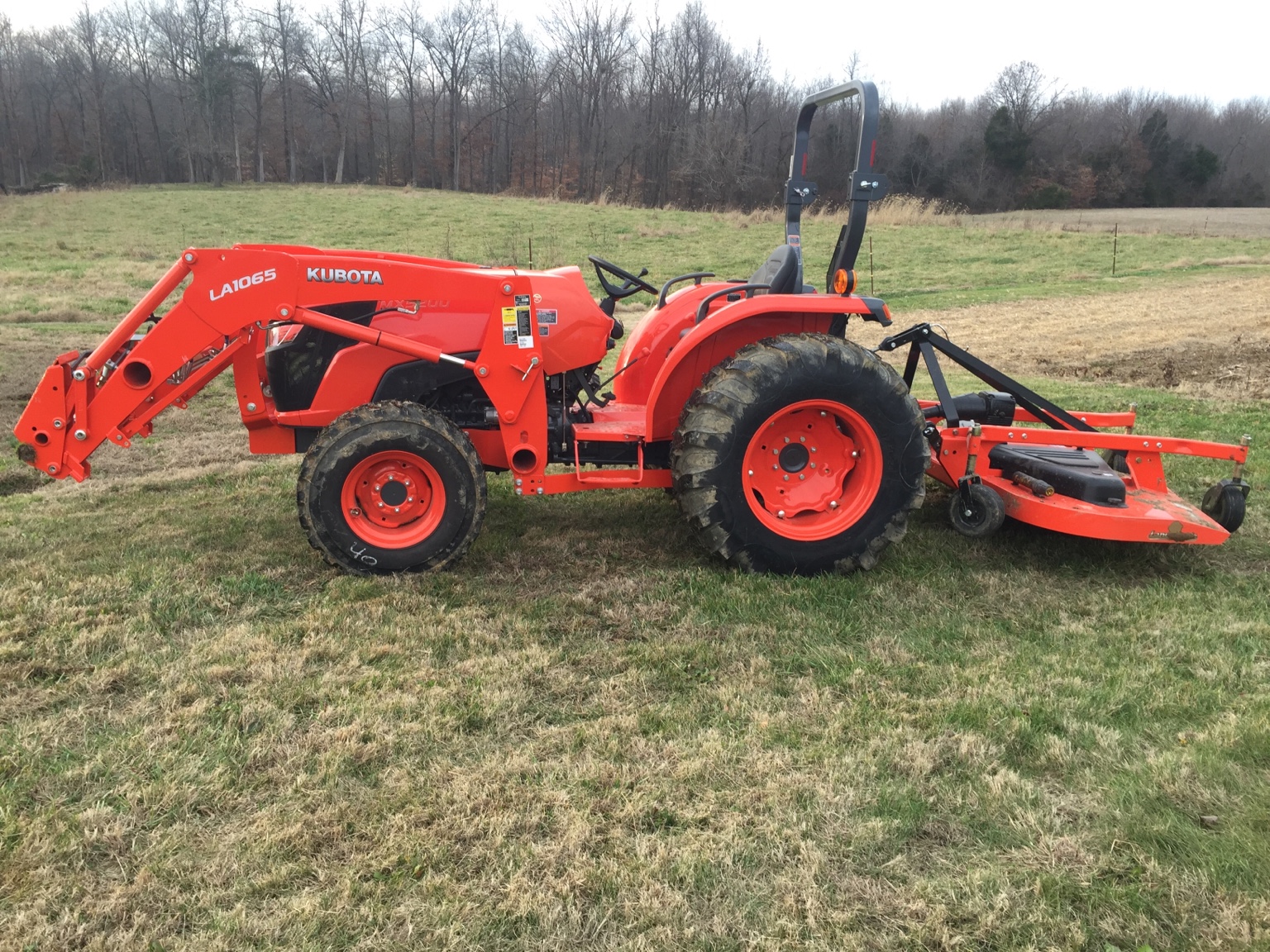

I have an 84"Land Pride on a MX5200 Kubota. Really like it as it greatly speeds up mowing over the 60" Dixie Chopper. I use the tractor for the large open areas then go get the ZTR and now around obstacles and the house where things are too tight for the tractor. ImageUploadedByTractorByNet1459515291.391448.jpg
