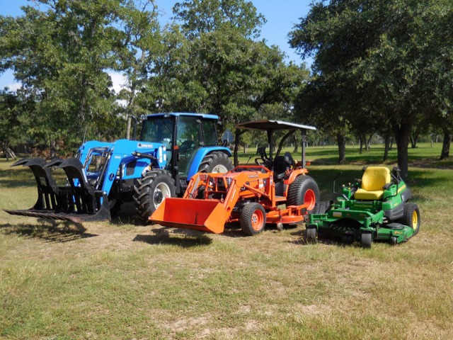

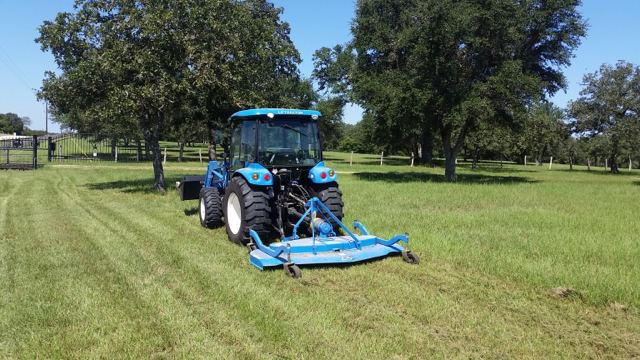

I have an LS XR4046HC and an LS 84" rear finish mower. It replaced a Kubota B2710 with a 72" MMM. Both cut our yard (almost 10 acres) very well. I still use my John Deere Z820 zero turn under trees with low limbs.

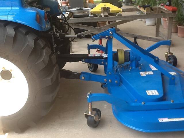

The mowing zone of my 84" RFM extends 45" behind 3-point links while mowing zone of my 6' Woods rotary cutter is 75" from links. You really can't get much mowing, under low tree branches with a RFM or a RV for that matter. That's why I cut under trees with my zero turn.

My LS 84" RFM floats front back and side to side within the limits of the floating hitches.
