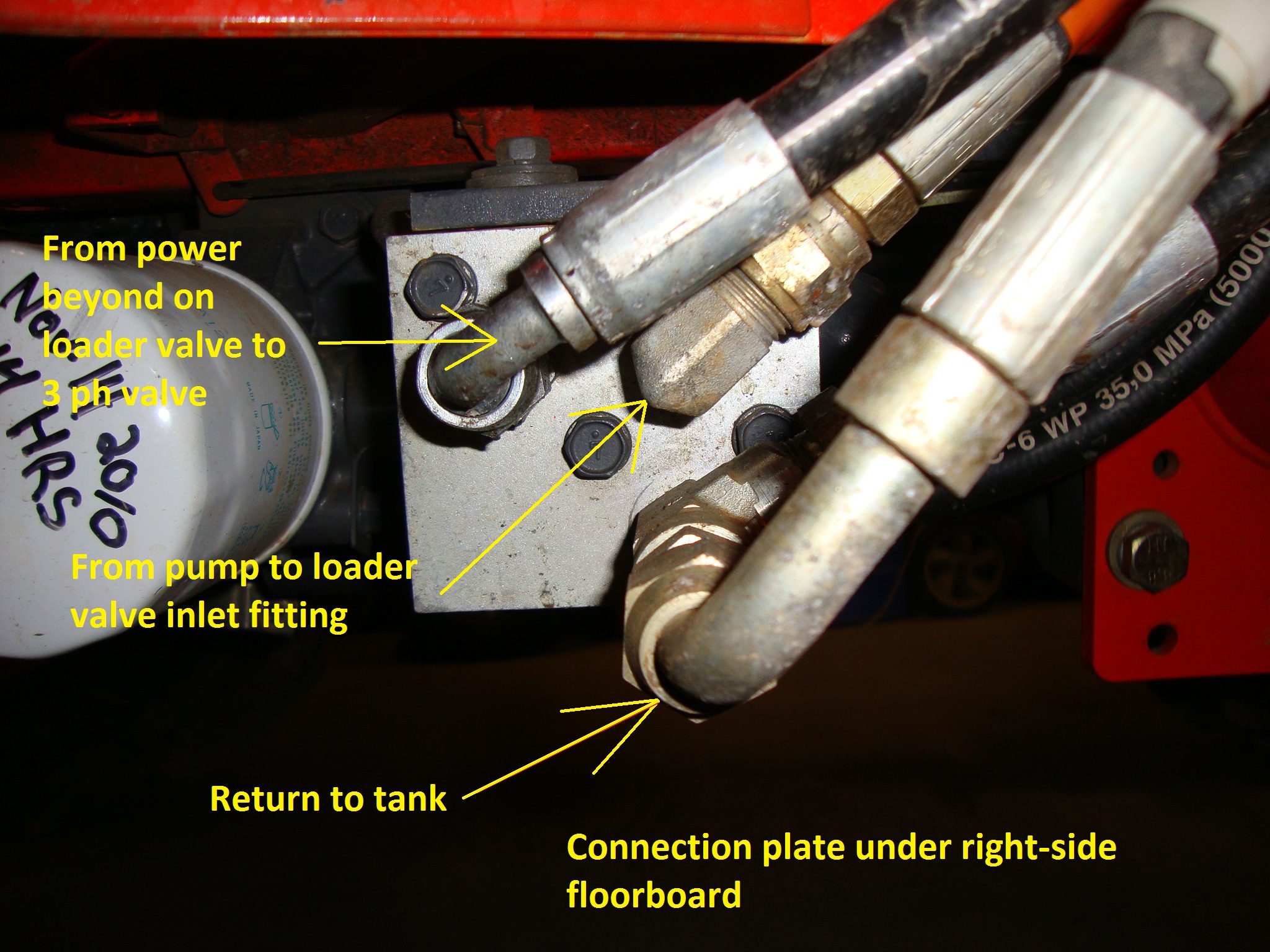

   / Rear Hydraulics on a 2816 Mahindra #10
With the BH installed, you don't need the 3pt.The line going too the 3pt will now become the input line for the BH. Since the BH return port is not designed for high pressure, you want to run the BH return to a return line or directly to tank.
Next, you should install a short hose for the 3pt with a female QD on it.
Then install a male QD on the PB line.
So, when using the 3pt and no BH, you plug the two tractor QD together and that completes the hyd circuit for the 3pt..
When you want to use the BH, just unplug the QD's and plug in the BH QD to the PB QD..
Picture below is a Kubota hyd blk.
I am not sure what your blk looks like, but the principle is the same. The hyd blk is a routing device.
