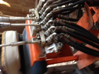

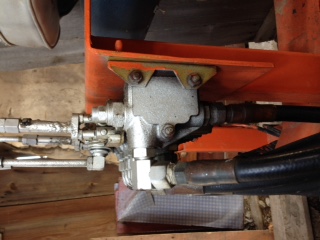

In the right picture, there is a port on the end plate that is plugged, but can not tell if it is PB.
A PB port will either have a small threaded hole for a hex screw or have an open for a PB adapter that will separate the galleries so the PB can exit the valve for downstream operations.
Are there any markings on that port?
   / Rear Hydraulics on a 2816 Mahindra #22

J.J.
The valve has a port on that end that has a hex plug in it. If that (which it appears to be the PB port) are parts available to make it a PB port?
Is the PB sleeve the same for this valve as others?

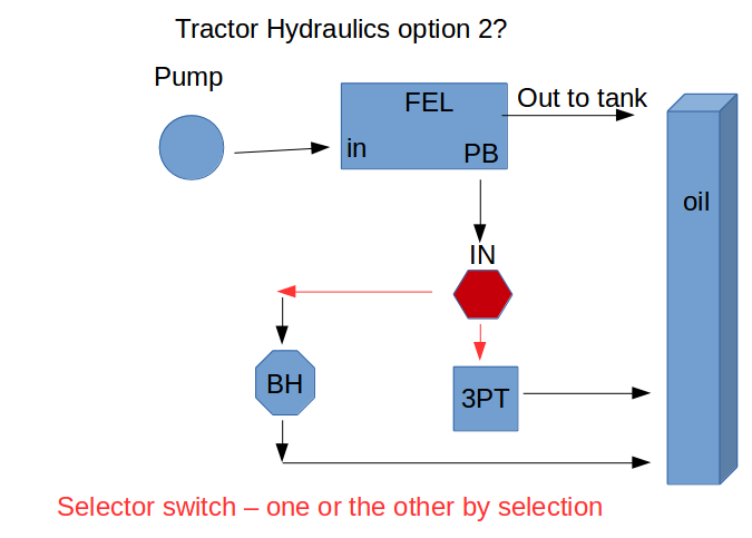

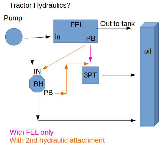

Hydraulics 2.pngAm i thinking correctly??
Hydraulics.png option 2?
   / Rear Hydraulics on a 2816 Mahindra #26
Both diagrams look correct.
#27
Thanks J.J.
I will review that BH valve closer when i get a chance. I hope i can find the PB parts for it.

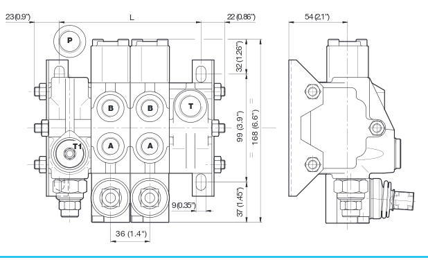

Yes i understand that now. I would rather have all the hydraulics working if i can make it happen. I think the valve could be a Dinoil DN35
https://sklep.dzwigi.net.pl/upload/pdf/Katalog Dinoil.pdf

If iam looking at this correctly the BH has the return in T1 which is PB i think. It has some sort of adapter in T1 with the hose. Is it possible that the H is setup for PB and missing the tank return hose at T?
