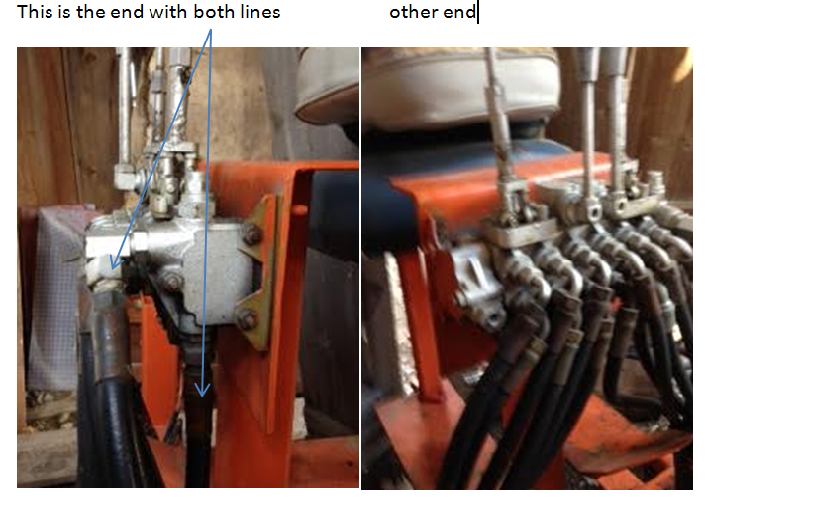

The BH is a 3 pt mount without a pto pump. I will need my 3pt. I may need to see if the valve on the BH can be converted to PB? or some other option?
   / Rear Hydraulics on a 2816 Mahindra #12
Look at the BH valve and see if there is a PB port.
If not, there are other options.
Here is one. 1/2" NPT 20 GPM PRINCE SELECTOR VALVE
If you run the PB line into this valve, you can select either 3pt or BH. Use the 3pt to lift and set the BH, then shift to the BH and use it.
You could do this using a solenoid valve for more money.

J.J.,
OK i think i may be catching on.
IF we can't convert the BH valve to PB
remove PB hose from block run to input of selector valve then run one port back to block PB port, one port to BH IN port.
BH out goes to tank and use either the 3 pt or the BH by switching the new selector valve.
Is this correct?
   / Rear Hydraulics on a 2816 Mahindra #14
Yes, that appears correct.

Here is the valve - It is a Dinoil valve, looks older, any idea if it can be changed to PB?
   / Rear Hydraulics on a 2816 Mahindra #17
Can't see the Output end.
That is where the PB normally would be in most valves.
#18
J.J.
Here is a pic of the end with both inlet and outlet hoses. Is it possible to make it PB?
Thanks Again!
   / Rear Hydraulics on a 2816 Mahindra #19
The PB would not be on the end that the input is on.
Can you show a pic of the other end?
#20
Here is both ends - hope this helps
