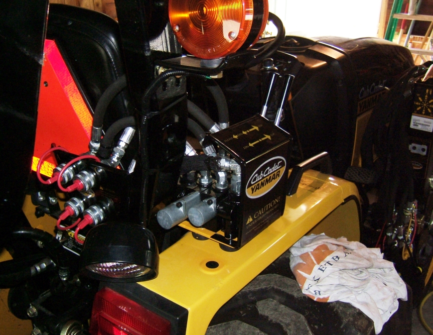

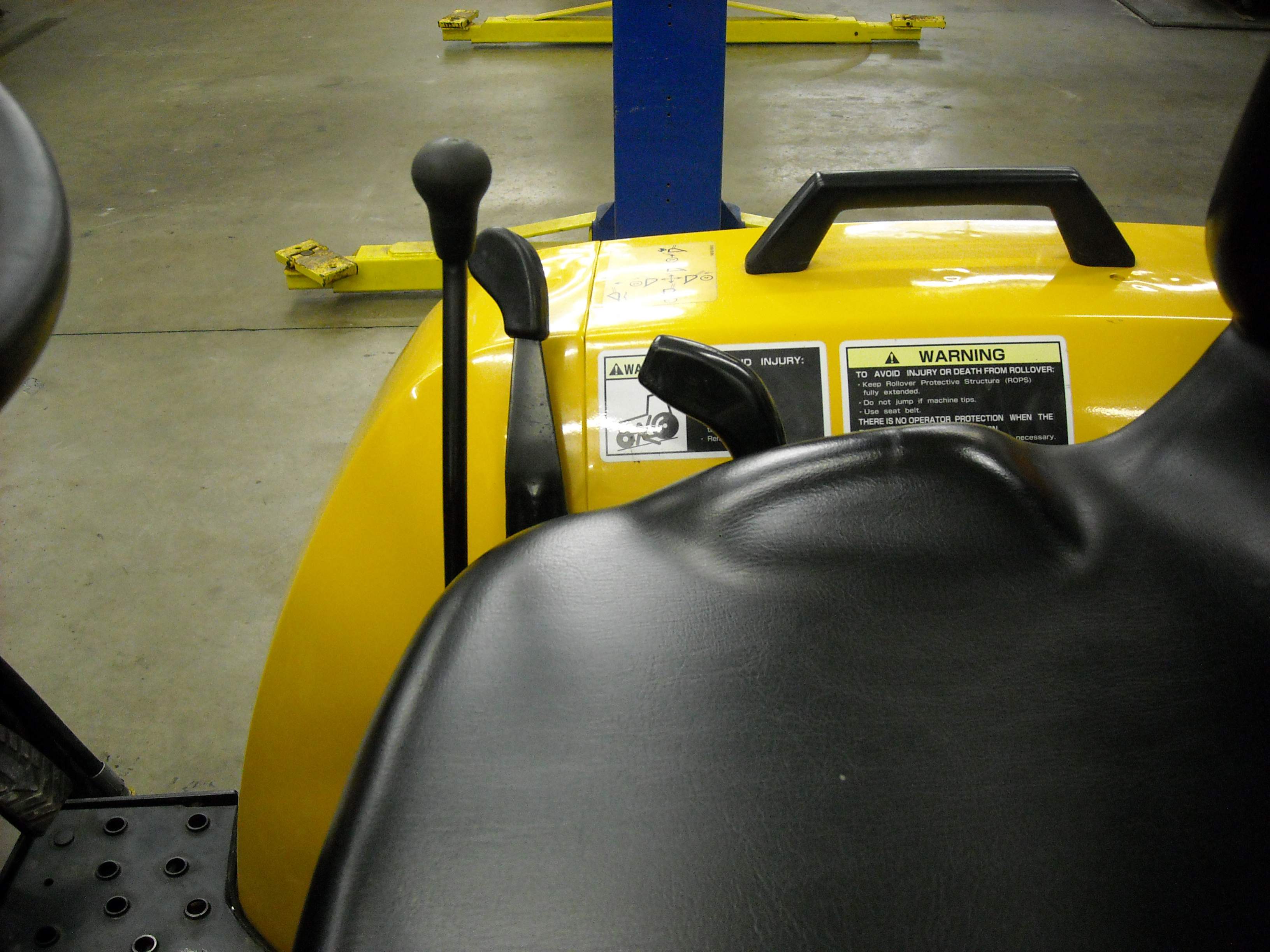

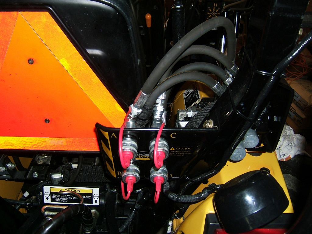

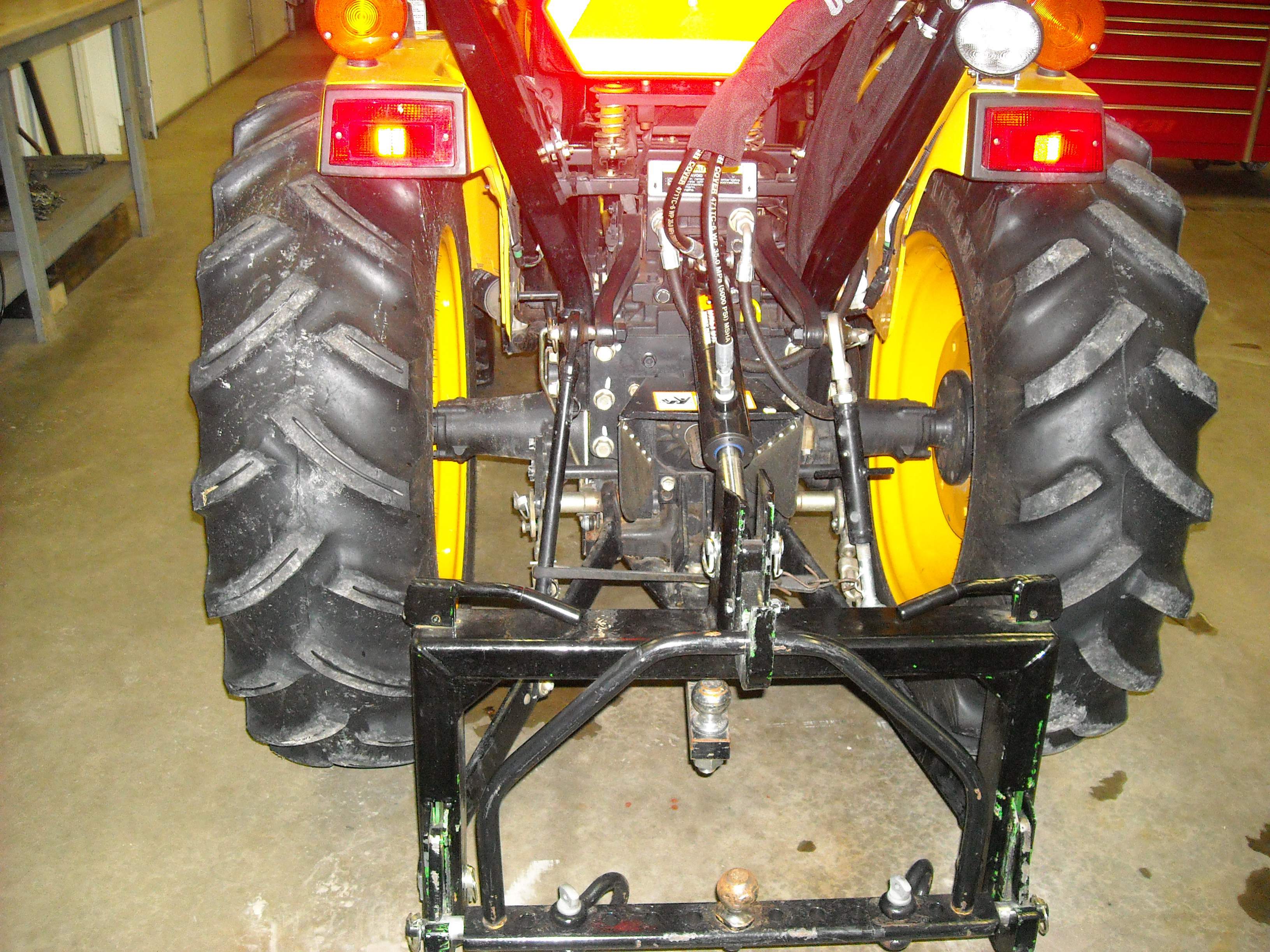

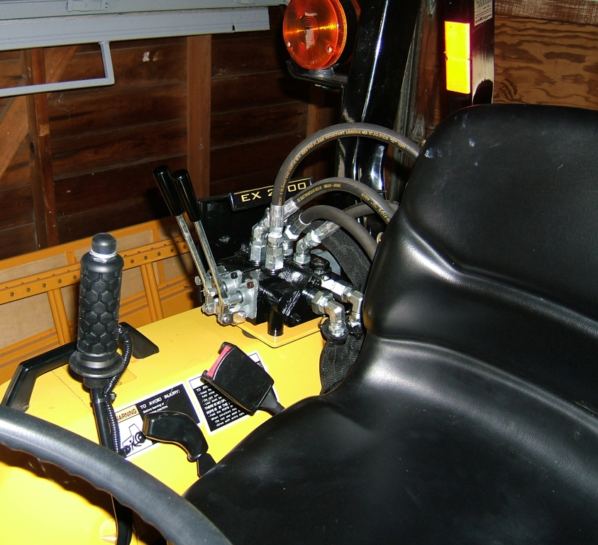

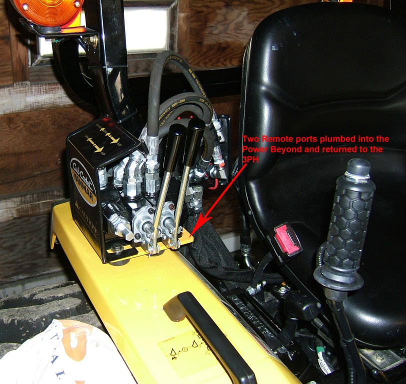

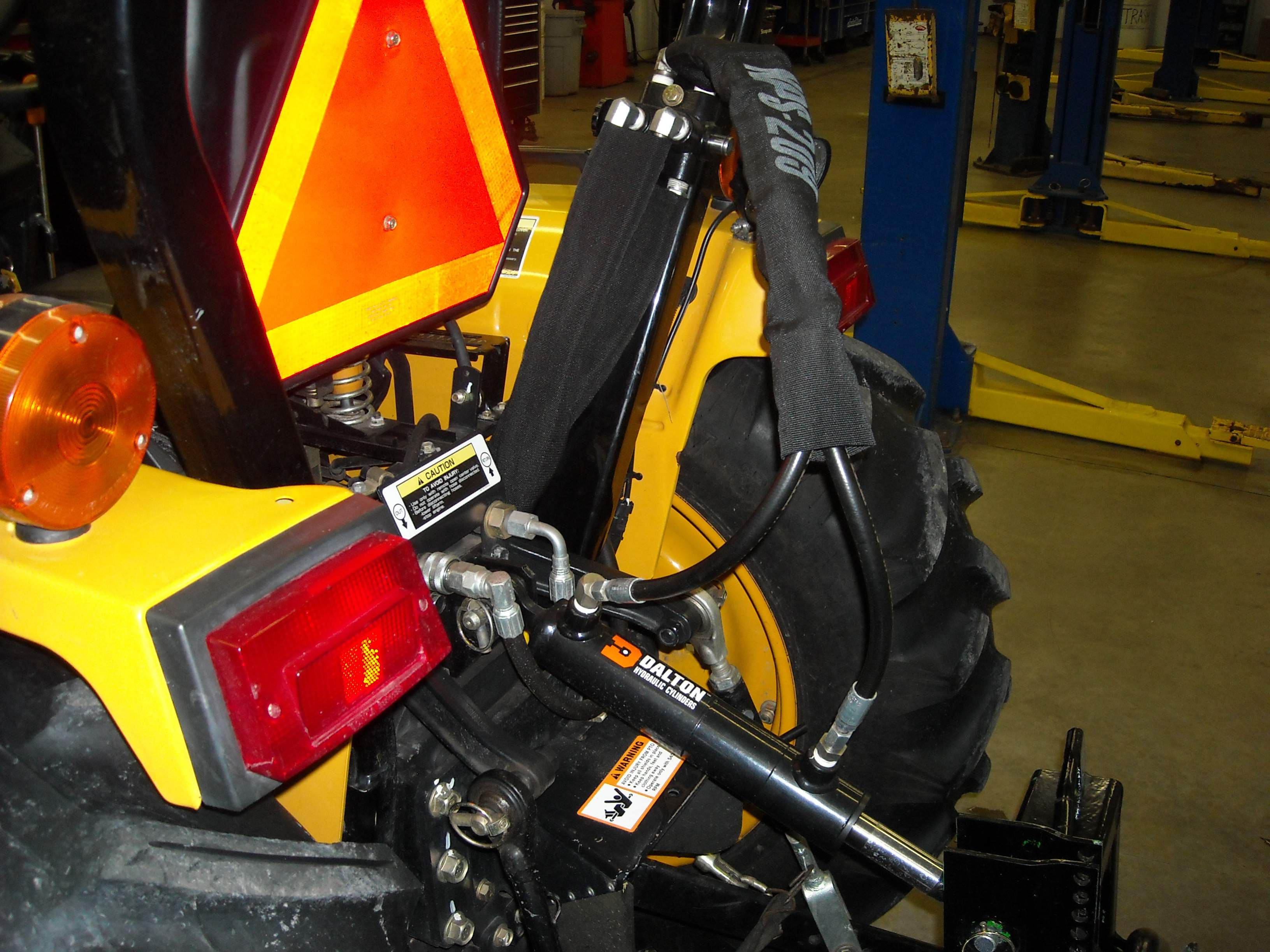

I installed a setup on my EX2900 a few years ago, LowNSlow. As far as price goes I agree with J_J depends on what you want, could be anywhere from $500 thru way past $1000. On my set up I purchased the factory Power Beyond setup (not necessary, but didn't know at the time) and then some very pricey Prince SV 2 spool DA stack valves (not necessary either and found out later overkill). All in all my setup cost me with the PwByd Kit right around $900 to $1000 to complete. As far as difficulty it depends on if your fairly mechanical and don't mind reading this forum, you should be good to do it yourself, honestly without this forum and people like J_J my project would have never happened!! Below are some Pic's of my setup!!

View attachment 372670View attachment 372671View attachment 372672View attachment 372673View attachment 372674
Can you please take some pics under your seat to help us better understand how you got the PYB and returned? I would really like to see the connections to the trans/pump and what not.
   / Rear hydraulics on EX3200 #10
Still would like to see where the power beyond kit hooks up.
