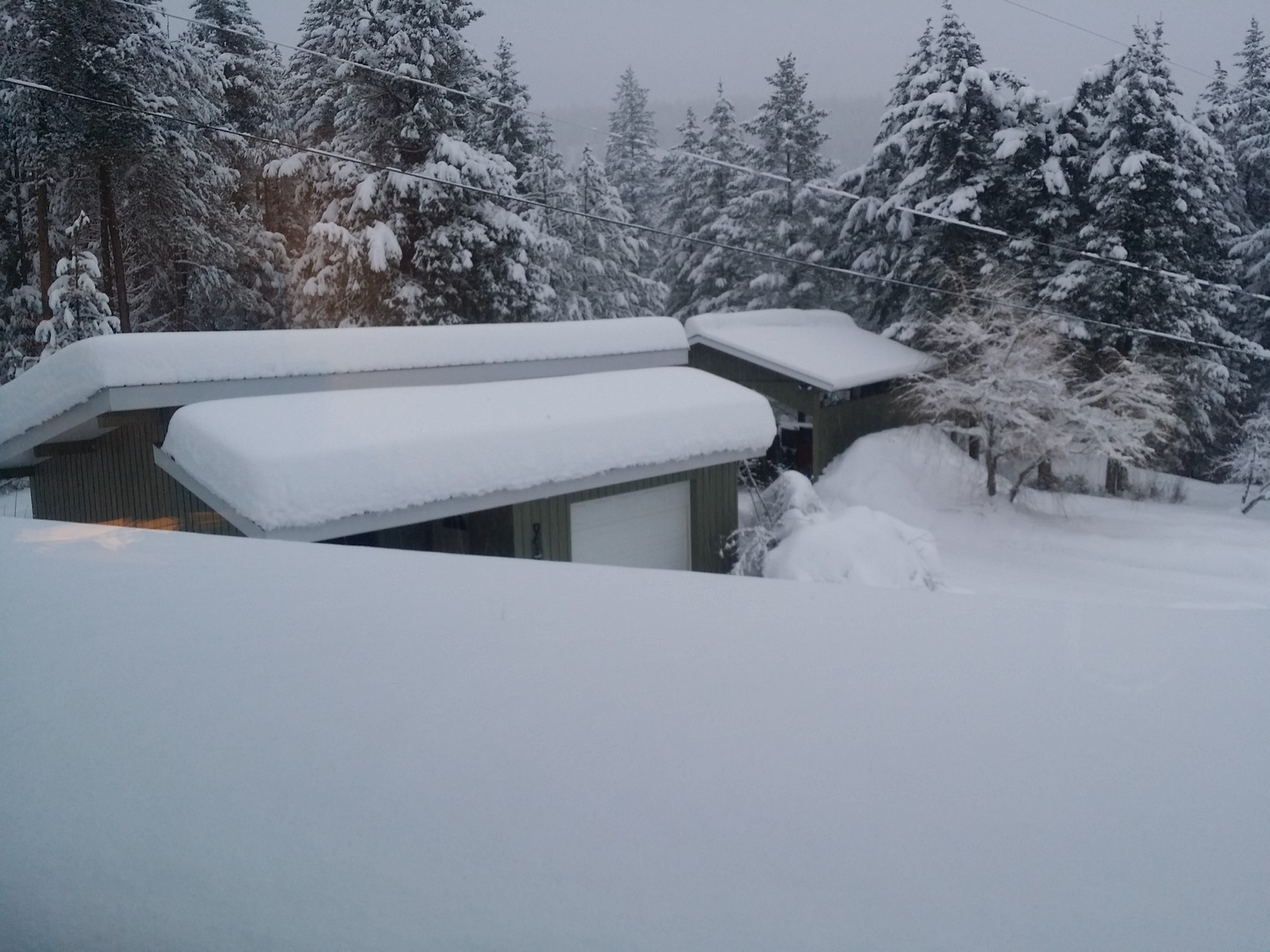

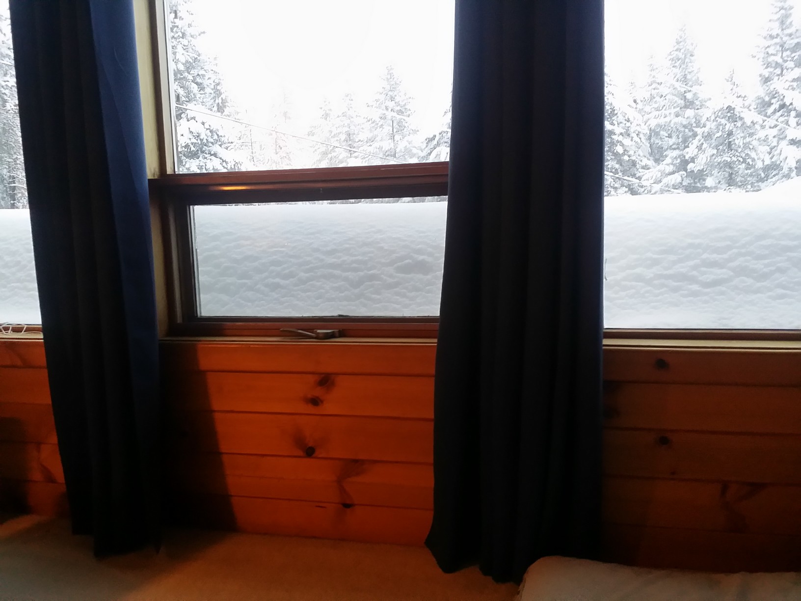

As stated before, for most snows of around 8" the speed with my 28 PTO hp tractor is a very fast walking pace or more. I really don't want to go quicker than that, even if I can. What slows me down are uphill sections. I think that is due to the HST requiring more of the power. But going downhill I can motor right along. The odd times(like lately) when blowing 12" of cement I do have to use low range and still manage a normal walking pace even uphill.
It snowed all night again and is forecast to snow all day. This evening it is to warm up and rain. So I guess the best plan is to head out after noon and get the snow out of the way. After the rain cooler weather and more snow is forecast so that will be fine. It is the wet snow that is not as much fun.
Here are a couple of photos of this morning from my upstairs window:
View attachment 635935 View attachment 635936
