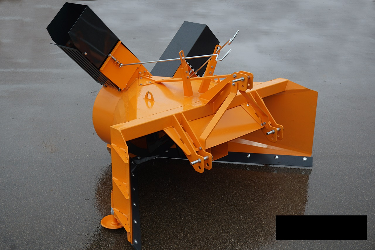

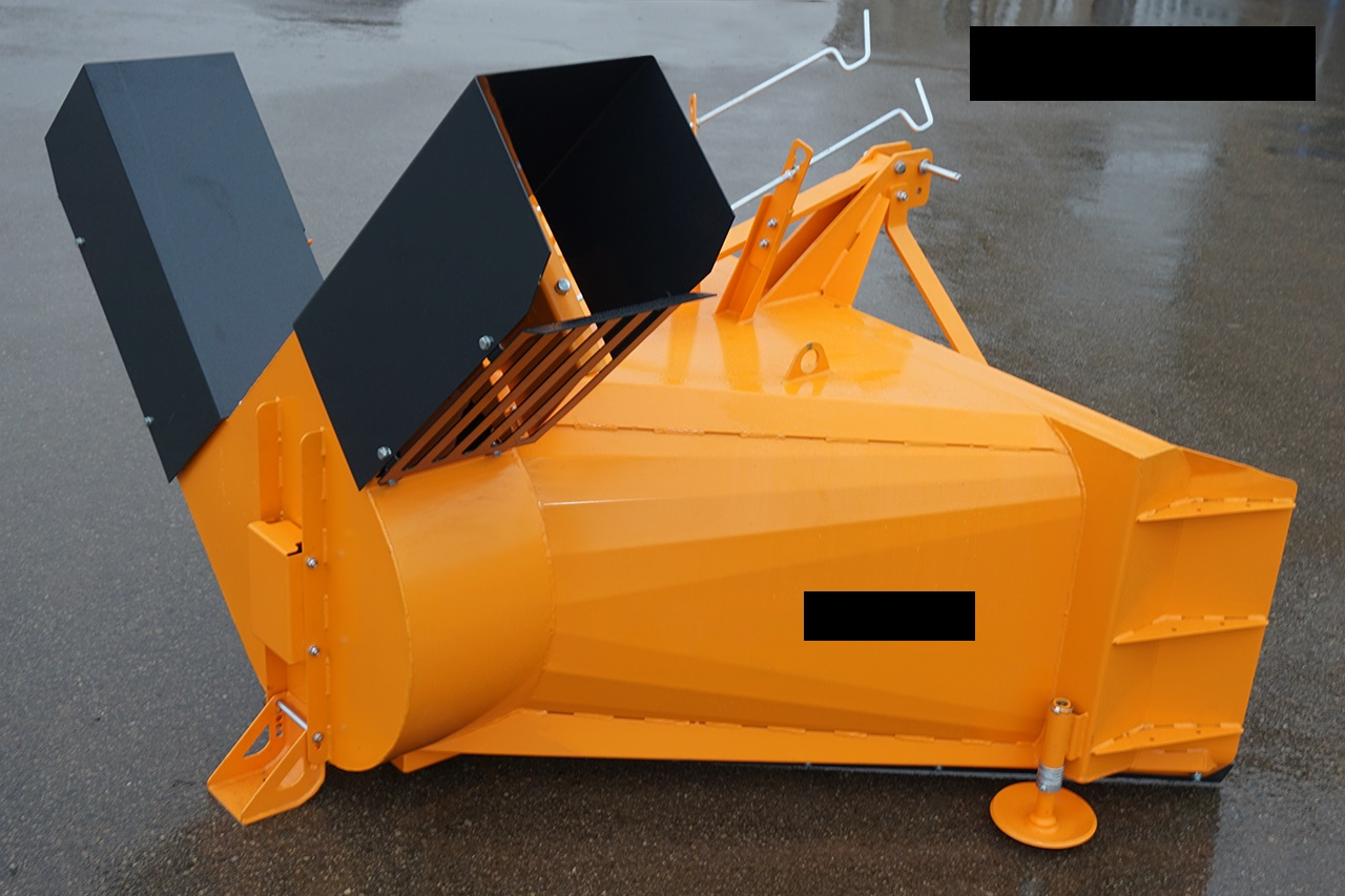

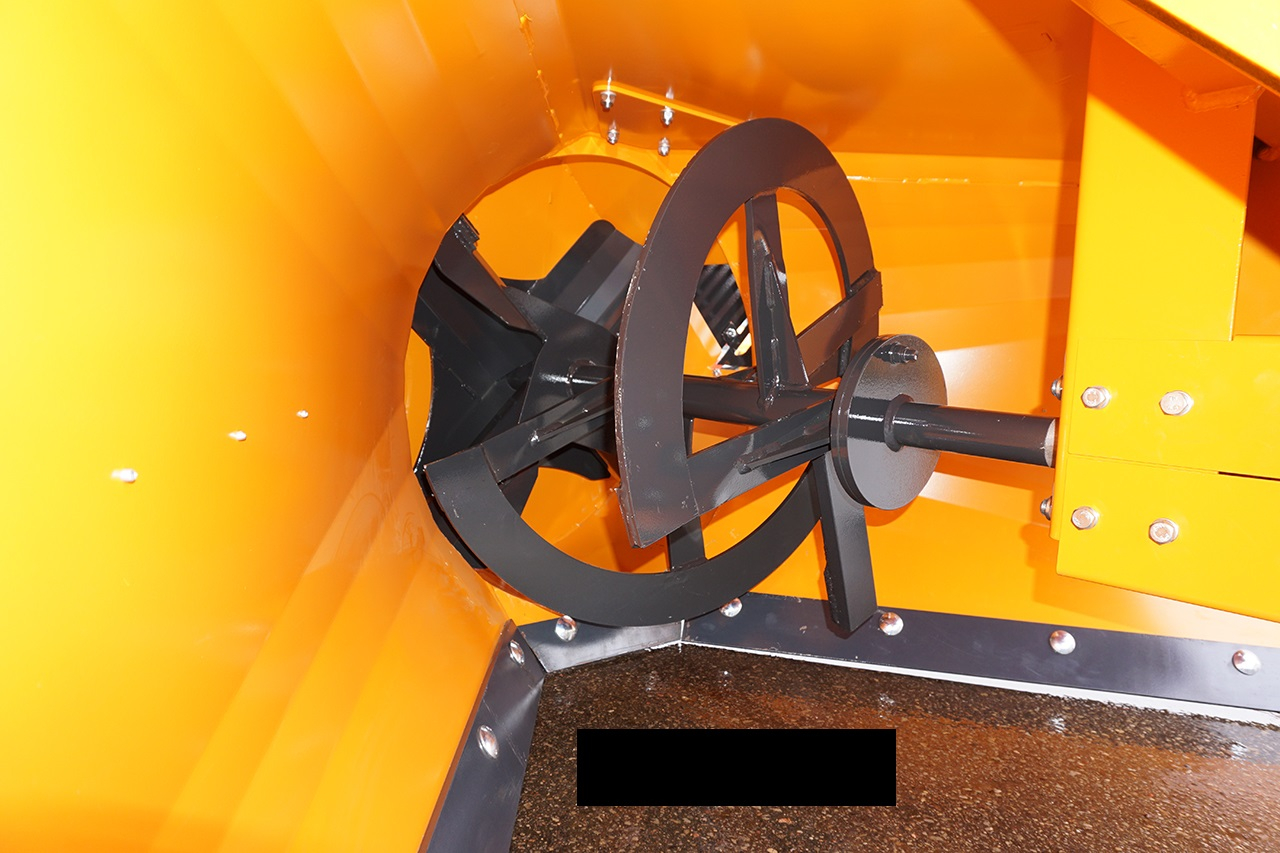

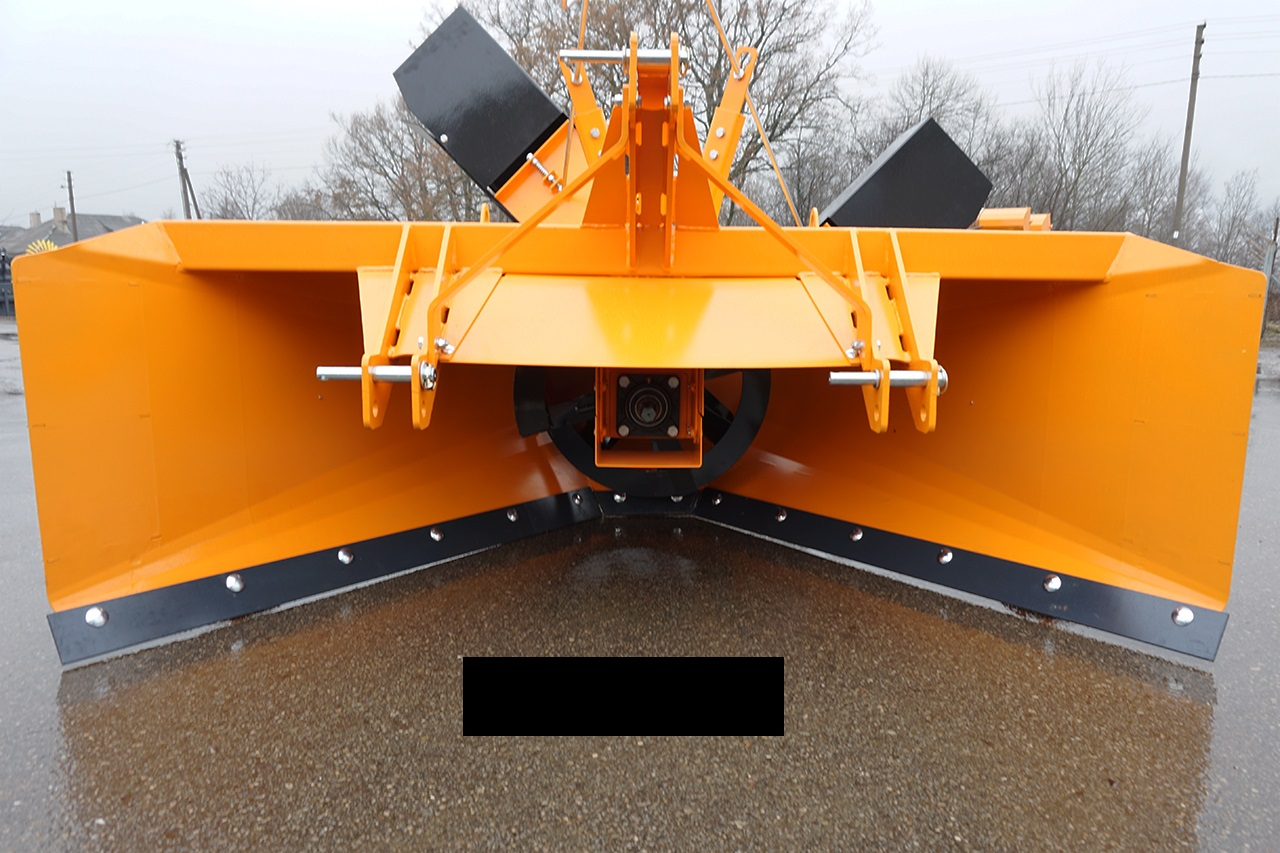

I may arrange supply of the snow blower shown in the pics. It blows to the either side. I'm dealing with the Lithuanian factory which produces them. They are pretty well made, fit big range of tractors, work good. Let me know if there is an interest.
Main tech specs: weight 430 kg; working width 2,25 m; tractor power required 45-110 hp.
As Airbiscuit stated, this is an old design concept and does not work well, in my opinion. This design depends on the blower housing, funneling the snow into a blower fan. I have an 84" inverted blower, with an auger that is full width and powers the snow into the fan but sometimes the fan will not keep up to the amount of snow the augers push into it, so I have to slow down. This design will be the opposite, especially with wet or heavy snow. The housing may not be able to feed the fan fast enough or the snow will stick to the housing, instead of being powered into the fan.
