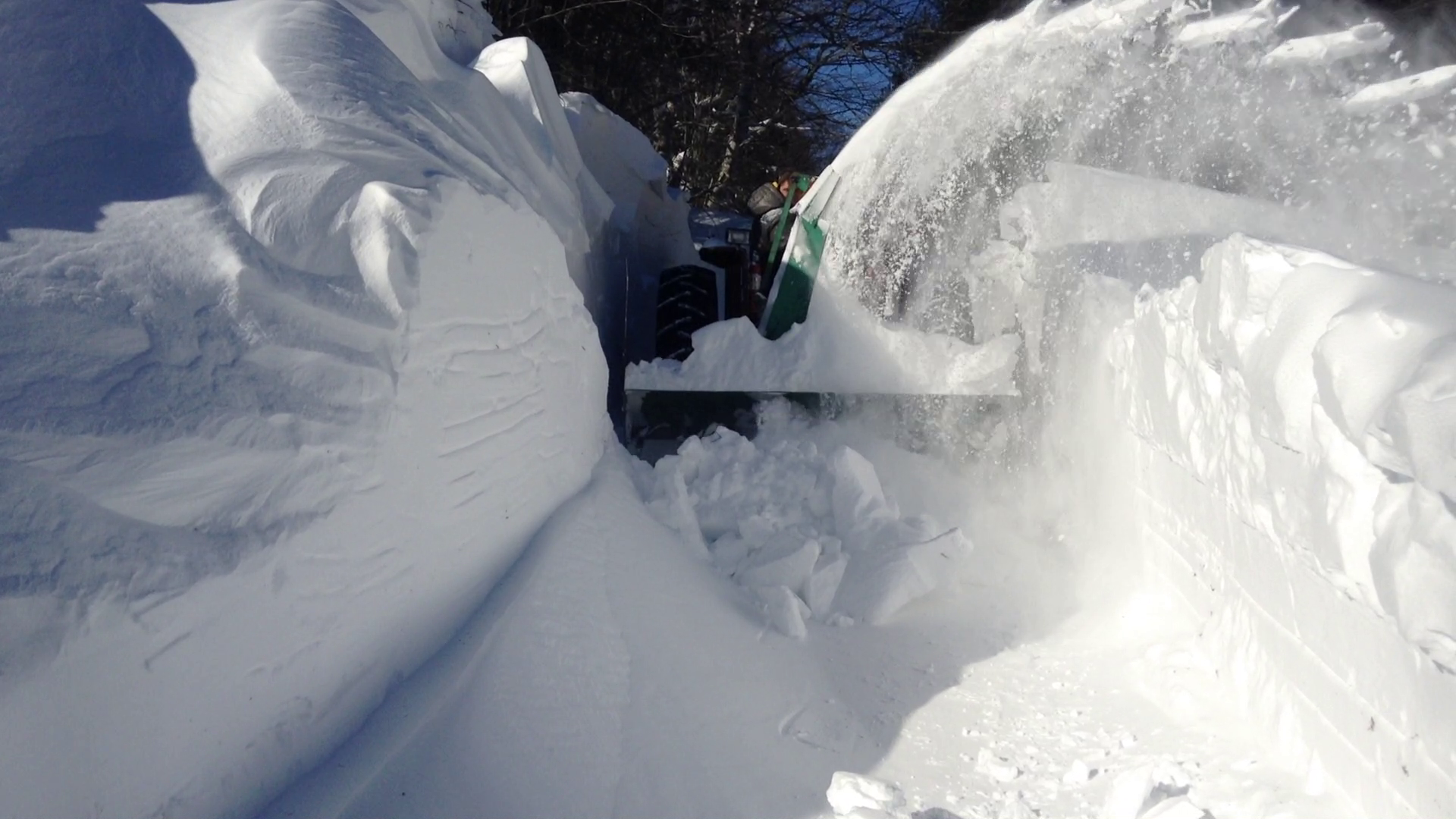

I have not seen a single inverted snowblower on this island except a very few of the old V type ones. The snow blowing contractors in the city are all rear push blowers and often a pull blade on the loader. More recently I have seen a few with the new PXPL style rear push blowers with the drop down back blade.
Front mount snowblowers are few and far between, A few on large tractors with front 3 points and a few on smaller compact tractors. I would say that over 90% of all the tractor blowers around here are rear push, including quite a few that are used commercially.
I blow snow for an hour or two after each snow fall with an old 80" rear push. I do not find the looking backwards for two hours hard at all, you turn a bit in the seat and it is easier if the seat does not have arm rests.
I really like the idea of an inverted snowblower, it would save a lot of time and make blowing easier, with the old gear transmissions you have a lot more forward gears than reverse and it would be a better for most snowfalls.
I have never seen one used around here though, and the other reason we are stuck with rear push is the driveway is cut in a bit and will occasionally quickly drift in with or without falling snow more than five feet deep for at least 100' feet long.
The whole driveing through the snow first/leaving two packed tracks thing I would think would be a non issue, I would think the blower would be able to scrape up any snow that matters, and even an old 2wd tractor can drive through a foot of snow without any problem ( chains are must).
My far and away biggest problem snowblowing in the winter around here is ice. The last two years have had extremely bad ice and the worst of all is when there is glare ice everywhere and then it snows a few inches of powder snow. Then it is so slippery you can hardly walk, studs in tires and boots can't get down to the ice to grip it, and even the tractor with ladder chains on the back I could barely move around on level ground and the hill was a wild slide to the bottom with no chance of getting back up.
The snowblower in the picture is a double auger, 34 inches to the top of the box.
I do not know why the photo attached four times, I still have a lot to learn about photos on this site.
vlcsnap-2015-11-25-19h04m43s165.pngvlcsnap-2015-11-25-19h04m43s165.pngvlcsnap-2015-11-25-19h04m43s165.pngvlcsnap-2015-11-25-19h04m43s165.png
