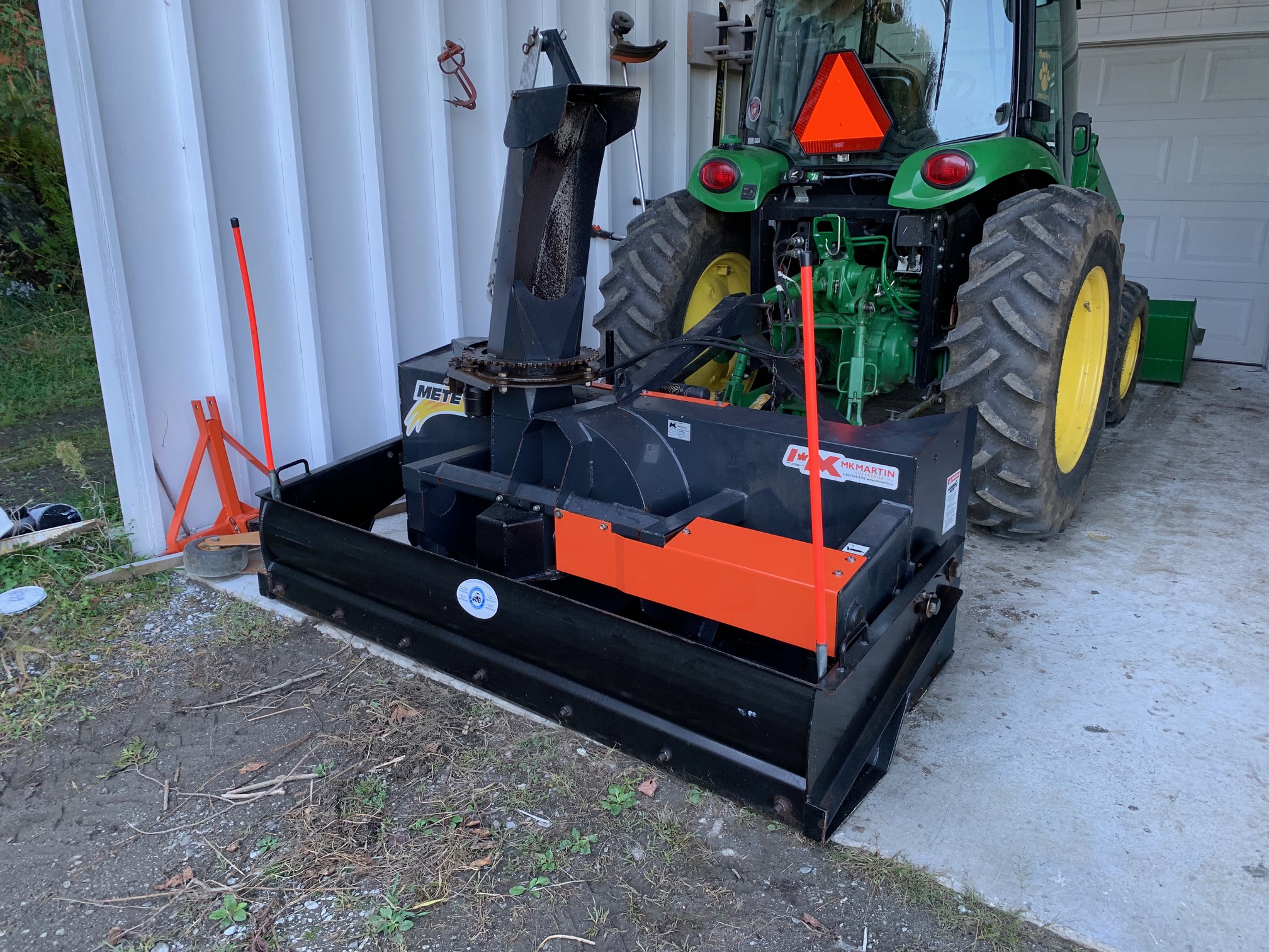

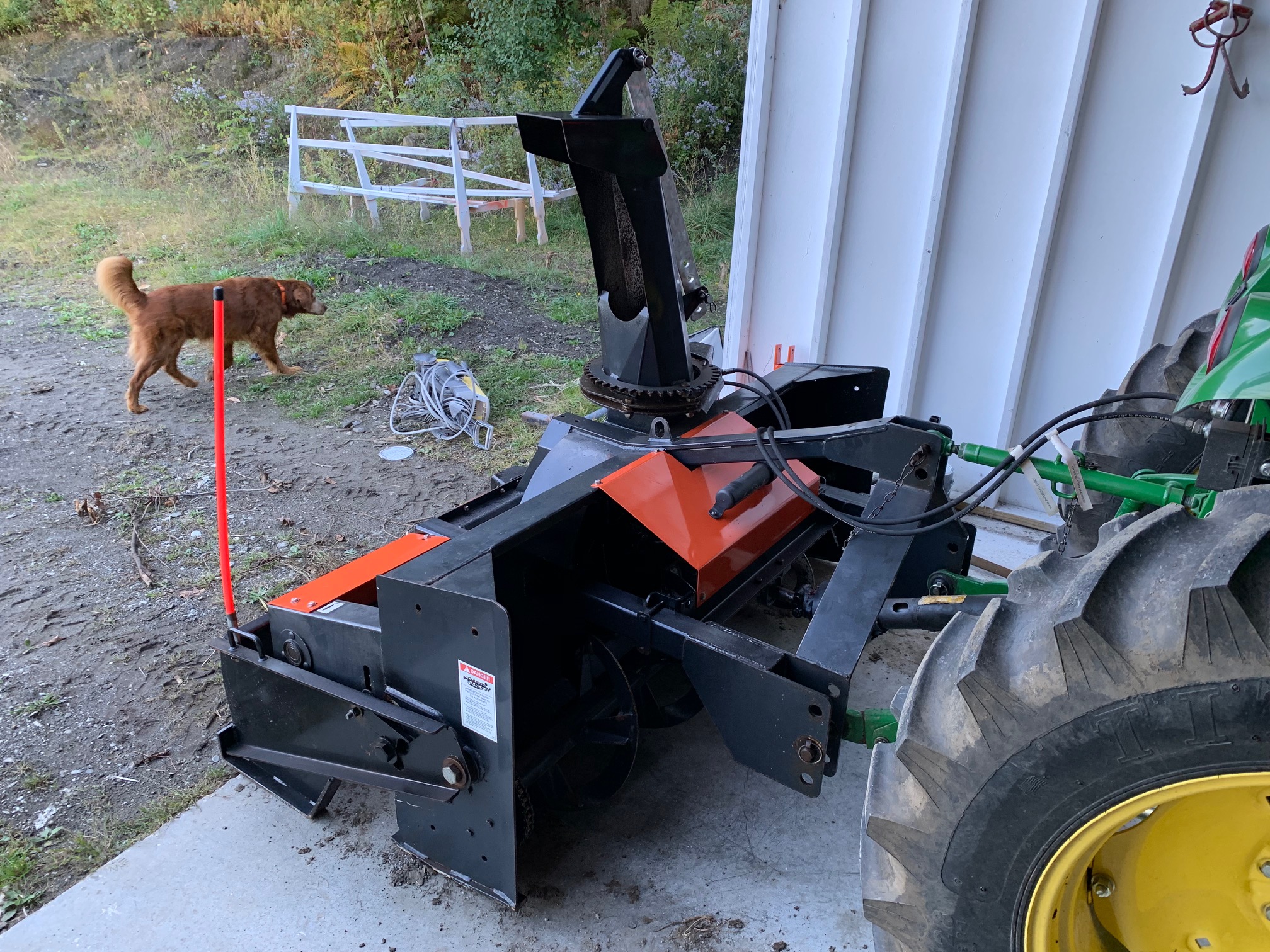

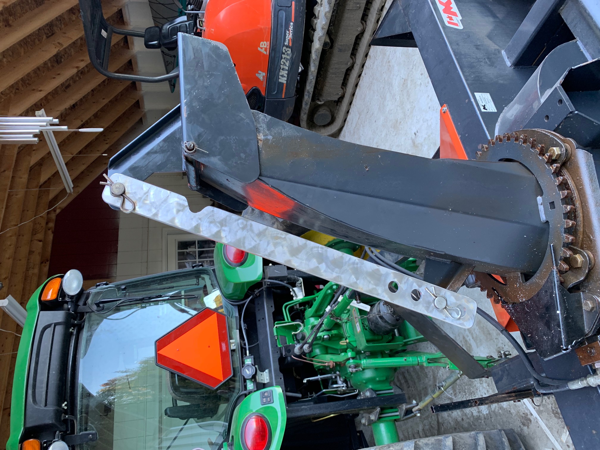

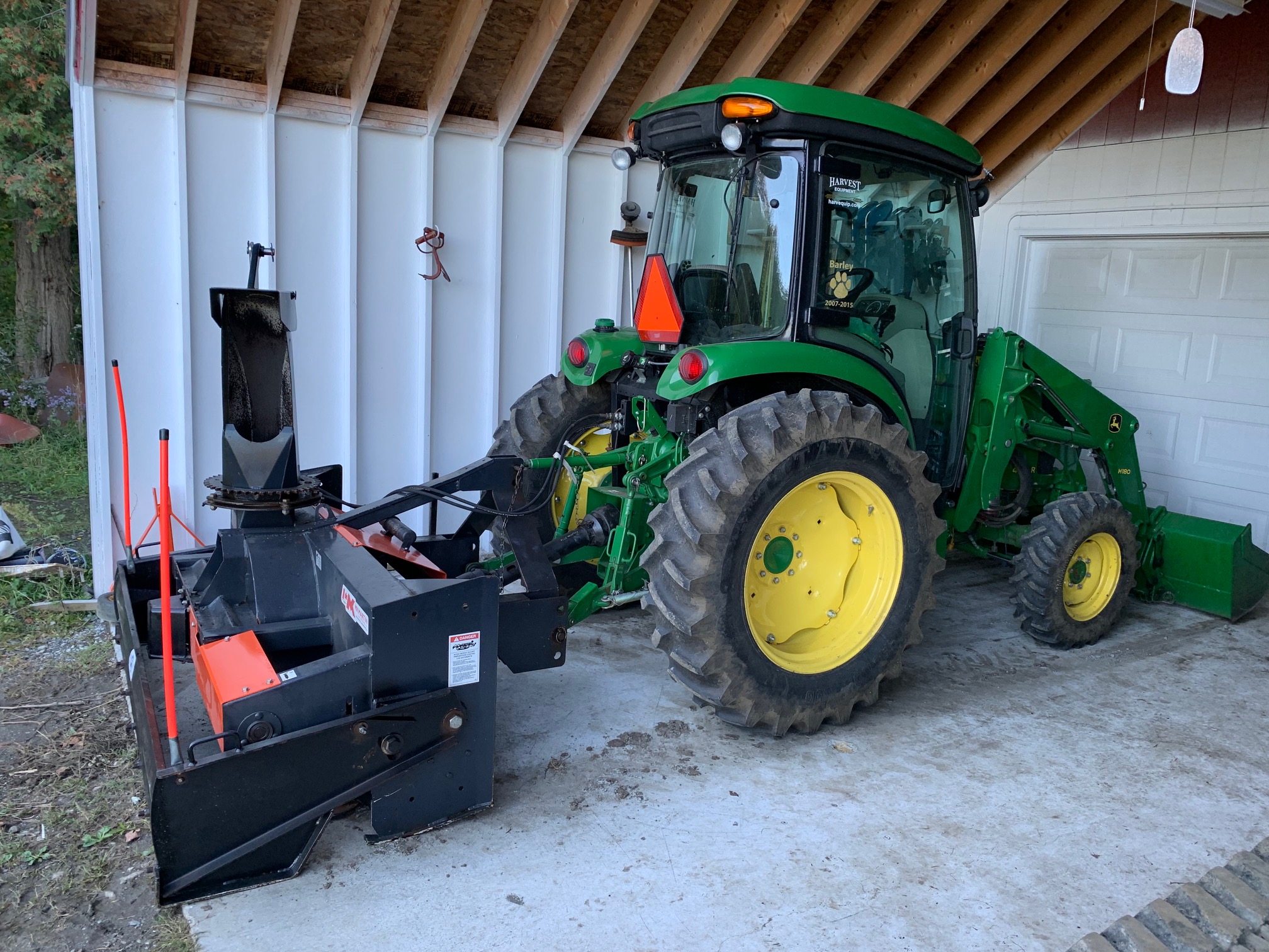

Got my new to me Meteor SB75 PT home today. The orange panels are guards; my wife is an OSHA disaster poster child so I color code the parts she needs to stay away from. I’m thinking of removing the back blade to lighten the blower since it falls to the down position every time I hit a bump. Since I had only one pair of rear remotes I removed the hydraulic cylinder controlling the chute deflector and fabricated a bar out of aluminum flat stock F7C0C620-724C-4B27-AD10-5FF4EEF1FA47.jpegD63C181A-998A-4FC9-9EE8-C12FECE54C7D.jpeg58C4D854-0907-4DEC-876F-0DEA17CD97DD.jpeg76F01D42-82AF-4B40-97FE-DB2675837B08.jpeg

   / Rear Inverted Snowblowers 2019 #60
Do not take the rear blade off. It is the feature you will come to love.
Back up to a door and pull the snow forward a few feet. Then back up again and blow the pulled forward pile away.
I have hydraulic cylinders on mine but many just use gravity.
Your tractor will lift that blower with its blade with ease.
