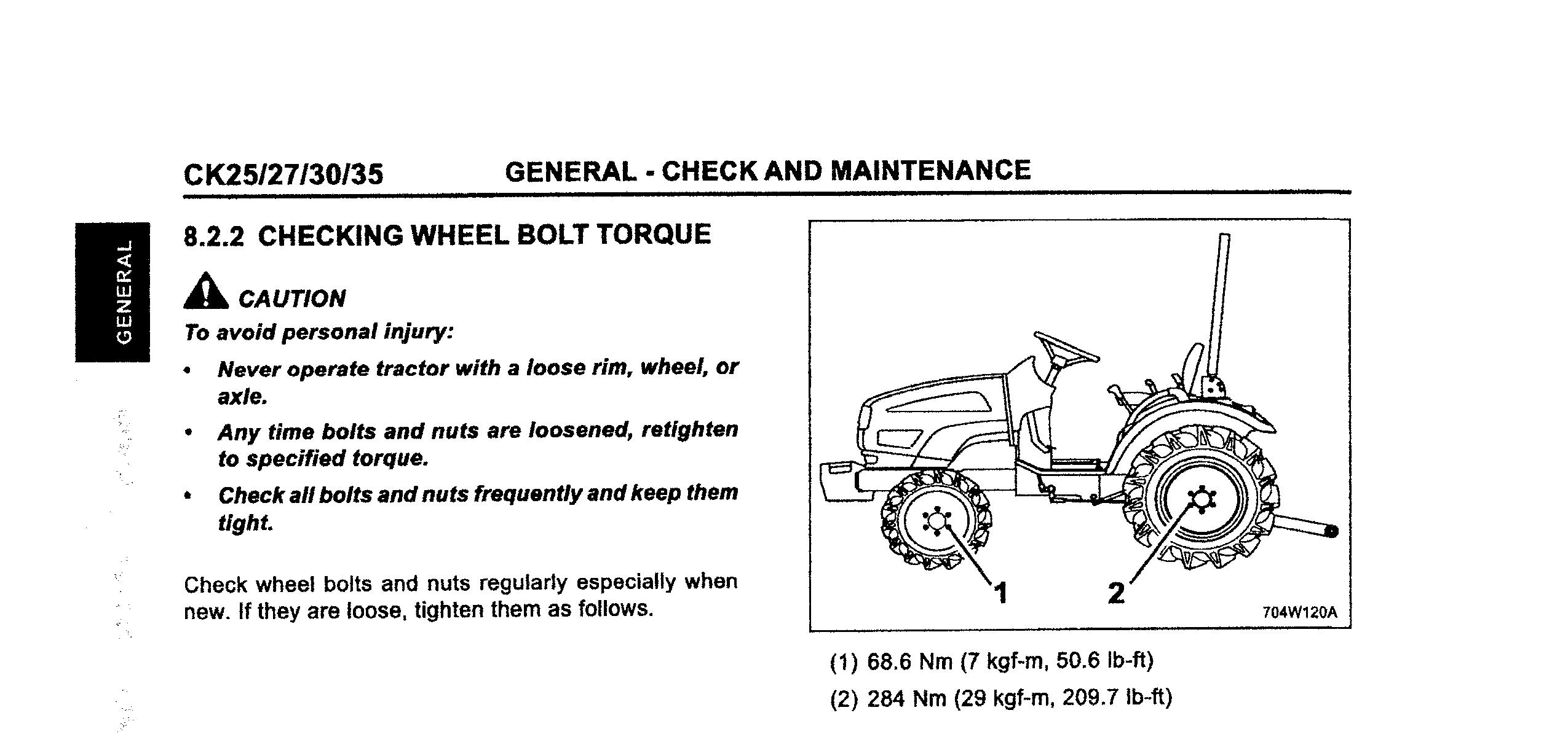

Well, this is one more data point where I'm not impressed with the accuracy of Kioti's US documentation.
Here is a scan from a 2007 CK service manual:
For comparison, the torques for my DK45 are 137 ft-lb front and 235 ft-lb rear, according to the owners' manual. By the way, I have two different editions of the owners manual for my tractor and there are several places where they disagree. Personally, I'd be inclined to err a little on the low side rather than risk snapping off a stud.
Supplemental: I just looked and saw you have a 2012 model, which must be an SE configuration. So the manual page I posted doesn't apply. Still, it must be more than 50 ft-lb.
/ rear lug nut torque #14
My 2004 CK30hst manual shows 66.5 ft/lbs for the fronts and 166.3 ft/lbs for the rear.
