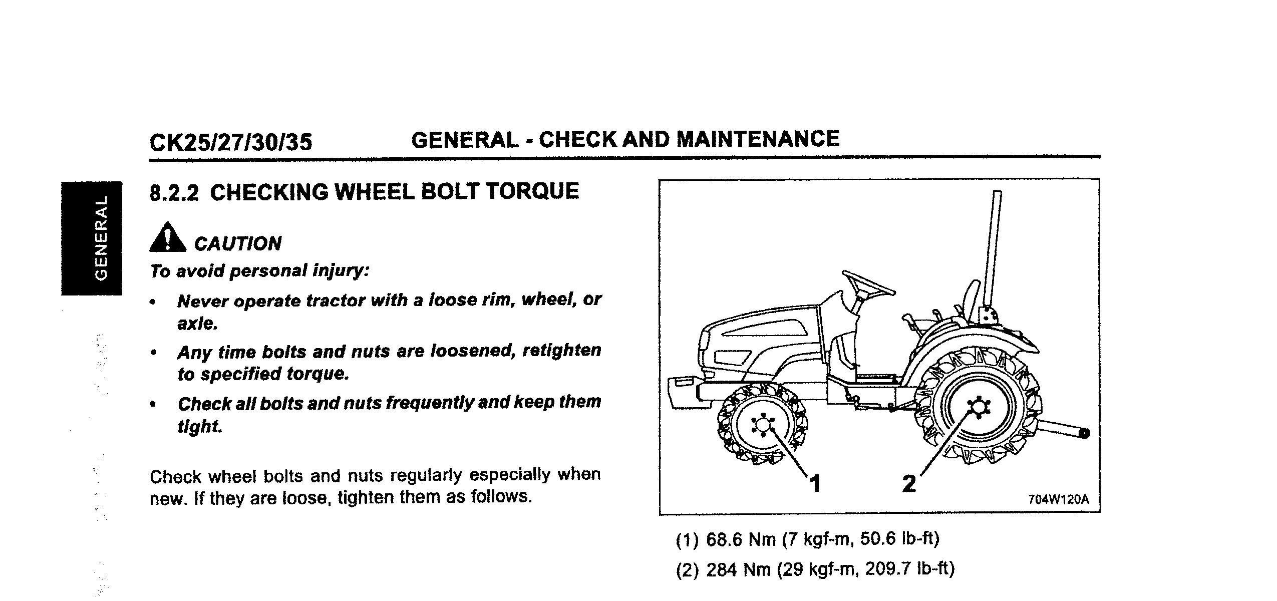

Have book in hand here Bob, problem being on page 10-14, book says 166.3 lbf-ft on page 50lbf-ft.

Actually you have an owner's manual, not a service manual, which is better than nothing, but, IMHO one ought to spring for a Kioti service manual for more available info and as a resource for their expensive tractor(s). They run +/- $100 - well worth it, in my personal experience.

I torqued the lugs to 50lbs, then upped it them to 65. Seemed pretty tight, I don't want to snap any. I guess maybe I should call Kioti and get an answer on this.

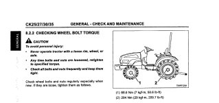

Chuck I can assure you that 65 lbs for the rears are no where near enough. You will "egg" out your wheel holes and ruin them here is snip from the CK35 workshop supplement. It shows a bit more. :eek: But common sense tells you that 65 lbs is not enough for those large wheels. After you torque them, check again in a few hours, and at 25 hours for several cycles to insure all the paint is wore in and the lugs have settled in.
Personally I would torque them to 160 lbs. I base this on other tractors I have owned of similar size and the torque specs in their books. It would be good to call Kioti and see what they say. The 200+ sounds excessive to me, but I can assure you 65 is no where near enough.

The fronts on my 2005 DK45s is 144.7-166.4 lb-ft the rears are 191.7-224.2 lb-ft.

YOU'RE referencing the owner's manual, and it's conflicting torque specs. Clearly 65ft/lbs is NOT adequate for the rear wheels. Most cars get torqued to 85ft/lbs or more on average.
Hill Billy Bob and I are recommending any owner of an expensive tractor buy a service manual to have the best and likely most accurate data available. There are occasional misprints, errors, etc. but they are relatively rare and usually someone here knows the facts Jack.:)

Seems to me there was a thread here several years ago that somebody with a CK30 had a manual with conflicting torque settings. They torqued to the higher, >200 ft-lbs, and they broke several of the studs. Seems they should have been torqued to something in the 160 ft-lb range. I can't find the thread now.
EDIT- I found several old threads, 2009-10 time frame, where the manuals for the CK series were listed at 290 ft-lbs for the front and 50 ft-lbs for the rear. Needless to say folks were breaking/stripping out the front studs. After much discussion and research it was posted that it was 50 ft-lbs for the front and 209 ft-lbs for the rear.
