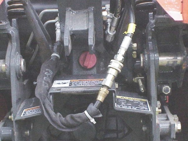

I have since learned of a added benefit to the rear remote. With the set up of the hoses, it makes it easier to hook up the backhoe because the lines are now longer. This is particularly important with the BX if your backhoe has settled to the ground while in storage.

Am I seeing this setup correct, that your rear remote is disabled when your backhoe is on?
   / Rear remote on a BX22 ~ Part 2 #20
That is how I understood it as well.
