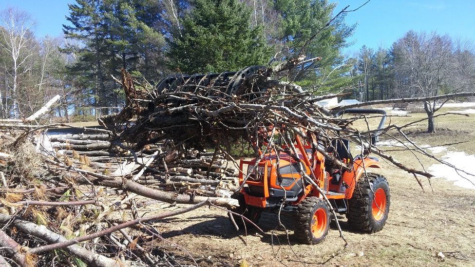

Our two most popular grapples for the 2510:
The new 200 pound Wicked Grapple Rake is shown here on a CK35.
The 50" Wicked Grapple, which is still under 300 pounds! Roy in GA has one on his CK2510 and he shows it off well.

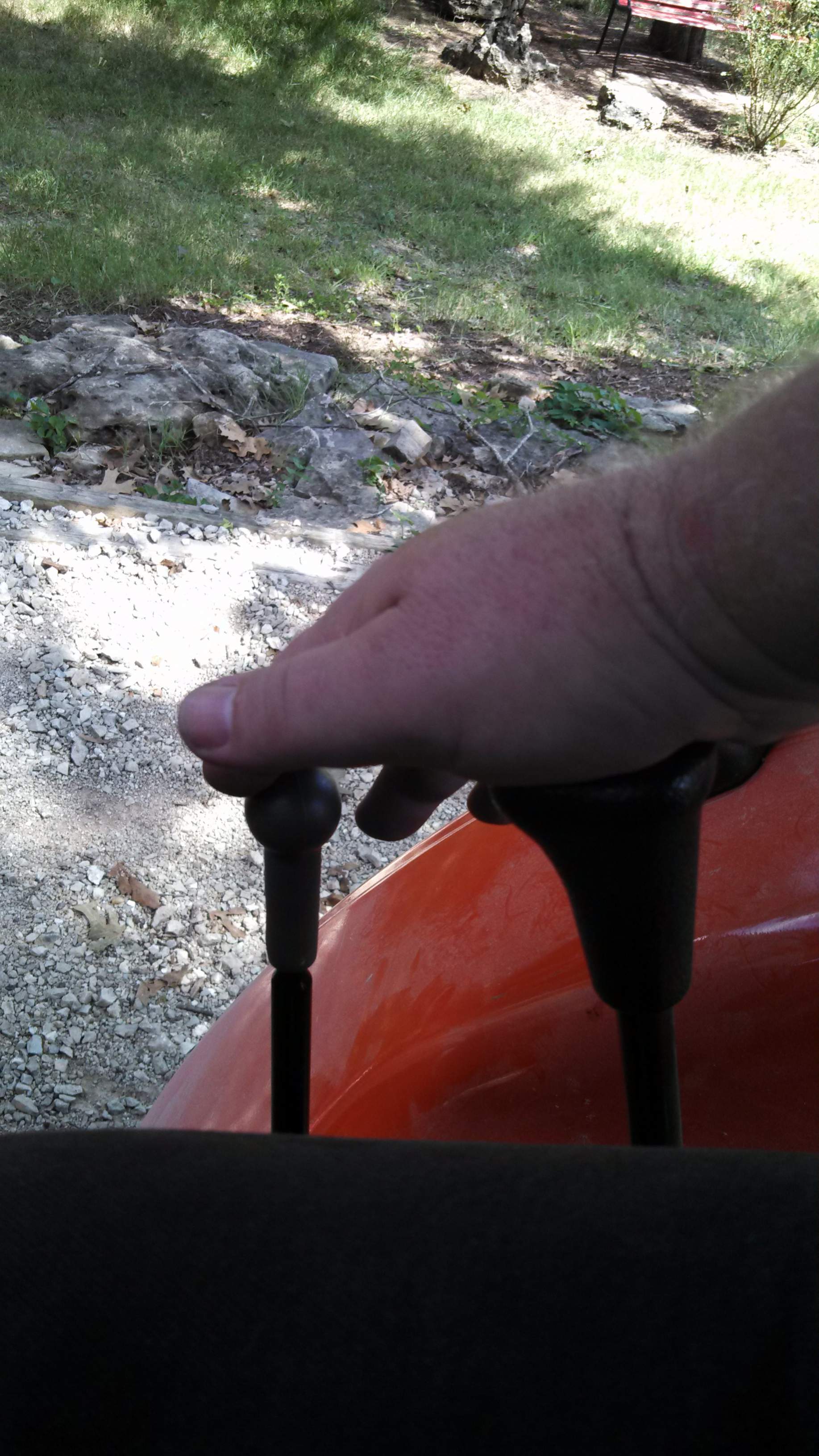

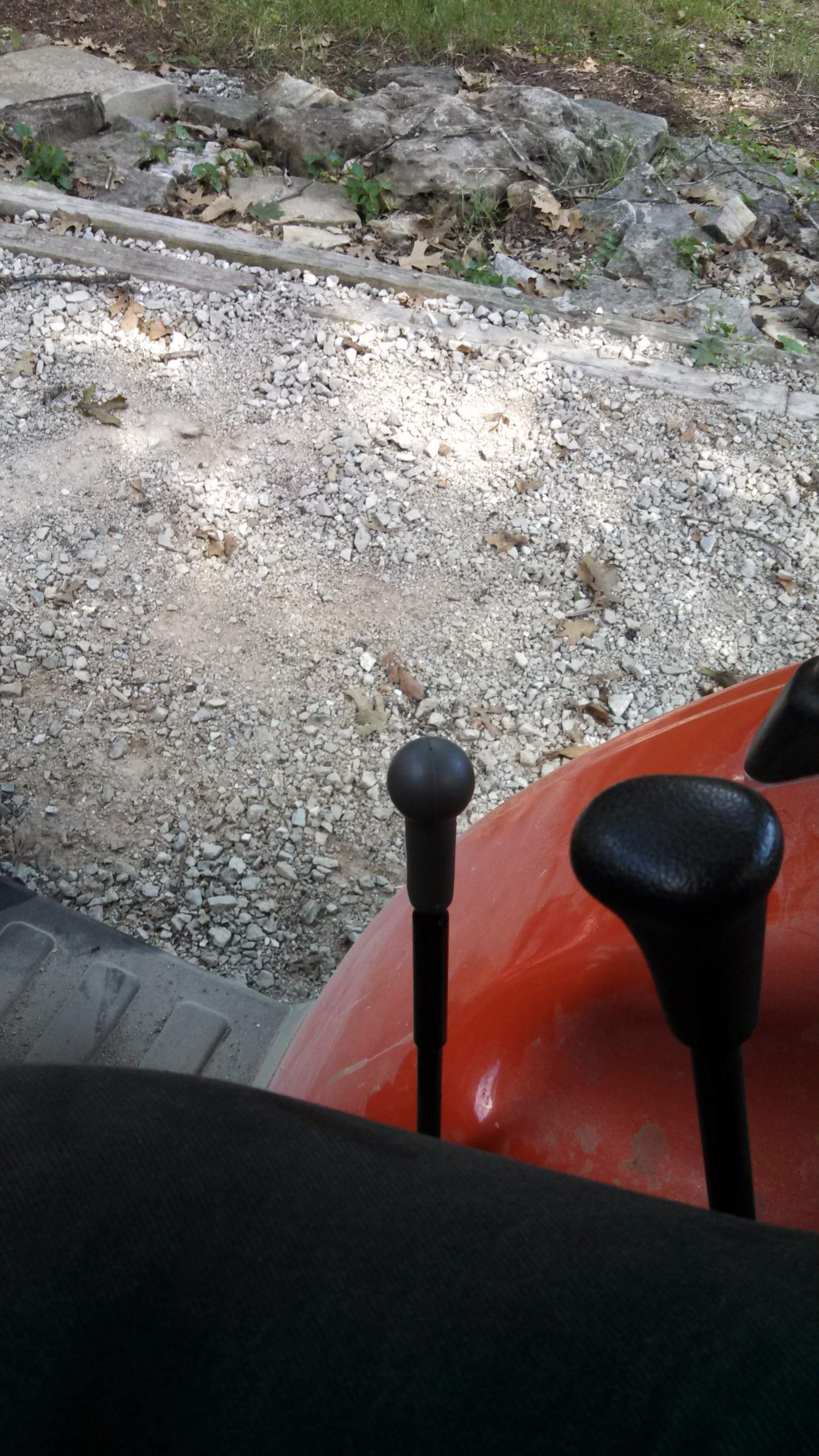

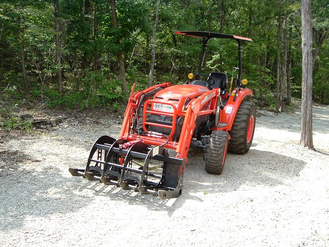

I think I'd prefer a 3rd function with a button on the joystick, but some guys with Kioti tractors find it sufficient to use the rear outlets because of the convenient lever location. These pics are by TBN member James koua.
Travis
He has our 50" Wicked on his CK35.
