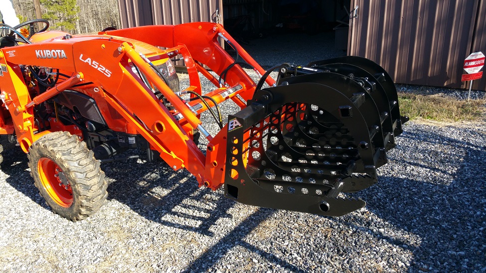

Ordered the 50" wicked grapple from ETA. Build time is about 4 weeks. Hope the 46" lines that come with it are long enough to reach the MIE couplers on the loader Cross tube? Anyone have any experience with this??

Joe, if they're over to one side and mounted rigid, I generally go with 60" hoses. This is my father in law's L3301 with a Wicked 50. We also zip tied his lines together, which makes them coil nicely.
Travis

Thanks Travis, Could you change them to 60" on my order? I'm getting no couplers just threaded ends. MIE is sending me the correct male adapters. I just ordered it yesterday with Rick.

Certainly! I updated the notes and emailed a copy to you.
You're gonna LOVE it, man!
