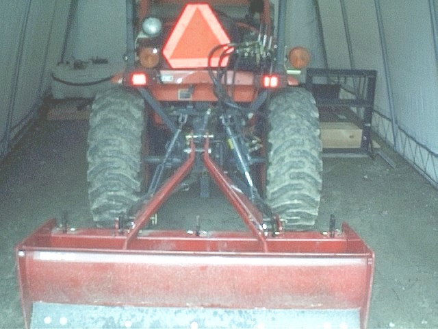

I finally got my tilt link cylinder from Integration Engineering (same one as on their TCC setup) and installed it. I did run into a few problems which I will document in the following posts. Overall I am happy with the final result but it was not a complete drop in installation.
Cost for the tilt cylinder was $253 + $25 shipping. My hoses and fittings were acquired locally and ran about $30. The new lower adjustable fork from Kubota was $33.

This picture is for MadDog.
I moved the adjustable link over to the left side to allow for leveling adjustments. In order for the lift arms to be level when the tilt cylinder is extended half way, the lower fork had to be extended 3 inches. This still gives plenty of adjustment on the adjustable link.
I purchased a new lower fork from Kubota and machined two extensions from bar stock and welded them in place. A couple of holes and a little ROPS gray paint finished it off.

Not when you set the adjustable link so that the box blade is level when the hydraulic link is extended half way. The TCC hydraulic link has a 5" stroke. It really pushes the lower lift arm down. When tilting the other direction, the other lift arm does not go as low.
I think this has to do with the geometry of the 3pt with everything extended 3" along with the 2.5" cylinder stroke for half way. The TCC cylinder adds 3" by itself when retracted to the distance between the upper and lower lift arms. The actual lift height is shortened a bit too.
However, even 2/3 tilt is a lot. See picture.

Tilting to the right does cause the box blade to touch the ground when the tractor is sitting level.
I think the problem is that the generic TCC cylinder is actually too long in both stroke and actual size for the shorter lift heights on the B series. If the stroke was say 4" and the overall retracted length was equal to the fixed link (which has been discarded) then you would get equal tilt in both directions.
However, with the way it is now there is plenty of tilt, just more in one direction with a loss of a few inches of lift height. An acceptable compromise, I think.
