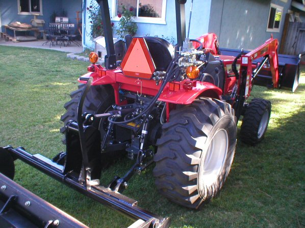

Hey I've got a question for you other ls owners out there. My 3039 like most other ones have the rear remotes on it and I'm wondering what equipment could be used to merit putting remotes on a compact tractor. I have used a large "bat wing" bush hog and a very large set of disc harrows but that was on a big old farm tractor. This type of implements would be to much for a compact wouldn't it? What are you guys using with your remotes? They are on there so I want to use them for something other than talking points :)

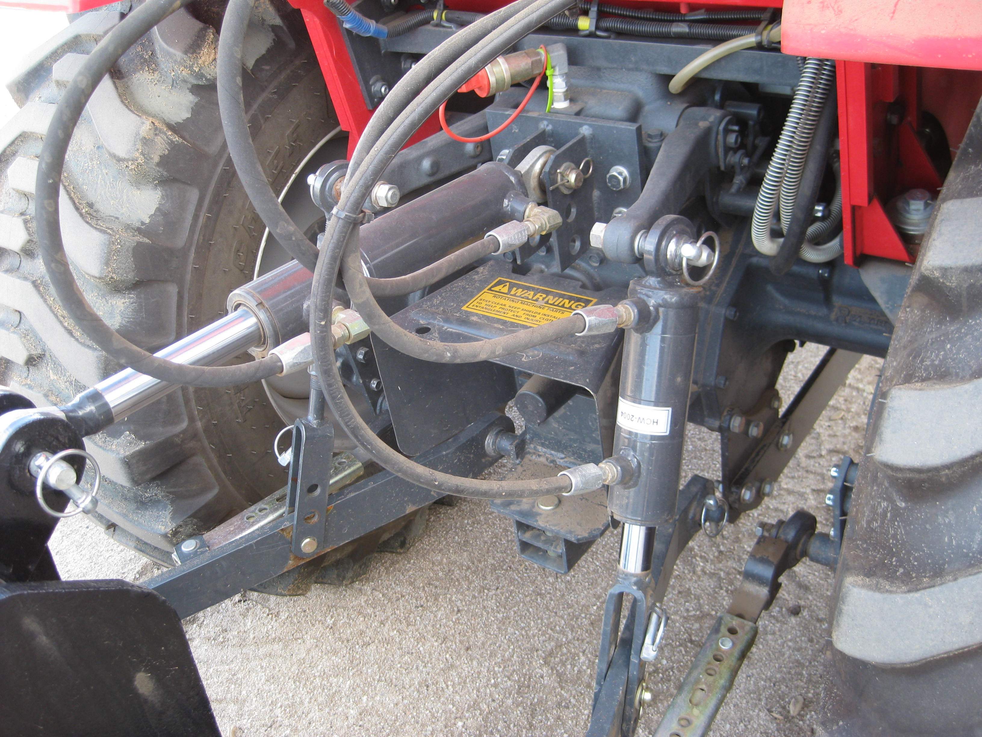

I don't have a LS but I have 2 rear remotes for a top and tilt kit. You can run a wood splitter, a box blade with hydraulic scarfires, down pressure kit for a post hole digger, hydraulic feed on a chipper, and many more thing I can't think of now with remotes. Your tractor would be to small for the batwing or disc you are talking about.

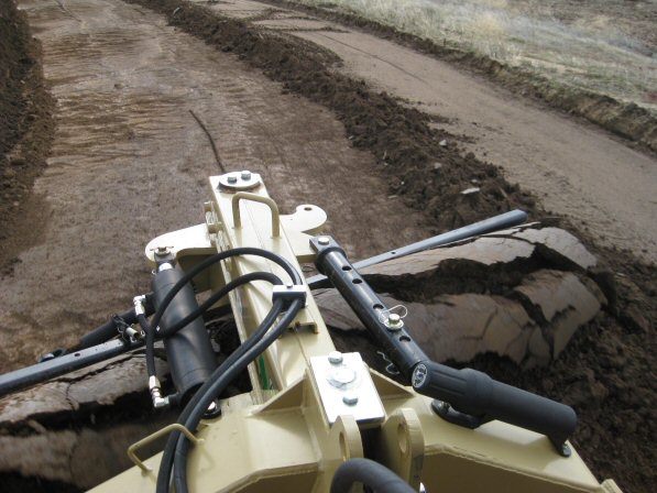

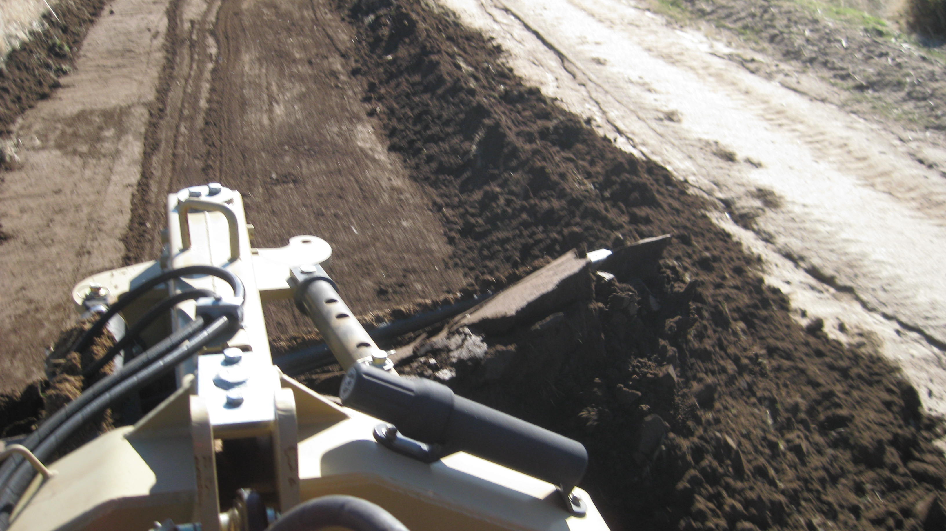

If you do much grading at all, you will really appreciate having Top and Tilt cylinders on your 3pt hitch. Another nice thing to have if you happen to have either a rear blade or a landscape rake is a hydraulic to angle the blade or rake. It gets old real fast having to get off and on the tractor to make all the adjustments that need to be made to get the job done right. There are many many hydraulic optioned implements out there that are just right for your tractor. Enough that you may find that you will need to get more than what LS even offers. (3 rear remotes I think) If that happens the easiest thing to do is to get a diverter valve. But you have to get that far first.
Good luck and you can never have enough remotes. :rolleyes: ;)
