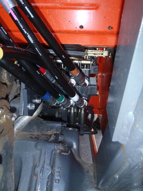

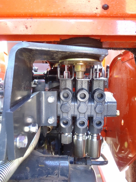

Almost all done. Kit was short 3 of the tiny hair pins that secure the links to the levers. So I used tiny finish nails, just to get everything pinned together so I could check that nothing was binding. Will get some at the hardware store and pull the nails. The tiny pivot pins that secure the link to the valve had their cross drilled holes undersize so the hair pins would not fit. Had to open them up with a teeny-tiny drill The 3pt valve actuator had some kind of clevis (for draft control?)that interfered with the valve stack, so it got cut off, since I don't have draft control. Have one small drip on the first valve coupler that I need to tighten, but it was getting dark and the skeeters were hungry.

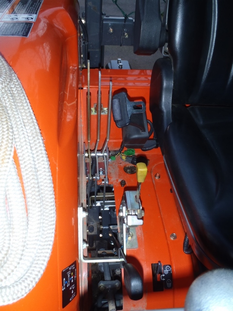

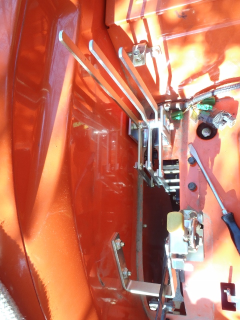

Thanks! Yes, I remember the mountain you moved with your L3240 - that really impressed me. I'd put the installation somewhere between the "challenging" and "maddening" categories, partly because it was HOT yesterday and I was a tad hungover. Mostly, it was difficult because there just isn't a whole lotta space where all that stuff has to go, and once it's there, there's no room left for fingers. Secondary issues were missing bits, bits that didn't fit and a piece of my loader control that interfered with the first valve and the tube set that connects it to the transmission. Definitely easier with my buddy, Enzo, helping me out with 3rd and 4th hands as well as making some very solid suggestions at key moments in the build.
There were a few "2 step forward, 1 step back" drills. For instance, after getting the valve stack together & bolted in, I realized that there was no conceivable hope of connecting the spools to the linkages, so I had to unbolt the whole assembly, rock it back about 60 degrees, attach the links and then rotate it back into position and re-secure the tubes/bolts. Trying to secure all of the hoses to the valve stack was another tight operation where I was glad to have a 22mm combination wrench, as it just fit. Trying to get the 3 connector housings aligned and bolted to the mounting bracket went a little like an Abbott & Costello routine where we'd wrestle everything into place just to have something misaligned, preventing the 8" bolts from clearing all the holes, or both bolts would simultaneously drop out and everything would go in a different direction. But we got it all together with just average mechanical skills.
I cannot even imagine trying to buy all of the components from 3rd party suppliers and get everything to fit in there. Now that it's done, I'm very happy with how it looks, and do not regret the considerable expense. Now that I have a clear understanding of the order of assembly, and have parts cut/drilled to fit right, I could probably do the job again in 1/3 the time: 2 hrs instead of 6.

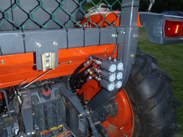

TnT kit from Fit Rite arrived, yesterday.
Everything looks good - outstanding packaging job.
I have never received anything by freight that was so well protected.
Would have made it through the Samsonite Gorilla test without a scratch.
Should get to installation on Saturday.

TnT installed with any problems.
Good directions and everything fit.
Used them with the rear fork attachment to move pallets of split fire wood.
What a difference!
