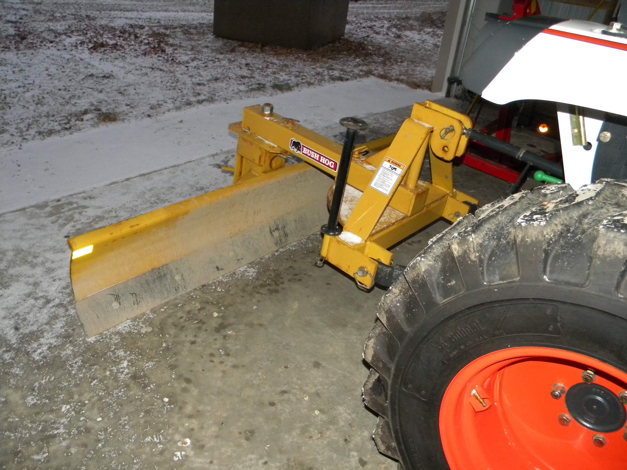

I also emailed bush hog and they said a 35 series would be enough but that looks about like rb72. How much did your 50 series bush hog blade cost?
   / Rear Scraper Blade #4
The bright shiny orange one the dealer had was $775. The weathered yellow (still new) one he had from the previous year he sold me for $695.

That is a nice looking blade. I like clevis style hook up and how the moldboard is shaped. The 50 series bush hog is only $100 than my rb72 was.
   / Rear Scraper Blade #6
The clevis style hook ups are important if your going to put any grunt into it. I wouldn't buy a blade that didn't have them.
