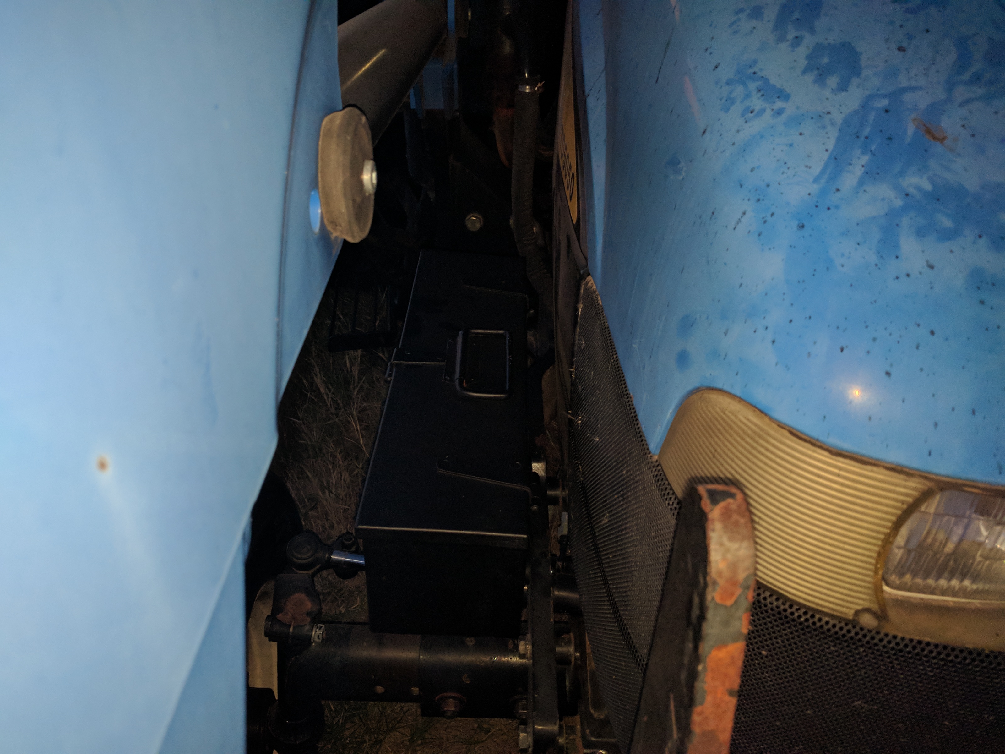

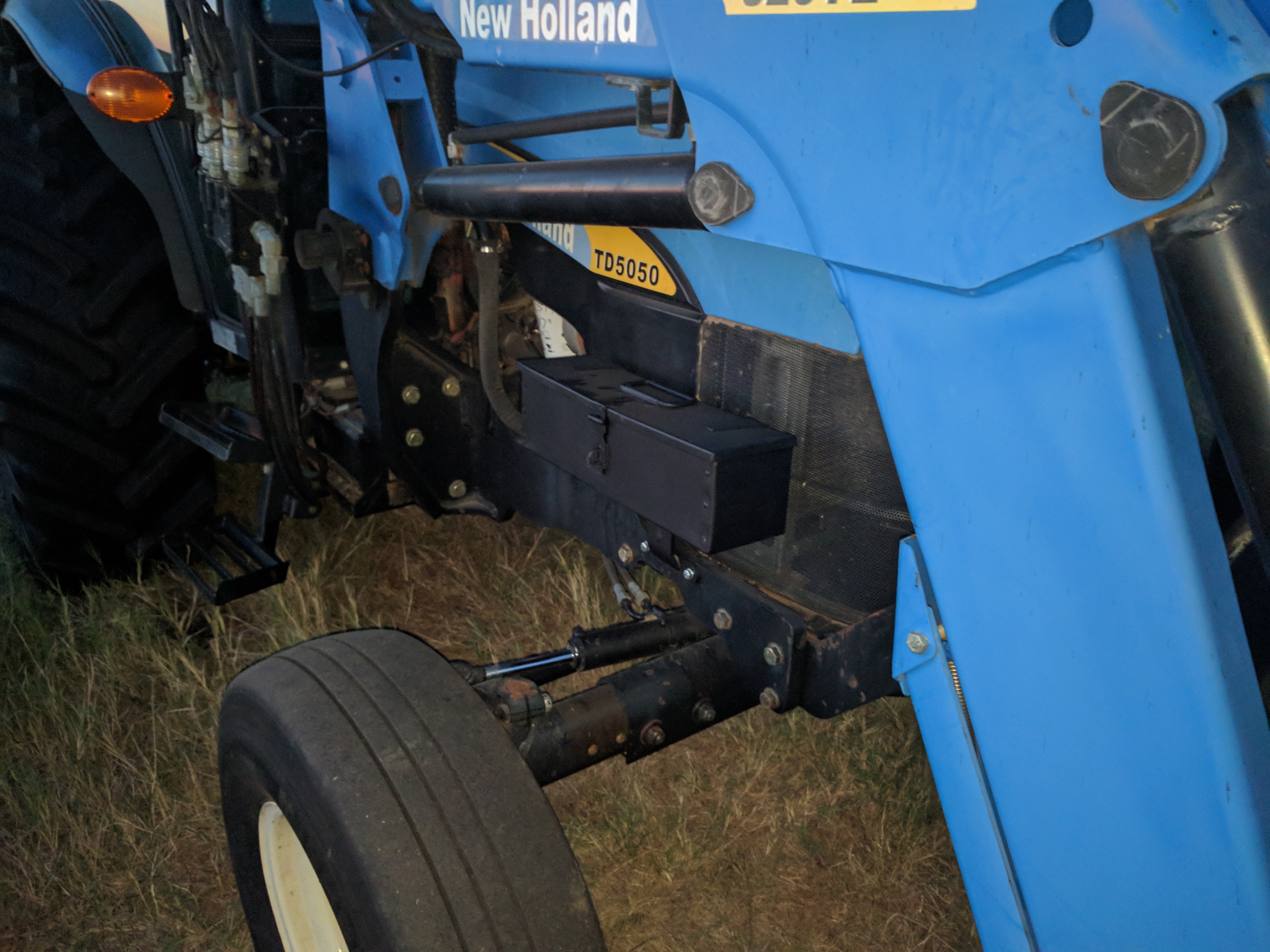

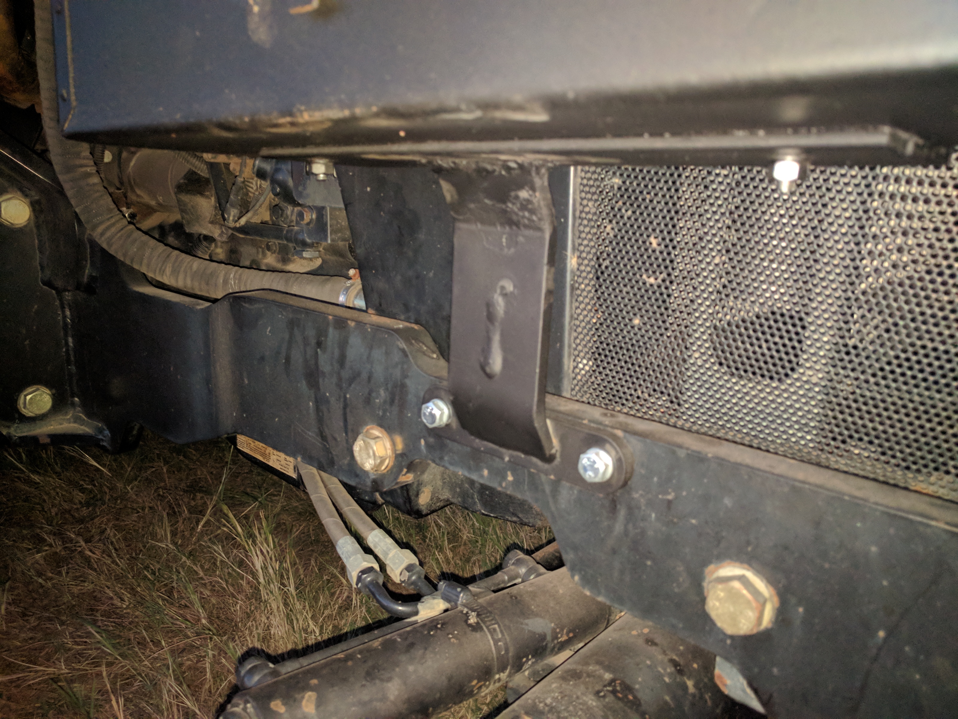

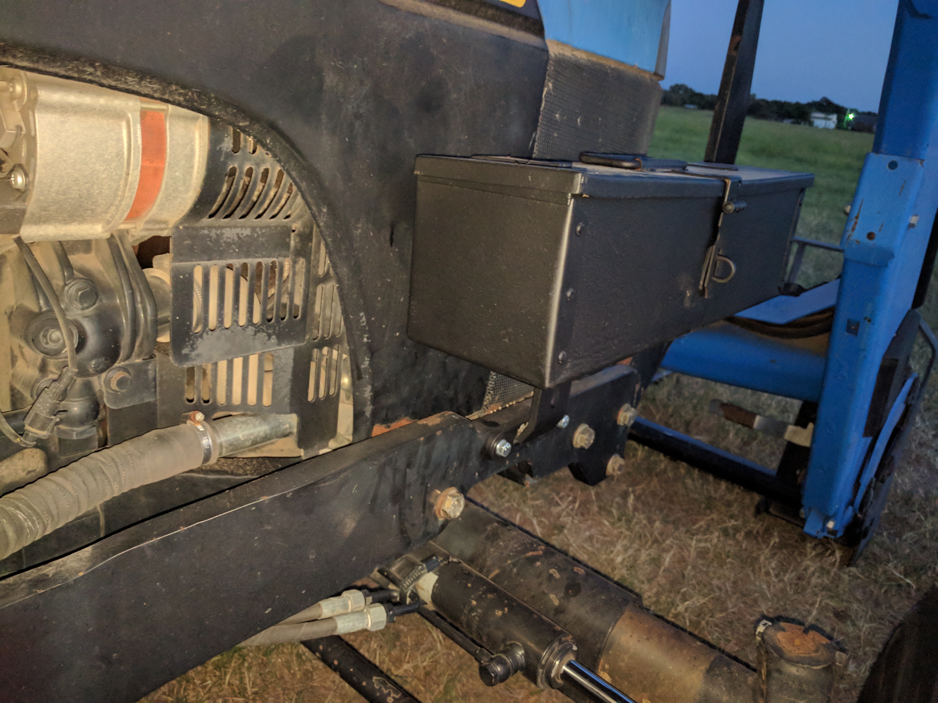

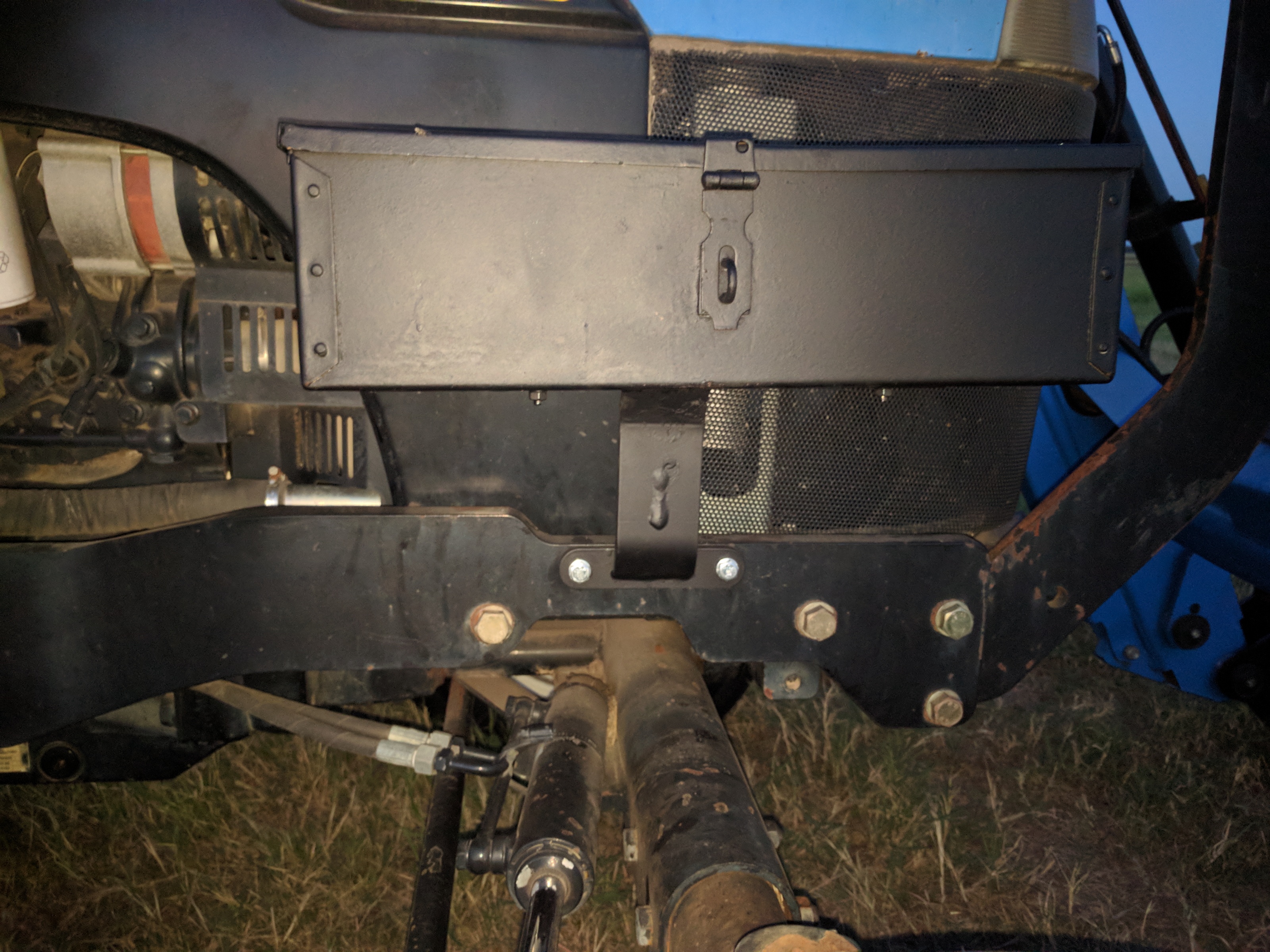

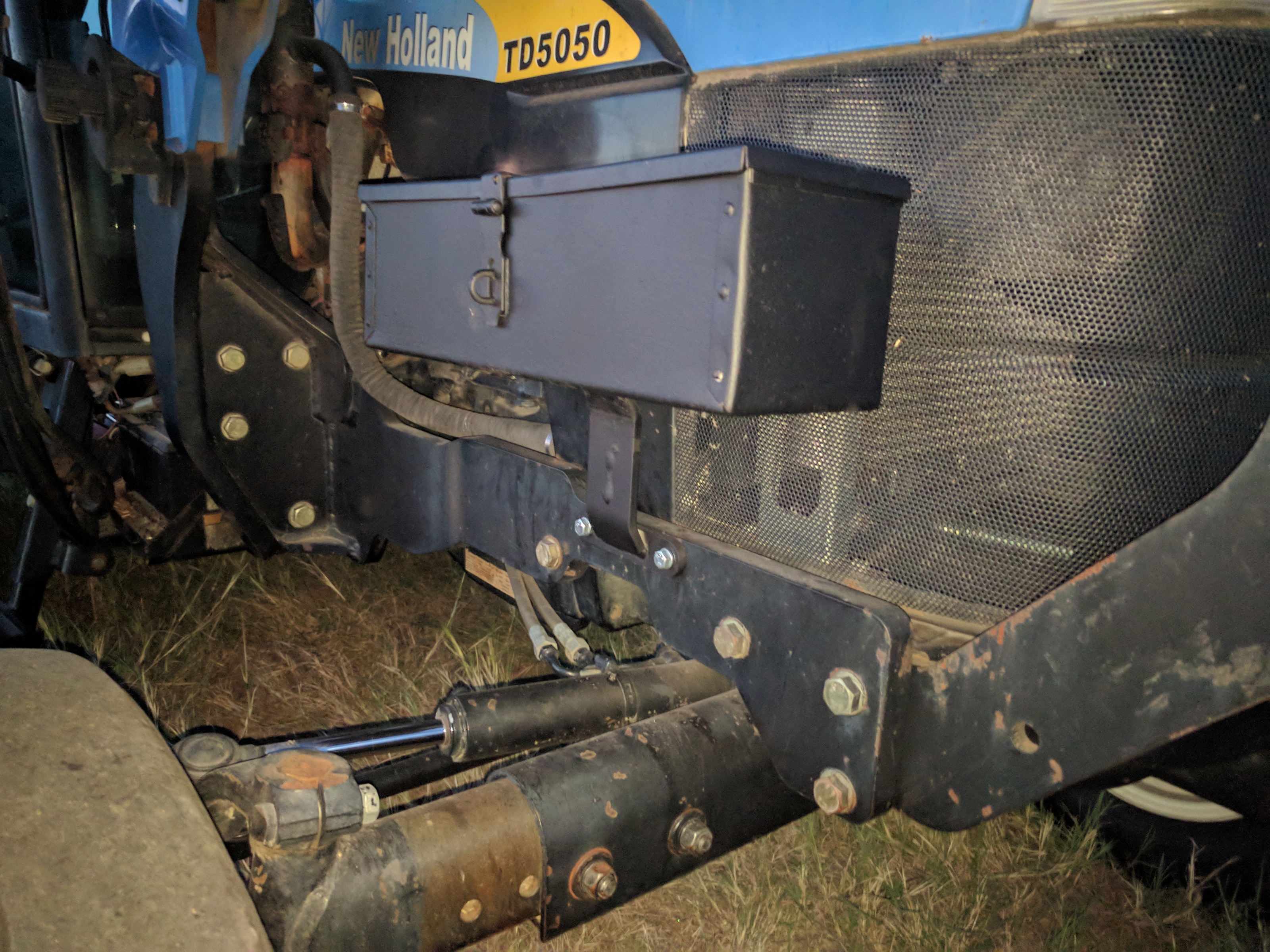

F3506 - "I also added a tool box to mine since it didn't come with one and I wanted a place to keep miscellaneous pins and such." - Where did you put the tool box? I badly need to add one. Can you send pictures? -Thanks
   / Rear tire is flat! NH TD5050 rear tire torque value? #24
I mounted mine on the right side front end loader frame. I didn't take any pictures, but will take some tomorrow if I remember. Left side was out of the questions since that's the side the AC coil slides out on.
   / Rear tire is flat! NH TD5050 rear tire torque value? #25
Didn't get around to taking any photos until the sun was going down (busy day), but here's what I did. Drill and tap the holes for the mount. Make a bracket with some steel and angle iron laying around. Install a steel toolbox I found for $5 at our local, twice a year, 20 mile long garage sale type event, and add some black spray paint so it didn't look so homemade.

Thanks 3596 - Great pics and nicely done. I thought with the black paint your box disappears against the black frame. Looks like you got a couple hours in it but should last as long as your td5050 does!
