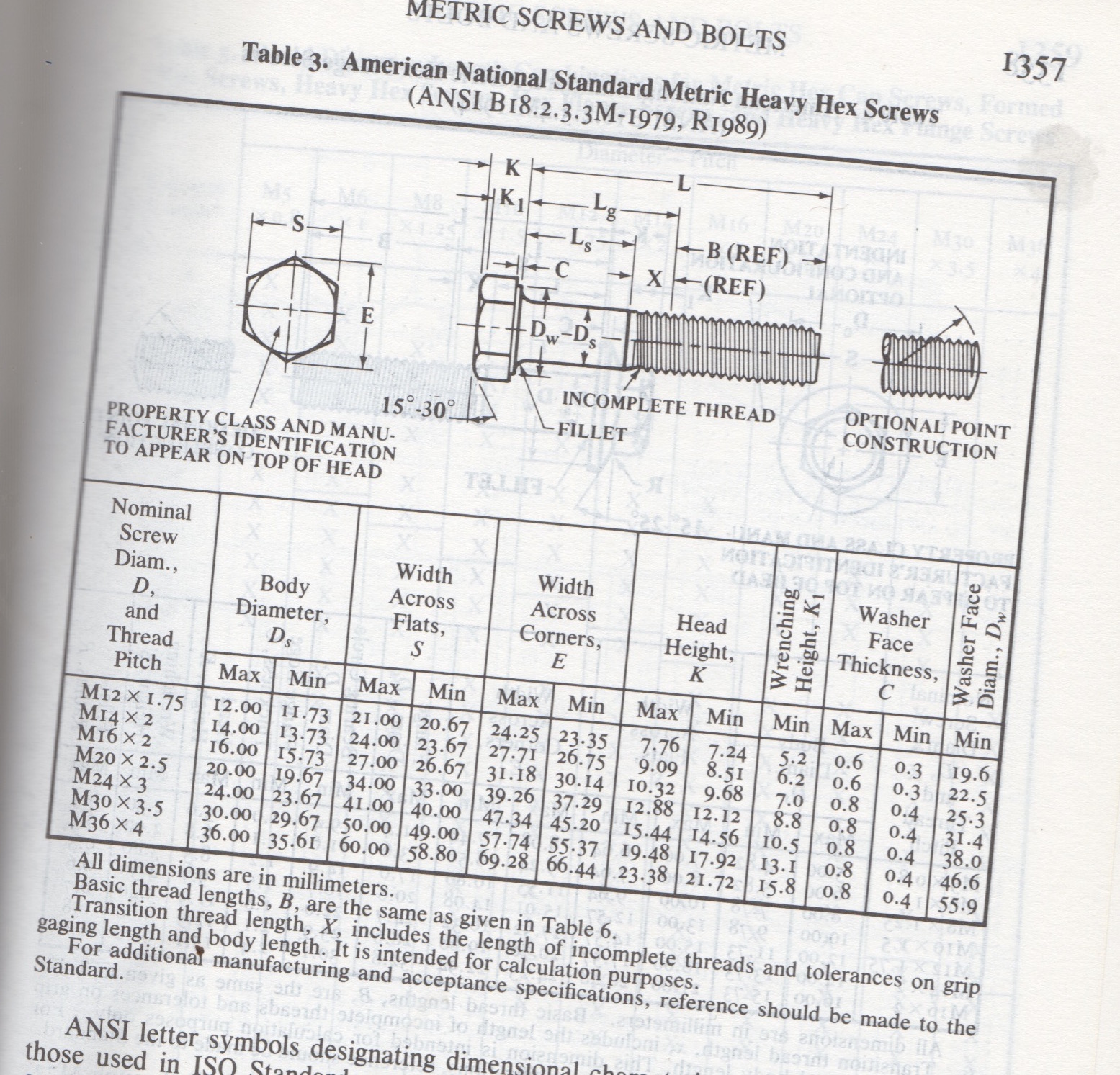

The rear tire bolts are 27mm lubricated and I believe class 8.8. According to fastenal engineering chart that would mean I need to tighten the bolts to 597 ft-lbs. According to a different chart i found it states 700lb-ft. So that's a lot of pressure, more than twice what my 1/2 torque wrench will do. I still want to find the correct number in NH documentation however I don't think I want to buy a wrench that can actually do that, its hundreds of dollars.

Ranger, wait a minute....you do realize all of those torque charts are referring to the actual bolt diameter, not the socket size used to remove them...right? Got me worried or am I the one that's confused?
   / Rear tire is flat! NH TD5050 rear tire torque value? #14
He know the socket size 24 and 27 millimeters. He is questioning the torque values. I think the chart he posted gives the maximum torque for the bolt. He is saying he was provided a torque of 597 ft pounds. I have never seen a wheel lug bolt or nut with that high a torque requirement.
   / Rear tire is flat! NH TD5050 rear tire torque value? #15
A reference out of Machinery's Handbook is attached. Socket size has no bearing on the amount of torque the stud will withstand.
You can't have a 27mm threaded bolt with a 27mm hex head bolt. It would look like a piece of all thread with 6 little nubs. Certainly useless for holding wheels on.
Im say'en he has a 16 mm bolts on the rear tires that use a 27mm socket which would call for 140~175 ft. lbs of torque or whatever the chart says and 14mm dia. on the front which would use a 24 mm socket.
All one has to do is measure the diameter of the bolt. 16mm is only a hair over 5/8" and 14mm is only 2 hairs under 9/16". 27mm is a beast of a bolt 1 1/16" diameter. :) H.D. Metric bolts.jpeg
