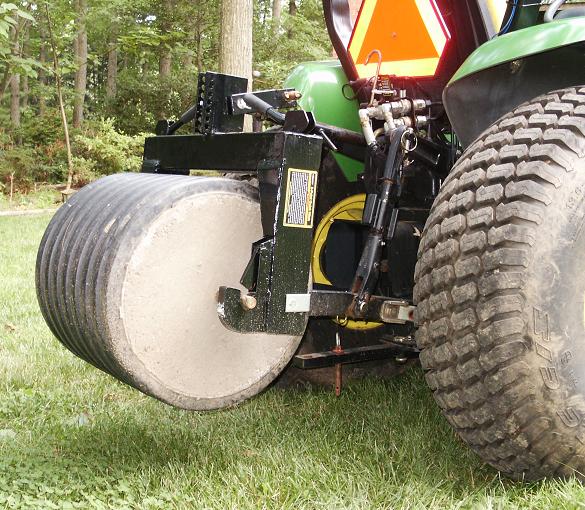

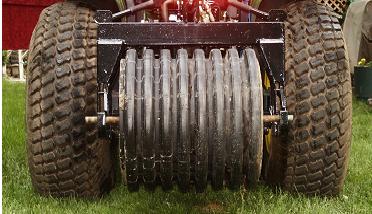

   / Rear Weight Box with real cheap ballast #17
Here's mine.
M.D.
   / Rear Weight Box with real cheap ballast #19
I need to take a pic of my rear weight. It's a 36" wide steel bar (5/8" -- can be found near roofing) from Home Depot through a Rubbermaid 21 gal or so container. Held 360 lbs of concrete (6 x 60lb bags -- approx $12). Works great and no top link to hook up since the bar is above center and the container fits snug in the Harbor Freight Quick Hitch. For my BX this is plenty of weight. Not pretty but cheap and works. Easier to hookup than Boxblade.
