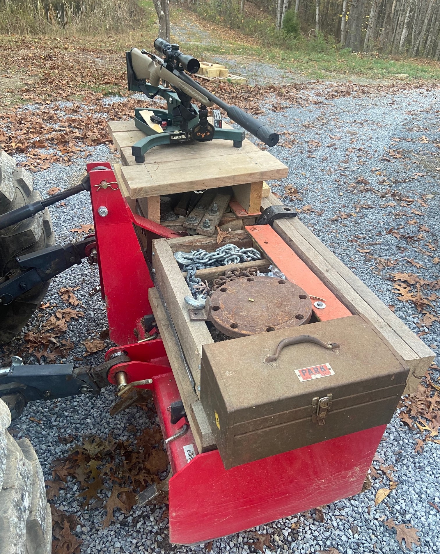

I have a L6060 that needed some weight added on the rear when I use the grapple or bucket. I wanted something that was also useful so I built oak 2x6 boxes on the top of my box blade big enough to store weights, chains, tools and spare parts. It has been heavy enough so far but it's easy to add more weight. The shooting rest was an add on. it's steady as a rock and can be moved anywhere on my property.

Looks good. Are your tires loaded?
I have an L5740 which is the predecessor to the 6060. Essentially the same except for 3hp. I had my rear tires loaded from day 1, but still encountered situations where the tractor was tippy with a big load in the bucket. A few years ago I added wheel weights in addition to the loaded tires. The difference is remarkable.

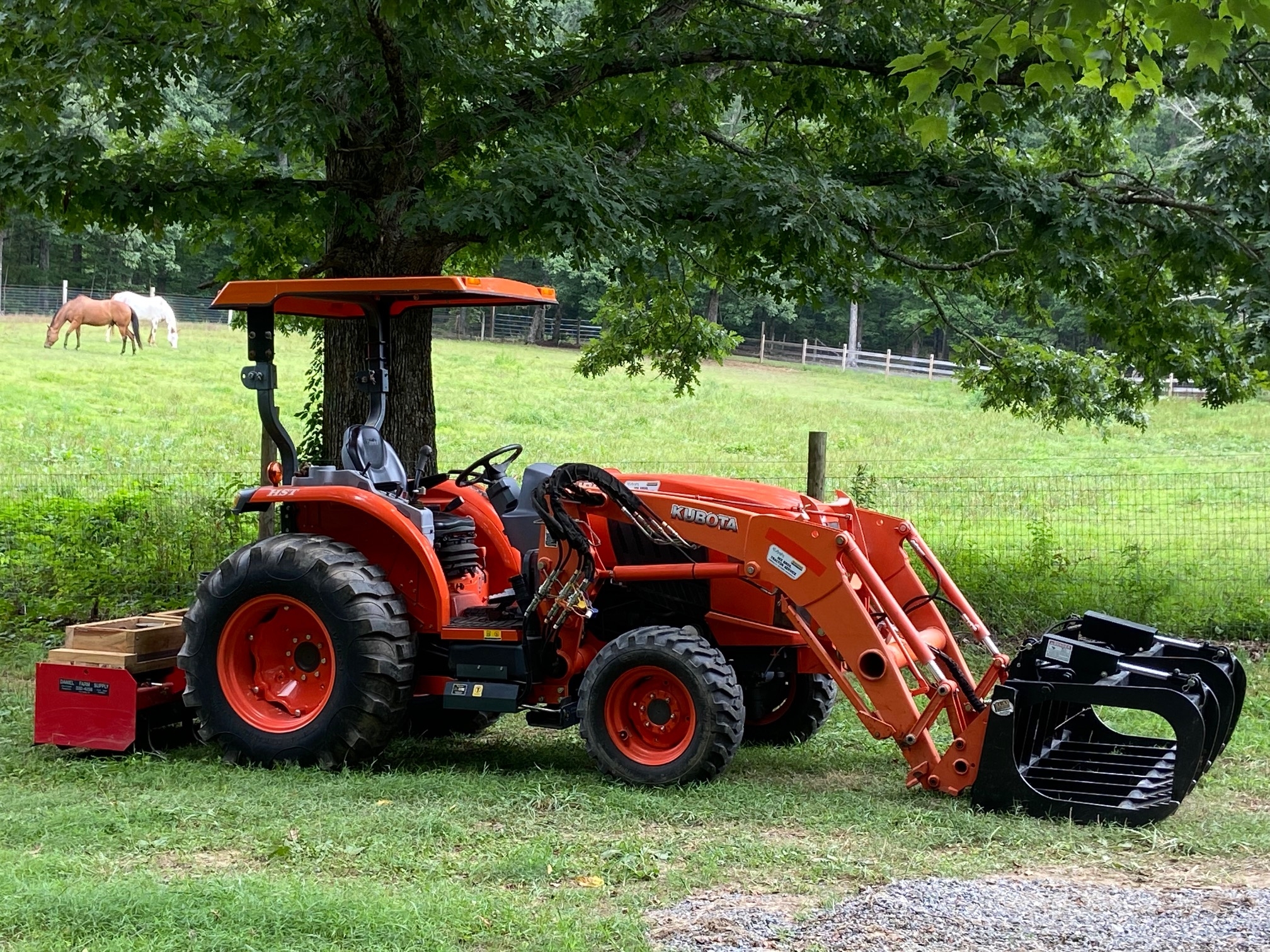

Tires are loaded but I live in a forest of oak trees and pick up some heavy logs with the grapple. It has an LA 1055 loader and with no weight on the back the rear wheels don't feel like they have a solid grip. The box blade with weight works good but I intend to add some more to it. Hope you like your Kubota as much as I do. I added a metal diamond plate top after a tree took off part of the plastic one.

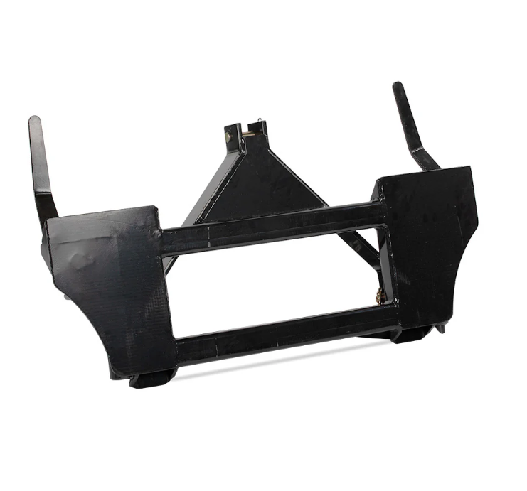

I use this 3pt to SSQA adapter to put my forks on the rear of my L6060. That way, I can pick up any pallet with a bunch of weight on it for ballast.
Since I have all my implements palletized, it also comes in handy for taking a second implement out in the field. Saves a trip back to the barn when doing certain work operations.
   / Rear weight for Kubota L6060 #9
Uhmm... May have to get one of those!
   / Rear weight for Kubota L6060 #10
It's a lot easier to use if you have a hydraulic top link. You can also put a FEL bucket on the 3pt adapter and scoop up a load of gravel for ballast.
I sometimes do this when moving material around. I can carry a load with a bucket on the FEL, and another with the one on the 3pt. Saves a lot of trips if you're moving material any distance.
