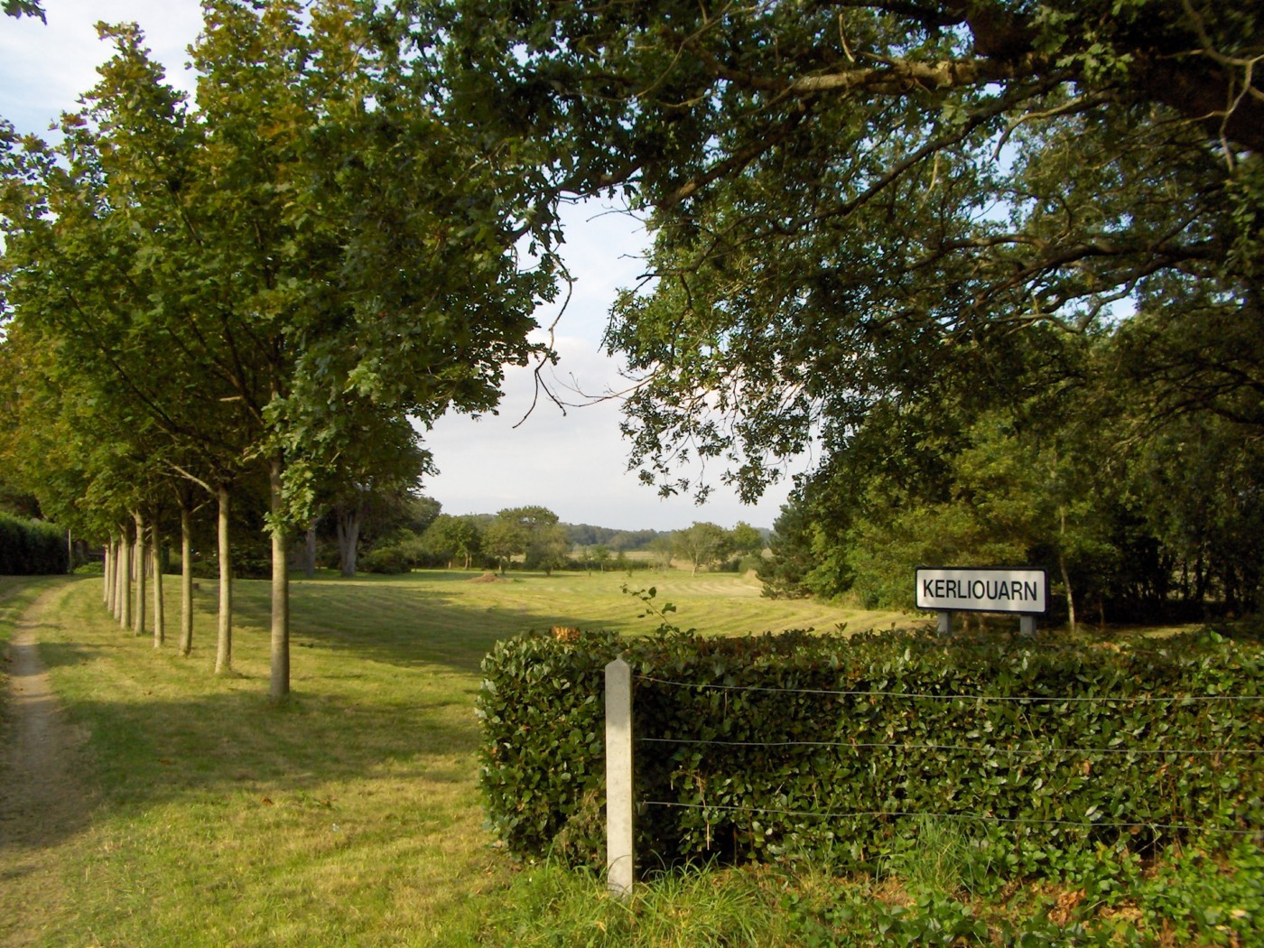

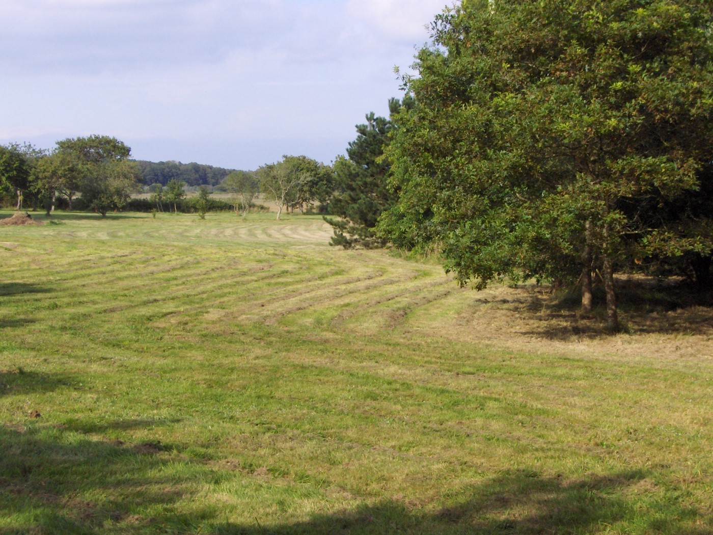

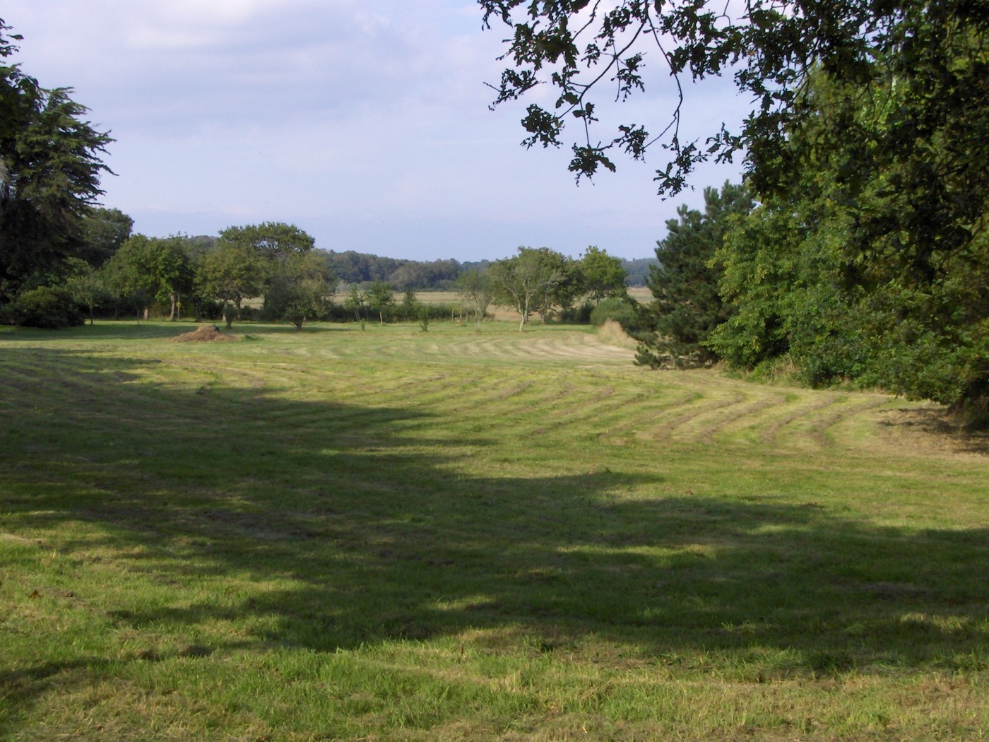

Nothing of the kind. The length of the chains is adjusted to keep the deck horizontal and a few inches above the ground as you can see in the pictures. It is important to keep it in the air (and use front weights) to be able to steer the tractor easily. The chains carry the weight of the back of the cutter, so no slack. The side rails only touch the ground when a tractor wheel is in a hole or when the slope changes abruptly, and then the chains allow the rear to come up as much as is needed. The cleverly designed pin heads on the Deere give some flexibility to the front, which was not the case on my Massey 35. Nothing like a finishing mower but the results are quite good.
