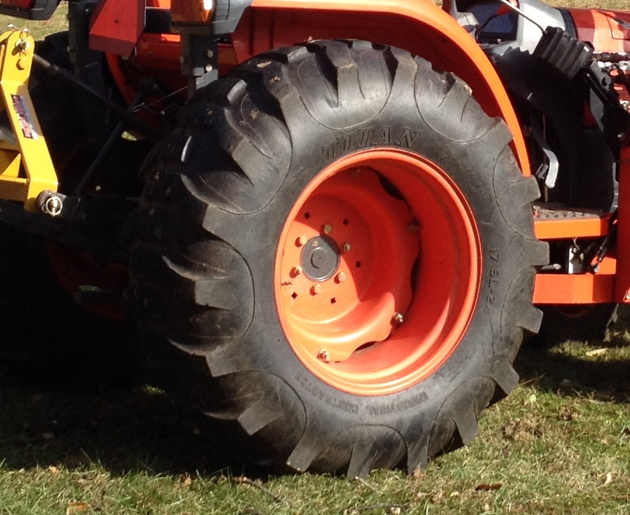

Citydude, That's some serious wheel width! Where did you go for the spacers? Any issues with axel stress?
I got the spacers from Motorsport Tech. I've got 150+ hours on them with no axle issues and absolutely the safest machine I've ever ran on slopes.

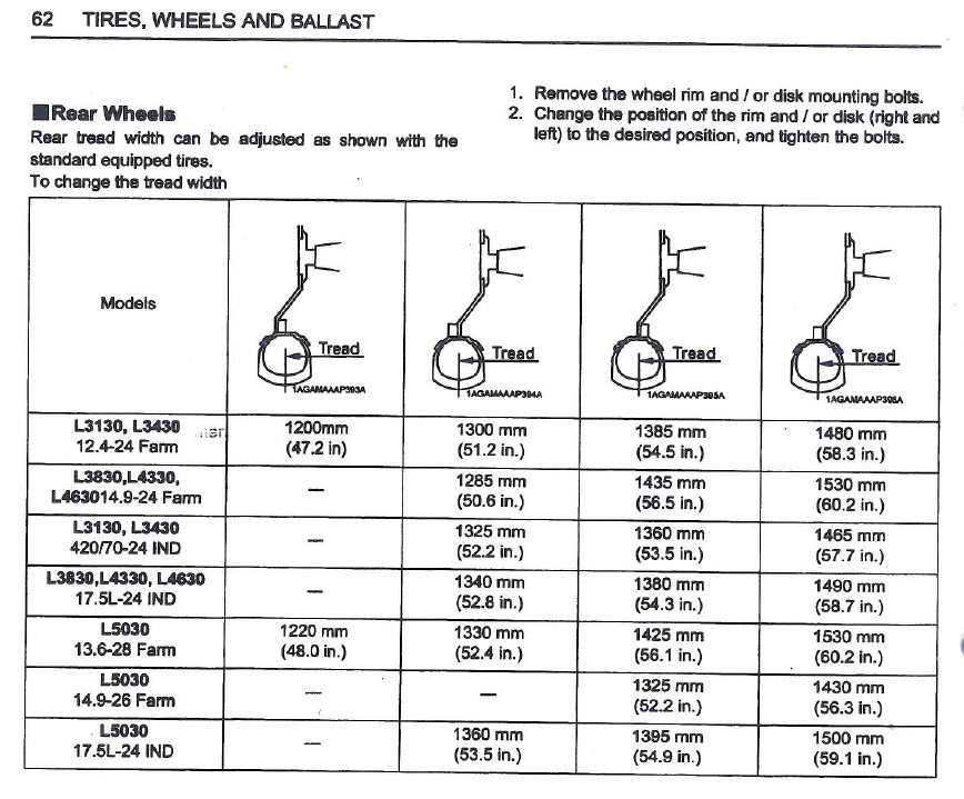

When you say reverse the rim and then place it either inside our outside, are you refering to placing it back on the same wheel or the wheel on the opposite side of the tractor. If it's the same wheel, wouldnt that change the direction of the tread?
Look at page 62 of the OM, I was trying to verbalize what it was showing. When I had mine spaced out, they had to change sides to keep the tread in the correct direction. My rear tires are marked for "traction" and something else. The local Kubota dealer knew what to do and did it.
Saved (stole) this from a thread a long time ago, cause the topic keeps coming up.

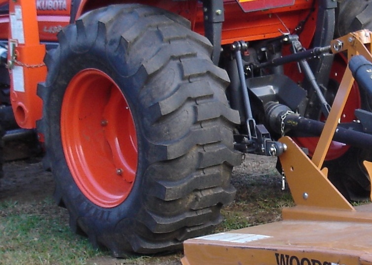

I flipped the fronts on mine too. Only downer is the valve stem is on the inside which is really not a problem. I think it only supposed to go on one way(lug nuts), but it works fine. I have narrow trailer ramps so I needed to make this change..
Mine are all the way out.,

Well according to the chart a L4330 can't use #1 (no clearance), it is #3 because the rim is behind the disc.
For #2 and #4 the rim would be visible in front of the center disc.
