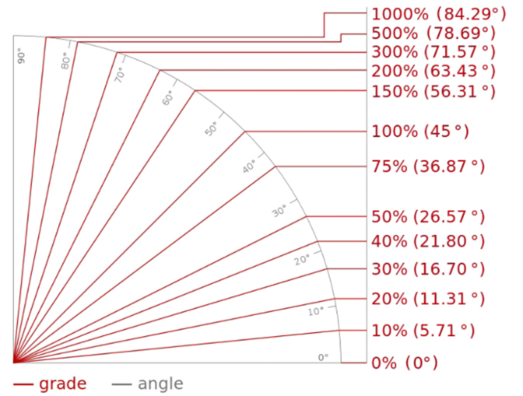

So for my next question. Assuming that a slope is consistent in angle and dry, at what grade should I be concerned about running along with versus running up and down? This is with the FEL and 6' bush hog attached.
/ Rear Wheel Spacing #32
Thanks again for all the photos and good information.
This is a 50% grade or 26.6 degrees, with the 7' brush hog on the front.
Don't think I would try it on a tractor. :eek: :shocked:
