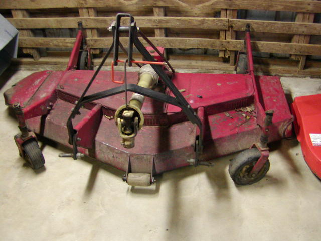

This is the 6' Bush Hog finish mower I previously mowed with.
