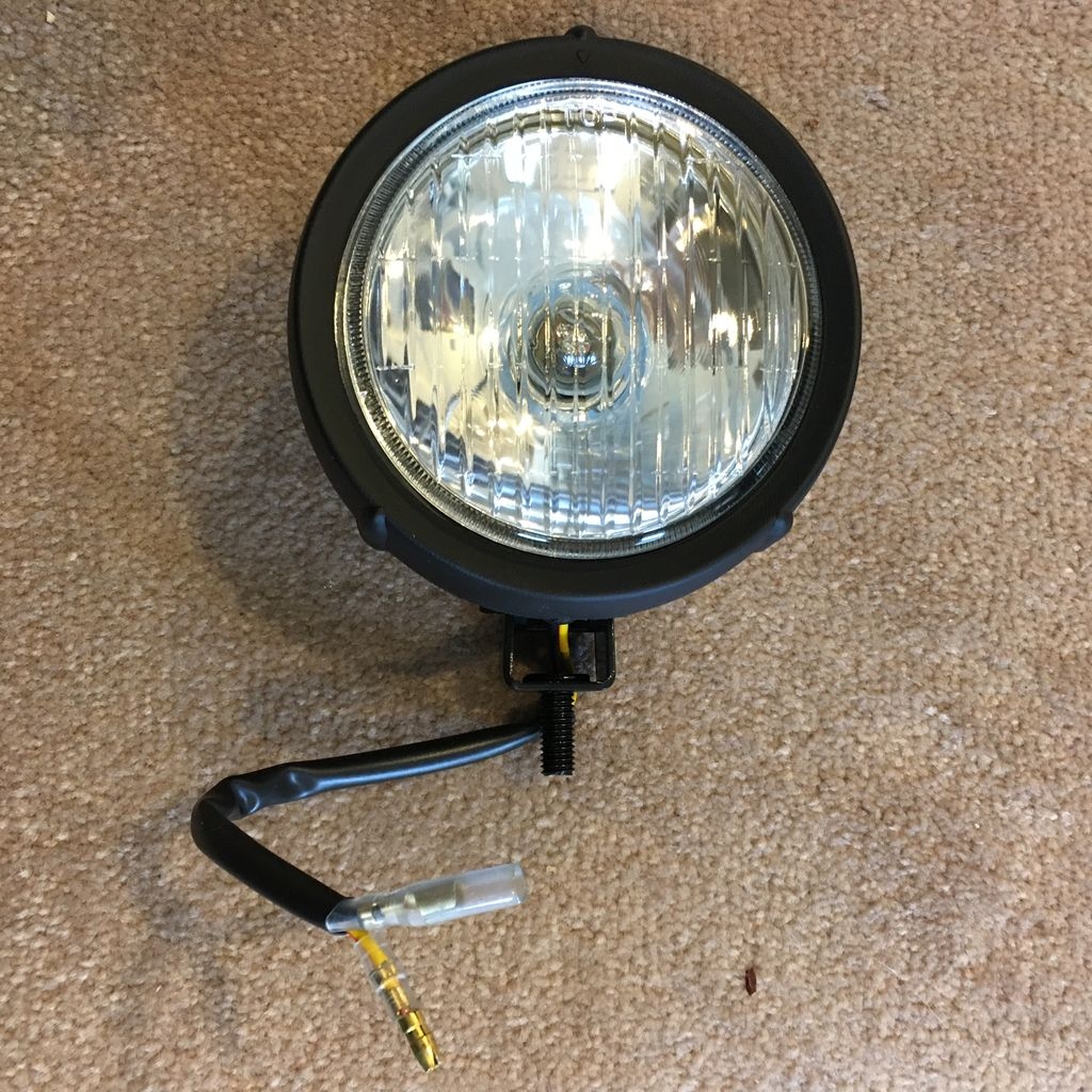

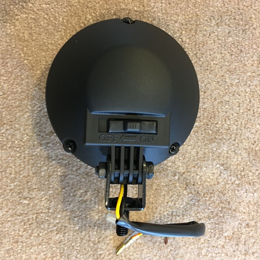

A rear work light is a factory fitment to the Boomer 45, but not available as a kit. NH parts catalog doesn't include description or parts photos (for the most part).

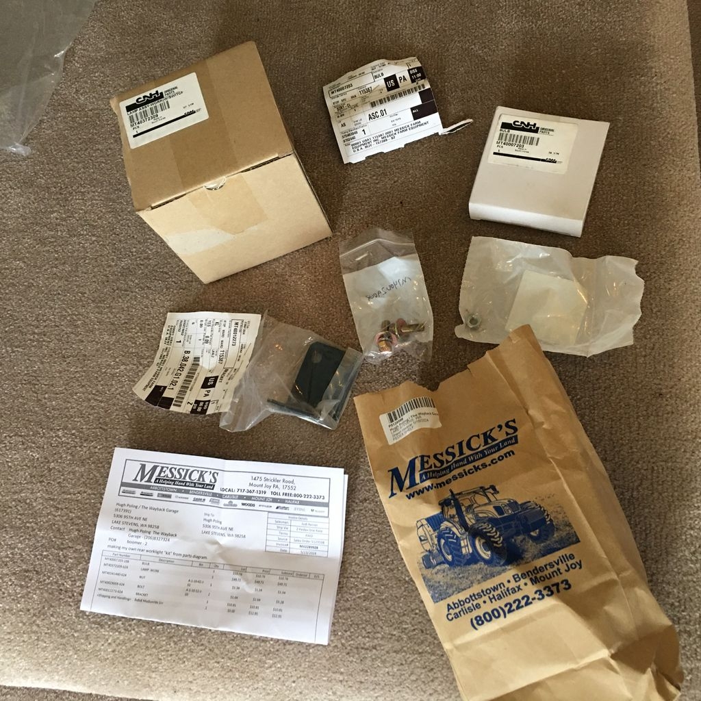

I ordered these parts to make my own worklight kit (hats off to Messicks). I didn't bother with #10-12 power socket.
ItemPart numberDescription
5MT40012273Bracket
6MT40029008(2) BOLT,Hex, M8 x 1.25 x 25mm
7MT40241460NUT,Hex, M8 x 1.25
8MT40372309LAMP, WORK on-off switch on housing, uses round bullet connectors (includes bulb, so MT400077203 is replacement)
9MT40007203#1156 BULB,12V/(23W in catalog, 27W marked on bulb)
Power is supplied by an existing green/red wire through round bullet connectors. There is a switch on the light to turn it on. The main key switch must be also be “ON” for the light to illuminate.

You would be way better off just getting this entire Work light Ag kit for less than $10. (y)
And the 45W halogen light is amazing for how it lights up the area!
