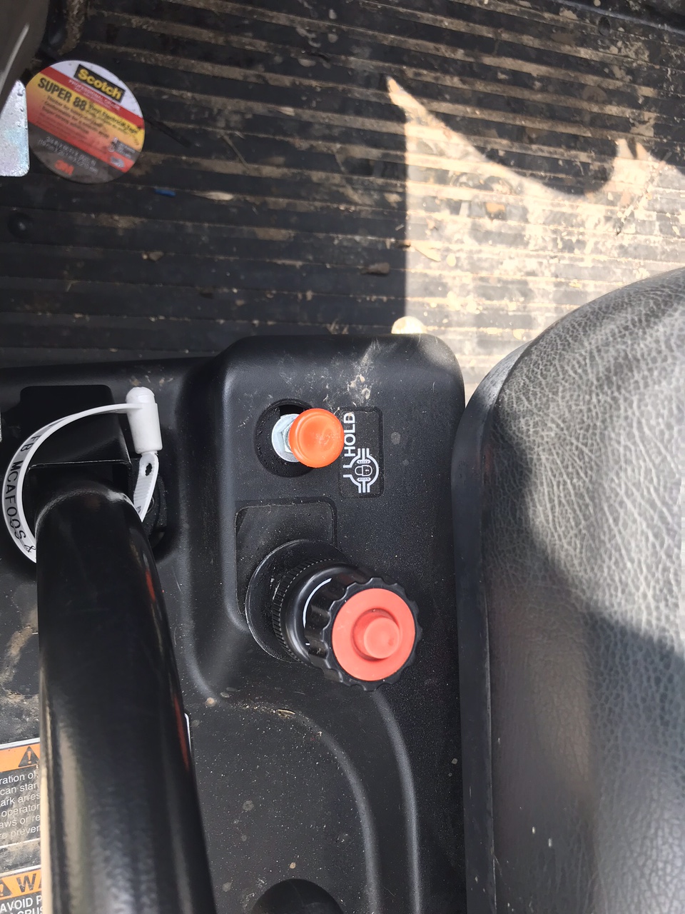

For you guys with RTV Kubota Machines. I put the factory hand throttle kit on my 1120D. When you do this the accelerator pedal just controls the HST like a treadle on a HST tractor (obviously no reverse). This allows full engine power to pull heavy items, logs, trailers,etc. it’s a nice kit that is not hard to install and is useful in some situations

So you will lose some oomph because it's the heavier model, and you'll loose some oomph at altitude for sure. But the baseline is strong with plenty of margin in my experience.
Remember it's an HST that is geared lowest at the minimum engagement and gears itself higher the more you press the pedal. So don't mash the pedal on a hill since that gears you in the wrong direction.
If there are concerns, installing a hand throttle kit (which can be bought from Kubota or rigged up with a generic hand throttle control) would really help. See post #131 above. It will let you throttle the engine up higher while keeping the HST down in the low range. The default pedal setup changes throttle and HST at the same time and works pretty well for all around use, but it's not ideal for situations where you need maximum power and the lowest gearing.

It's a steep learning curve for the driver. Took me awhile. Pushing the "go" pedal to the floor is not the preferred method when climbing.
Not sure of your experiences so just throwing this out. It's just like driving an HST lawn tractor or small HP SCUT. The more you push the pedal the higher the gear ratio.
If you have problems, add the hand throttle. In hard pull situations run the engine at full rpm with the hand throttle then control the gear ratio with the foot pedal.
I think you'll be fine. Will just require some patience and learning.
   / Reasons not to buy an RTV 1100C? #140
I agree. I have the hand throttle kit on my 1120. It allows the RTV to be operated like my HST tractor. You set the RPM and your foot controls your motion
