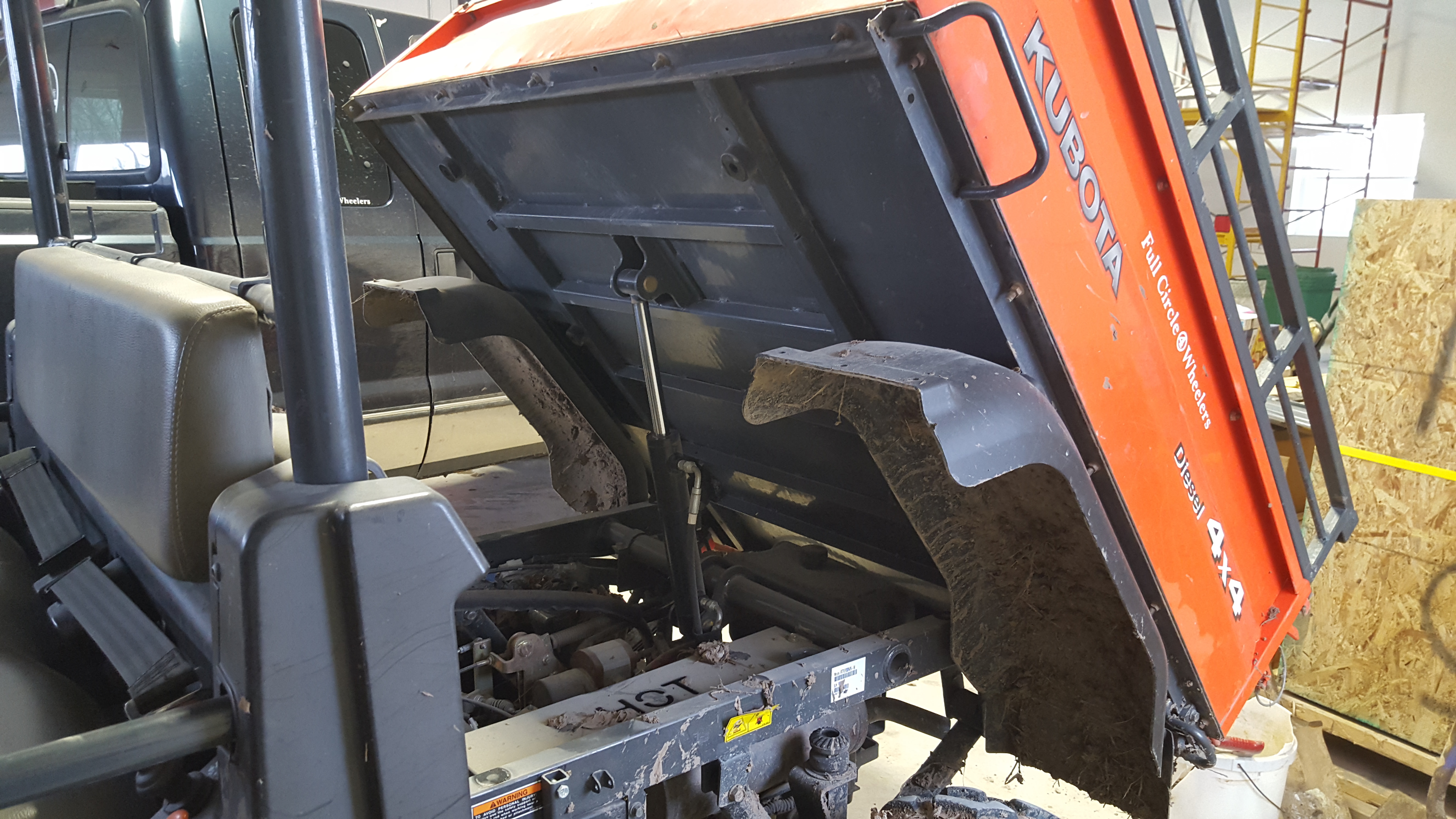

I didn't realize the RTV bed lift had been changed.
Here's a pic of mine. Lifts the bed with no twist.
In my opinion... Yours is a better design and less likely to twist the bed frame. That is how they all should be. The Kawasaki Mule Pro will be like the late model RTV I showed you.

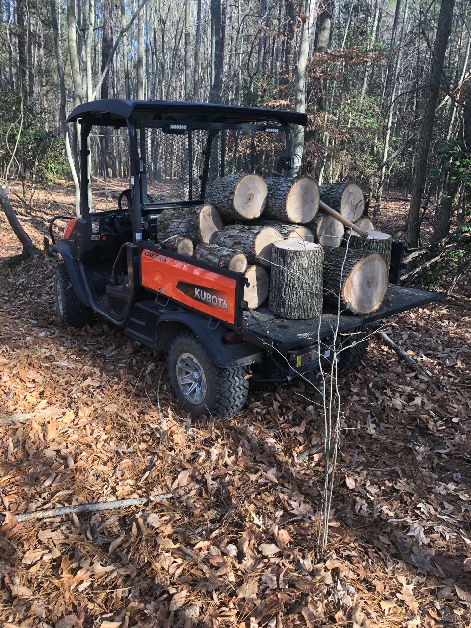

In one of my pics above with the load of wood. Did you notice the large log laying behind the RTV? I dragged that log just short of 1/2 mile while carrying that load.
