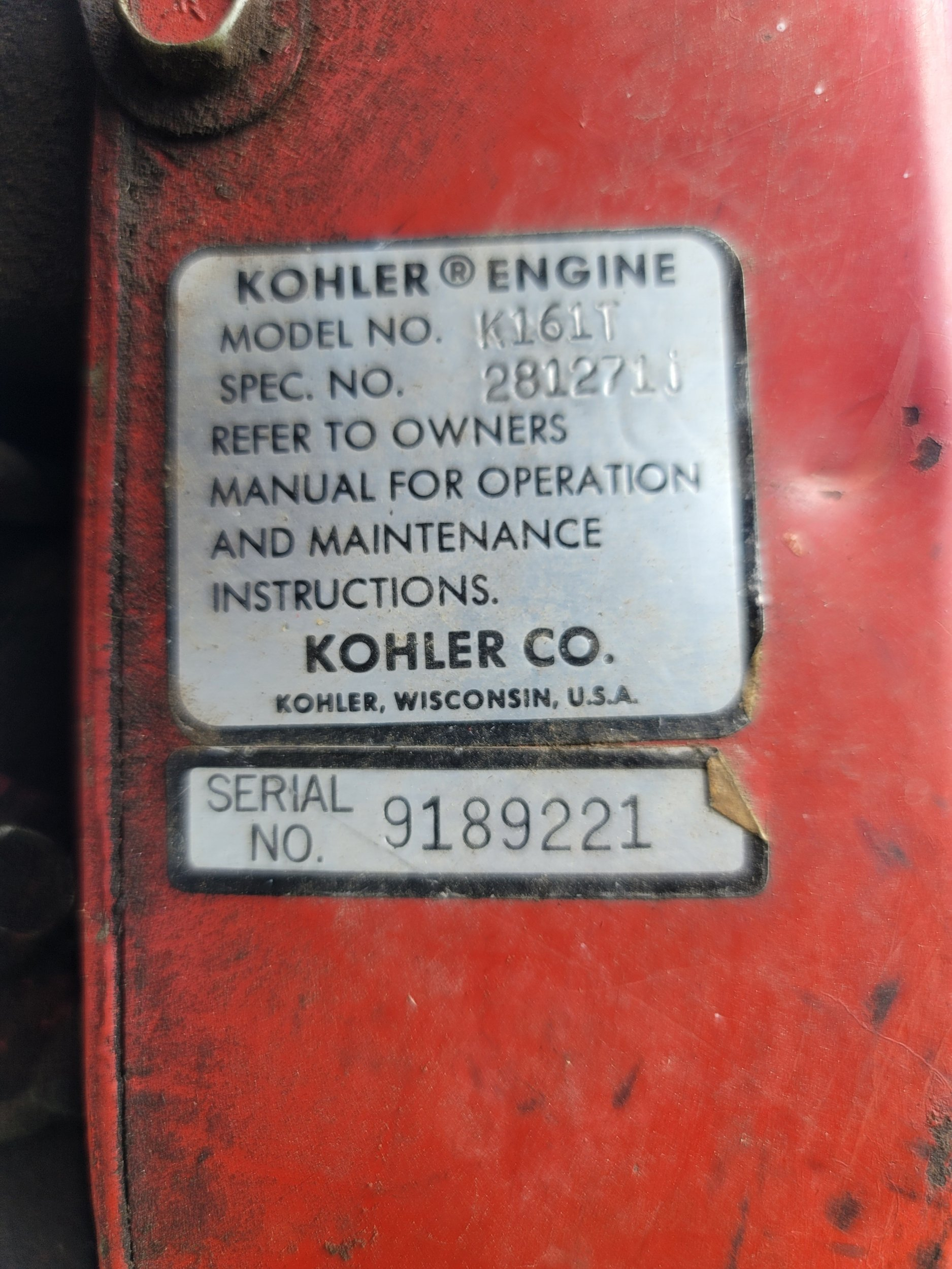

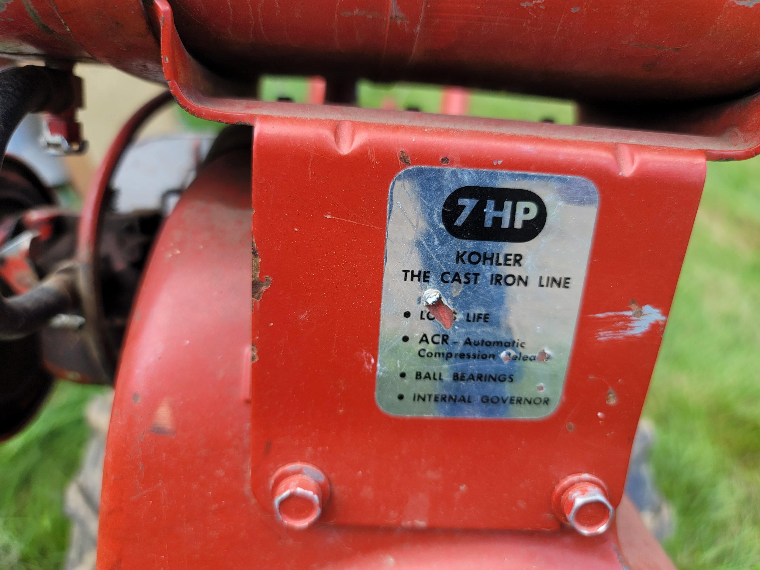

I have a dilemma. I inherited by father-in-laws Troy Bilt horse tiller that was bought sometime in the late 70s. It starts easy and runs smooth but has lots of issues. The transmission slips really bad unless I wire 20210724_143322.jpg20210724_143335.jpgdown the lever. I have to keep constant pressure on the throttle. I live in Maine and have been unable to find anyone to do a complete restore job. Do you know of anyone in the western maine area who would take on such a project.
Is it worth it to spend a lot of time and effort to get this rebuilt or should I just replace with a new Big Red Tiller or other recommendation you may have.

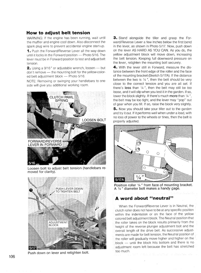

Sounds like you need a couple of adjustments before making a decision.
Here's one that covers the lever adjustment.

Not knowing your model, here is a typical lever adjustment.
Bruce

One thing that has not been discussed is balance and weight. Kohler M Series engines are made of cast iron and use a very heavy flywheel. Your Kohler may weigh twice as much as an aluminum Honda clone engine. So depending on the style of tiller you have, using a lightweight engine may affect the balance and performance of the tiller. Front-tine models are notorious for bouncing around. Rear-tine models use the engine weight to offset the tine area weight when you have to lift the tiller up at the end of a run and quickly do a 180 for the next pass.
When Troy-Built engineered your tiller, they did so in full recognition of the engine weight. This too.... is something you may wish to ponder while deciding on a course of action.
