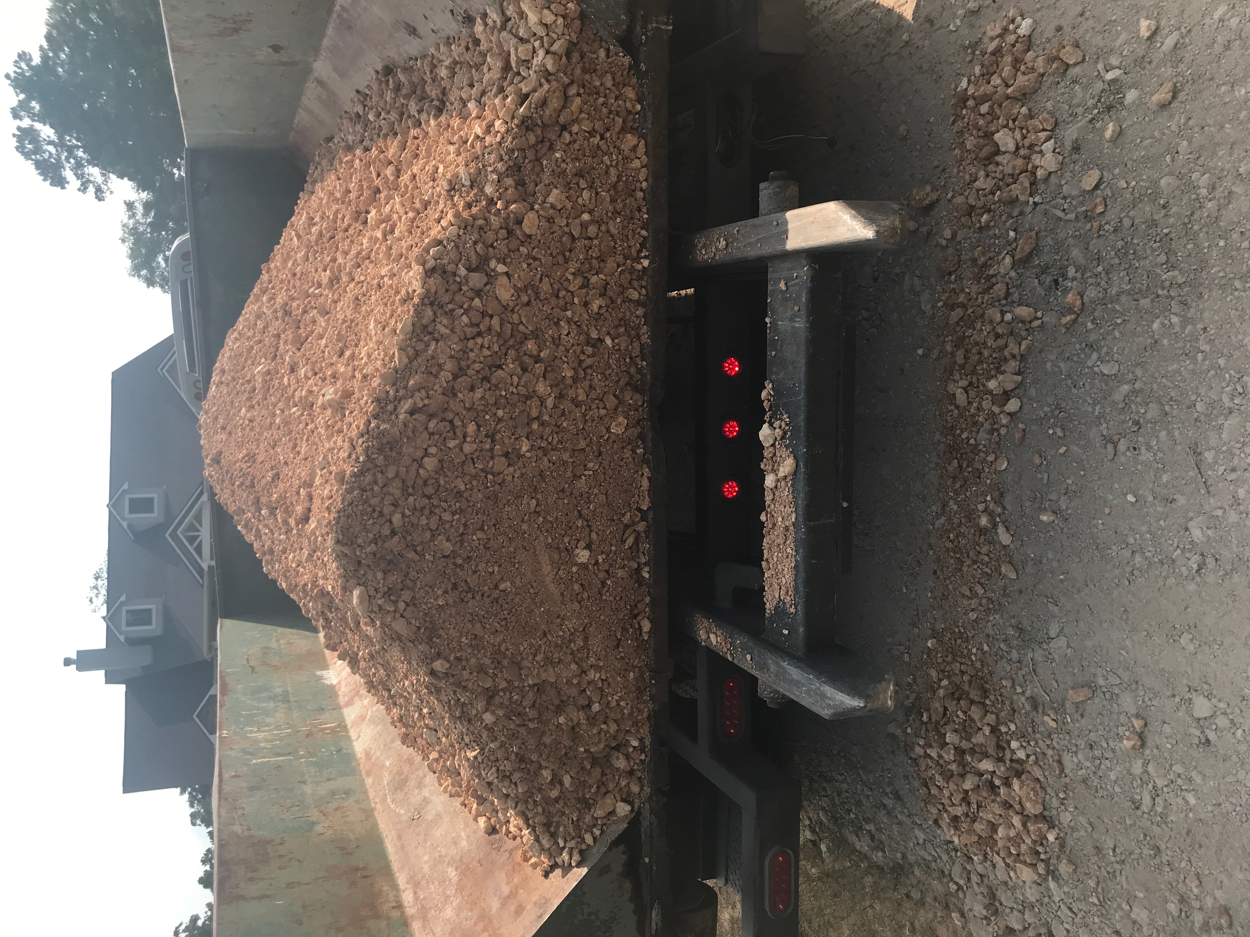

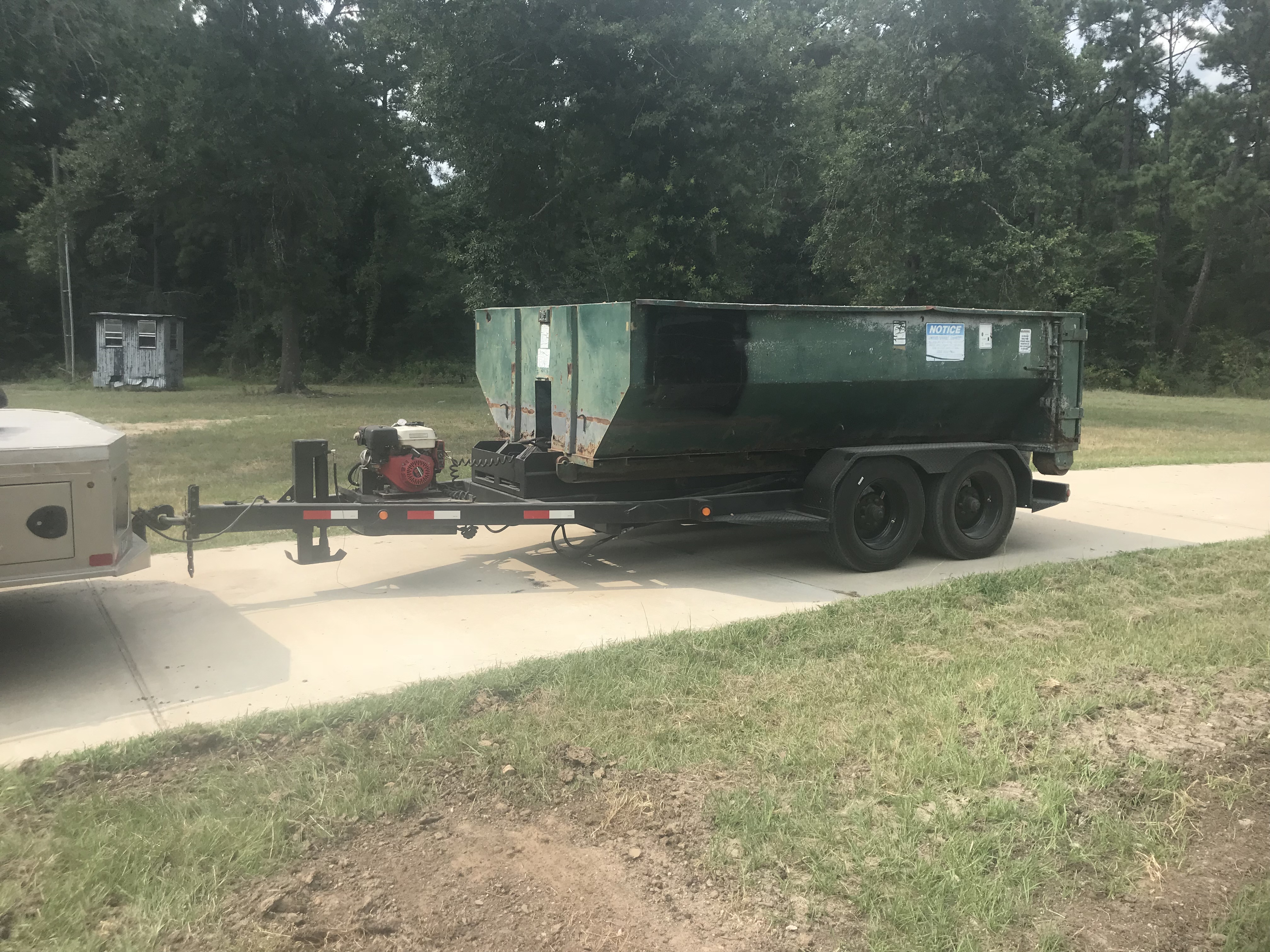

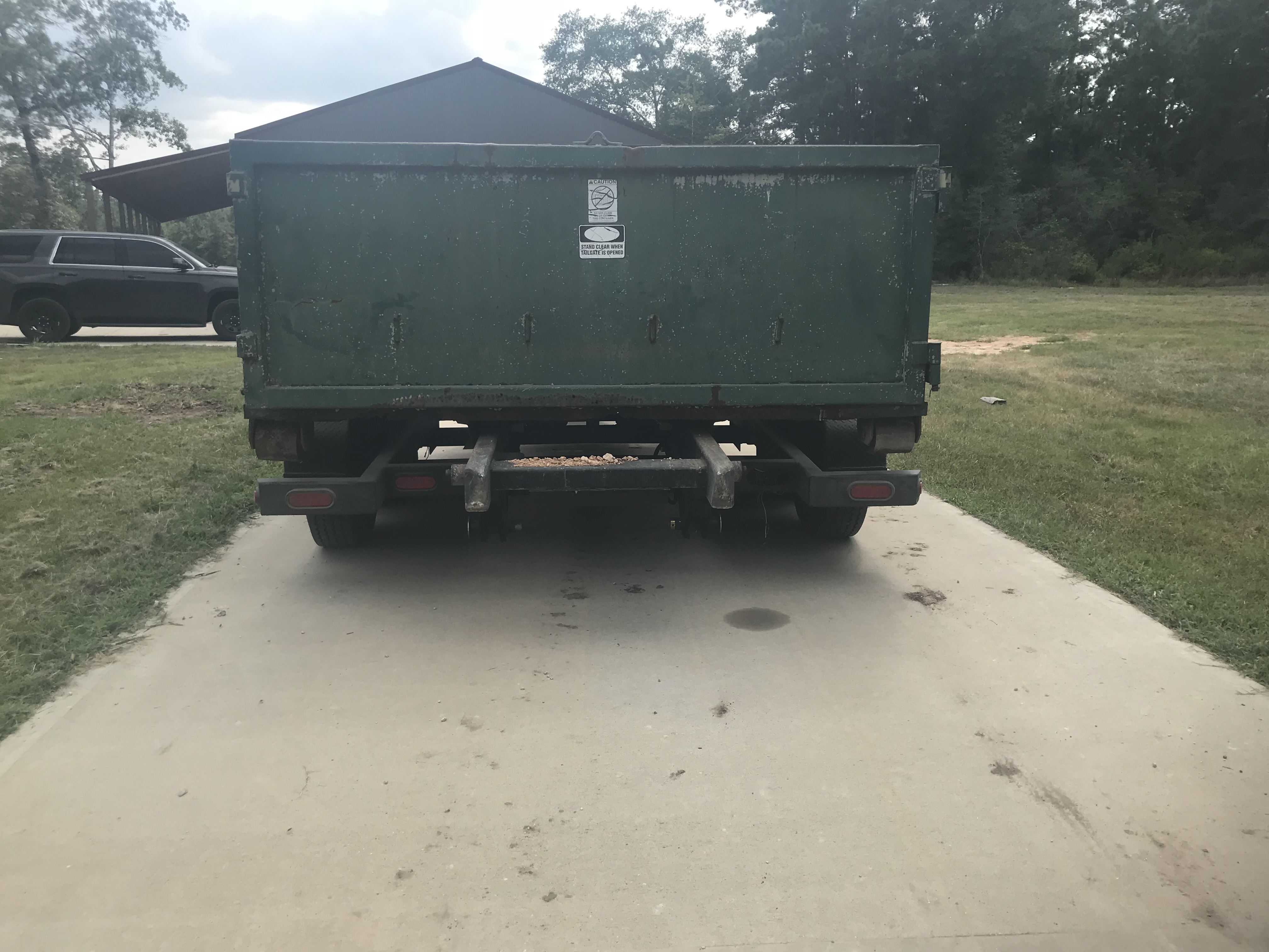

Took another load to the dump but stopped off at a real rock place for a load. Total rock came out to 13k and gross was 28+k lbs. dumped it easily. Loving this thing so far. New plasma came in and miller 252 will be here Wednesday. I値l start working on the boxes and making them into something I can use. I値l pull the best two for use as a container and the rest will become flatbeds or sold. Could get 1000-1500 out of each of them I bet. They need a couple hundred in welding but new are 4K
