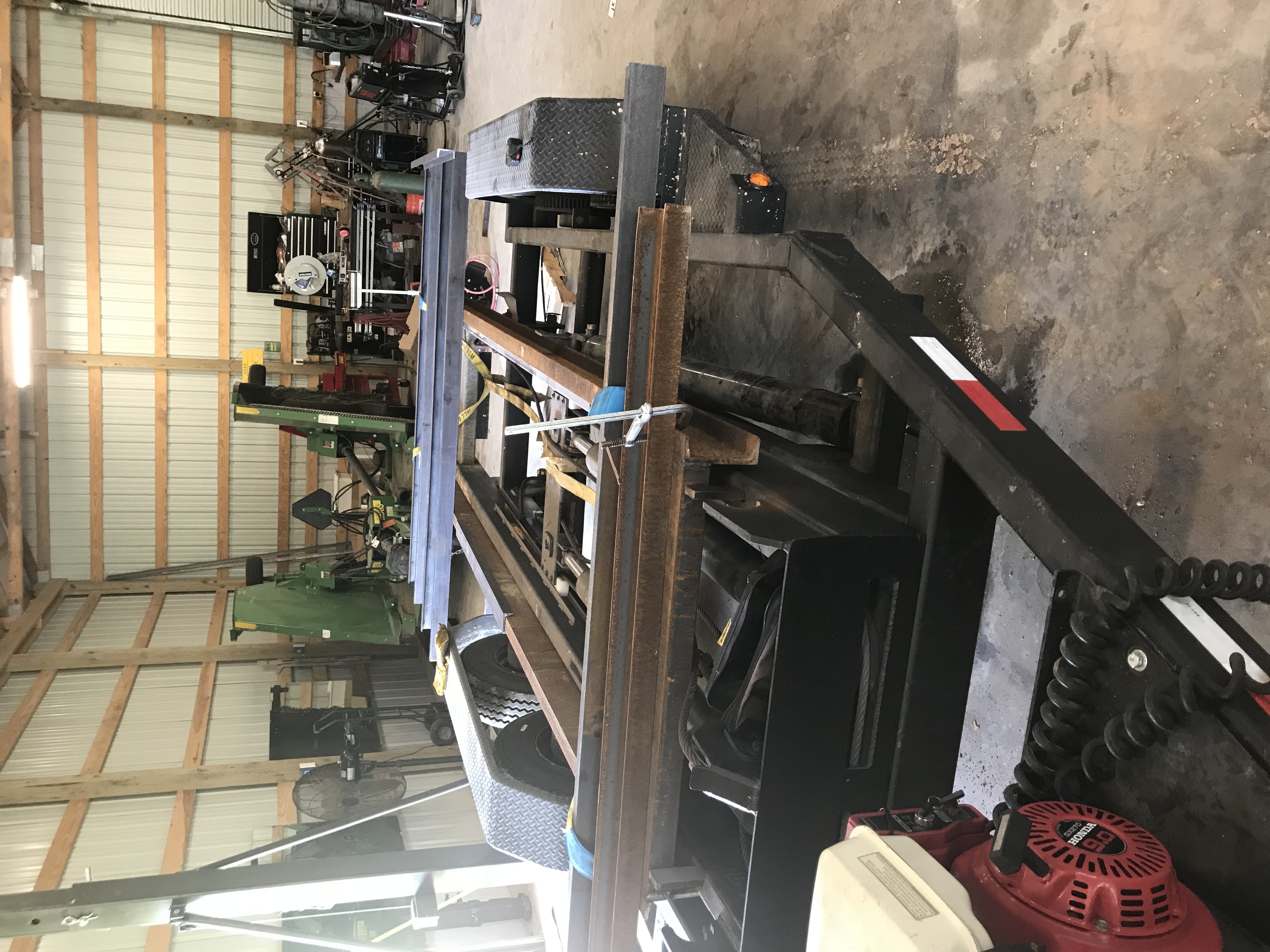

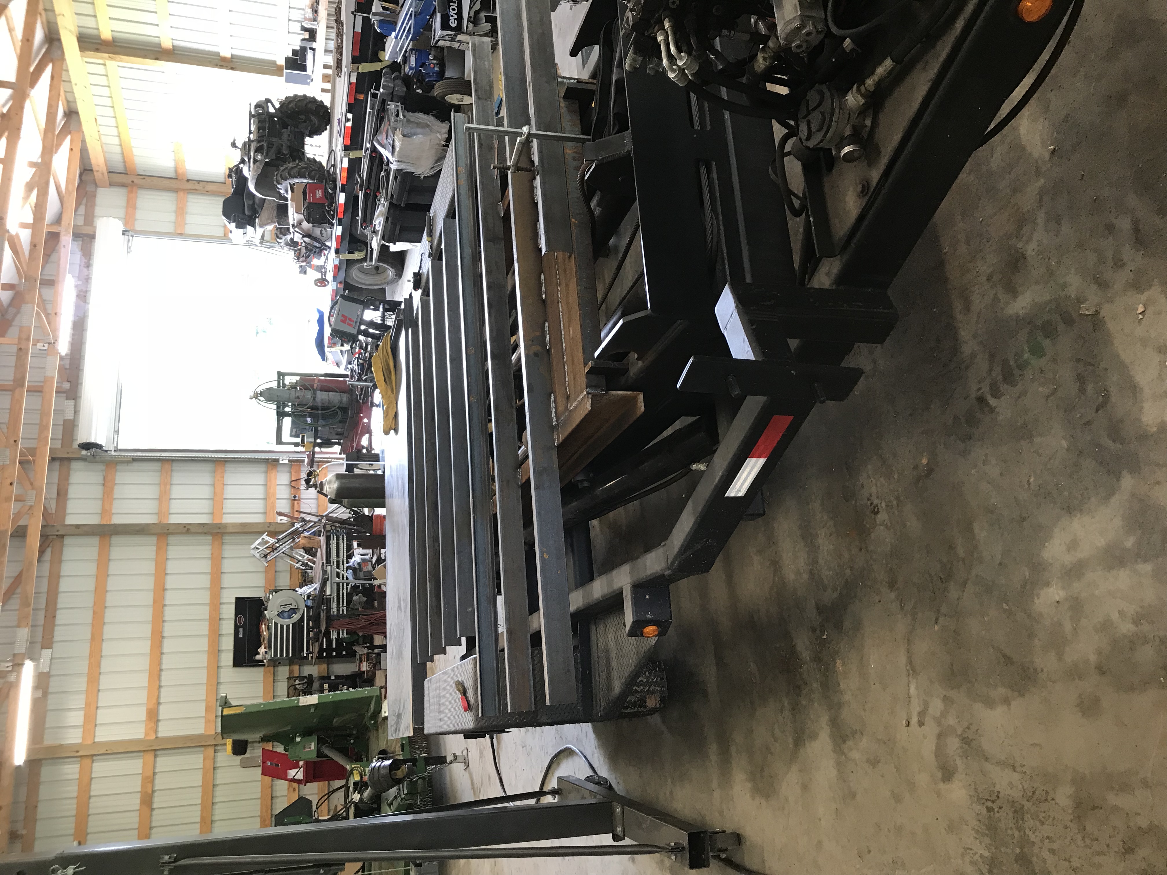

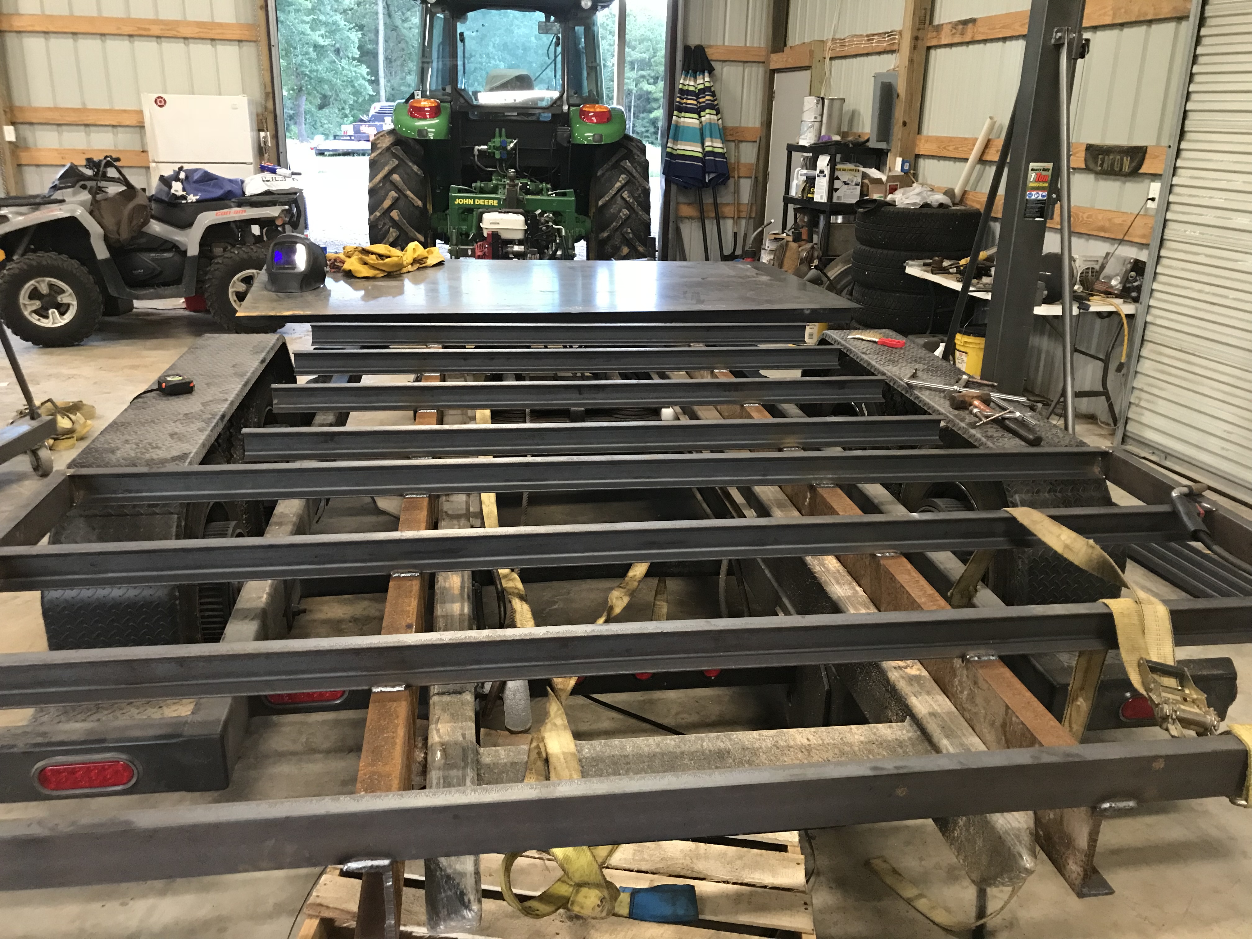

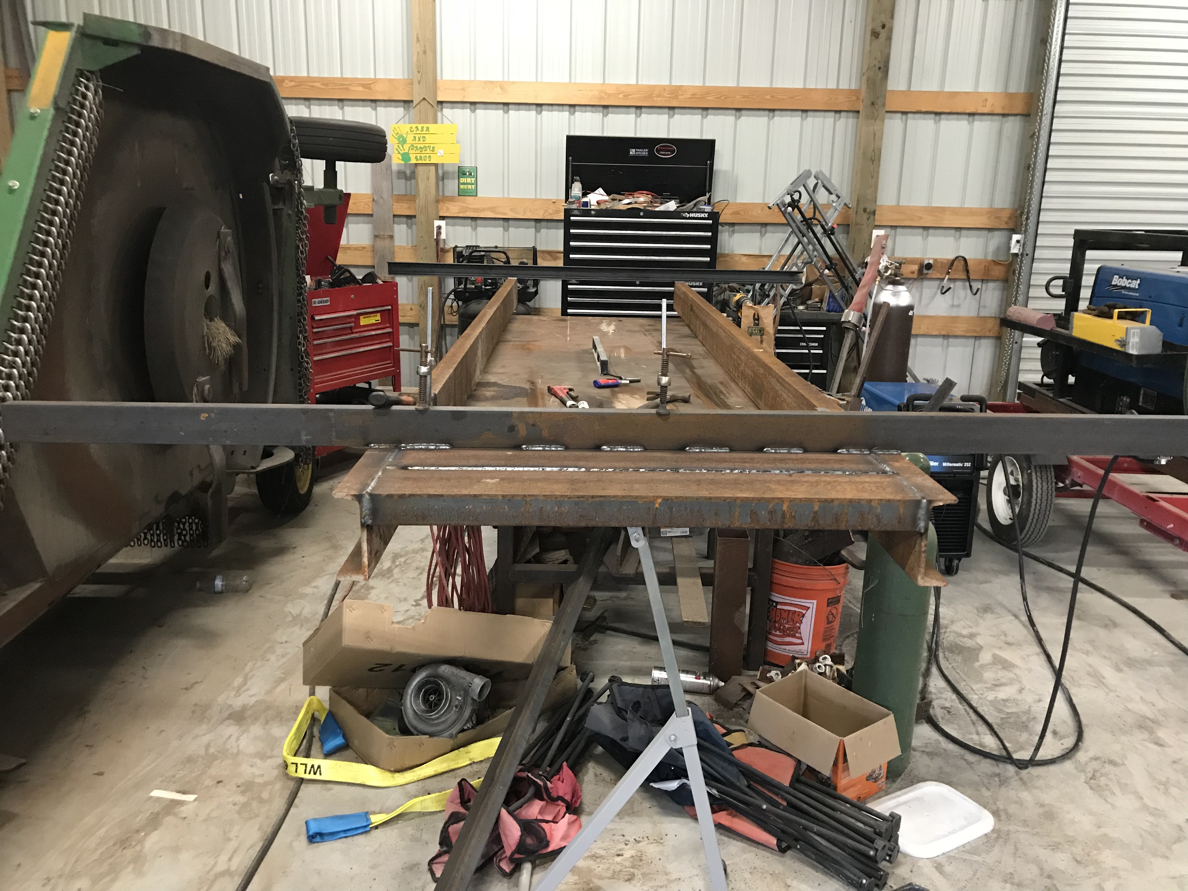

#44
Never got around to drawing up flatbed plans. Just started building it. Was going really well until I test fit a piece of 4x8 plate and noticed it wasn稚 square. I guess I bumped it or my son did and that made the rest off by an inch. I arc gouged and corrected one that matters but the others doesn稚 really made a difference. Once I finish with the channel on the outsides and tie it all together I値l tack the plate, flip it over and weld it out. Have a plan for the hook too.
Plasma is awesome and can稚 believe how much of a difference the miller 252 makes over the Lincoln 210mp
Brett
