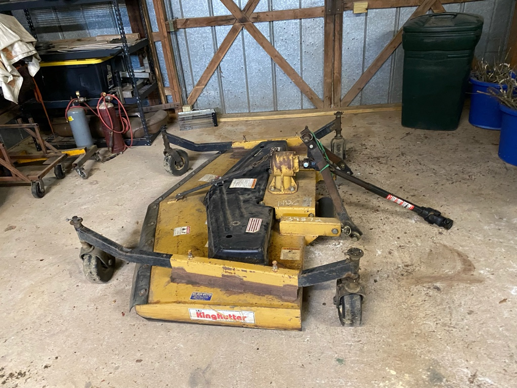

Started working on my finish mower today. I decided to paint it as there was corrosion starting especially under the deck.
The plan is painting the deck Massey red and the gearbox/ mounting plate Massey gray. I might paint the hitch brackets Massey gray or black I haven’t decided.
The pulleys and swivel assemblies will be black and the wheels silver.

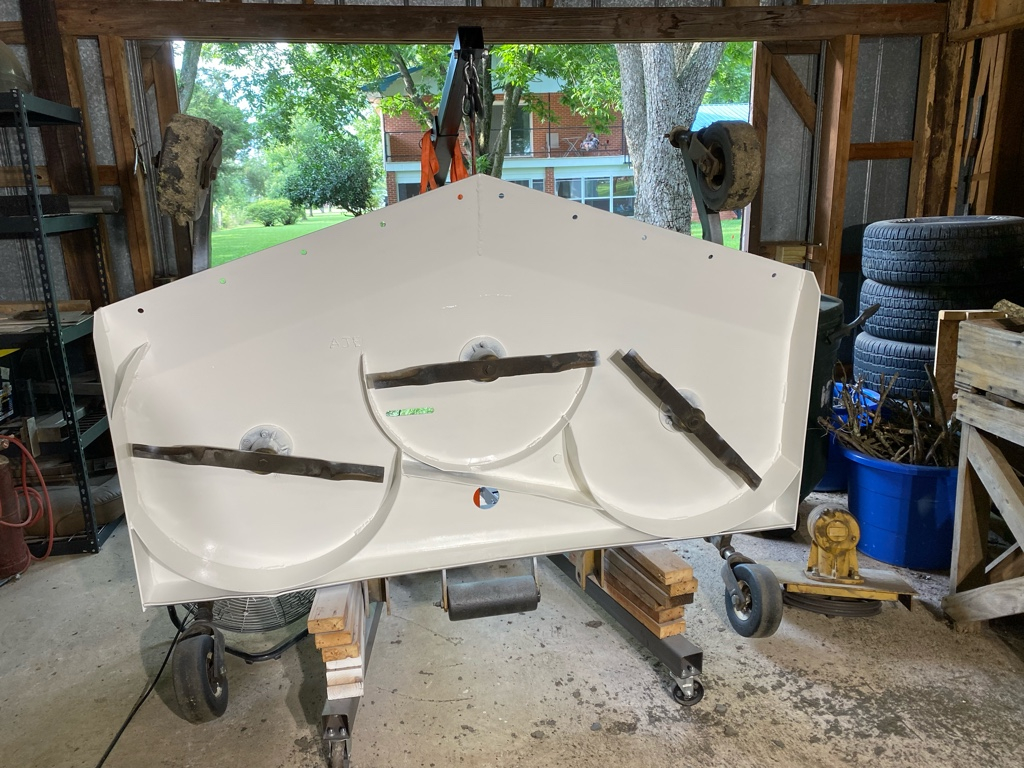

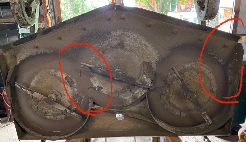

Today I replaced a missing baffle and painted the underside to help slow/stop the corrosion. I chose white to make it easier to see while working under there in the future.

My thoughts on the white were:
- Cheap/easy match
- provides good light when working under it
- Will show trouble and dirt sooner/easier.

Current pricey casualty list:
- anti scalp roller
- blade spindles
Lots of little issues but nothing terminal.

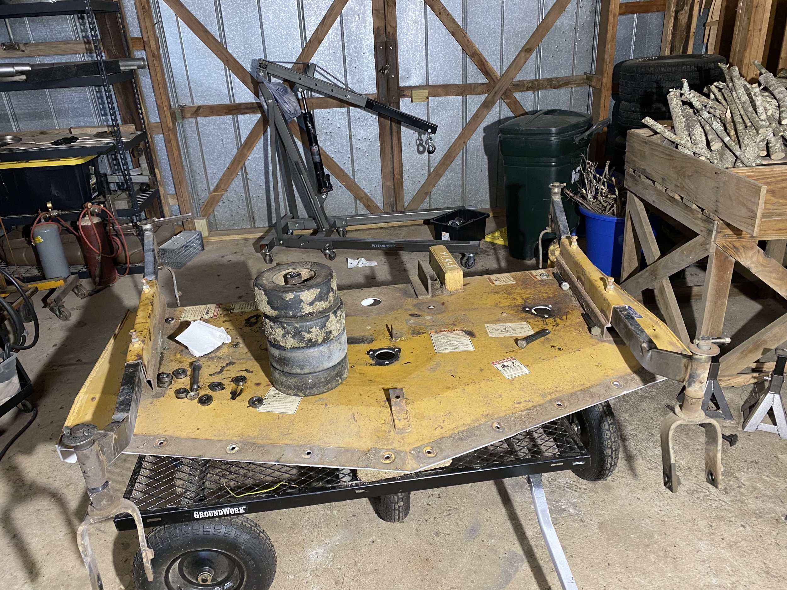

Also figured out axles and wheels bushings were shot.
Fortunately replacement bushings are available for $30 on Amazon and includes enough to do all 4 wheels.
Axles were cheap through Rural King.(3/4x5 bolts with a very short thread and long grip)
