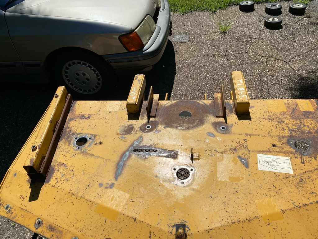

Today was a very wet day power washing the deck and larger parts
- 1st reason was degreasing/deep cleaning to save some work later.
- 2nd reason was to rinse off the rust converter when I was done using it which also etches bare metal to prep for paint
Tomorrow I will fabricate the belt cover hold downs and cap the rusty rectangle stock ends to slow the internal corrosion.
I may or may not get to sanding and priming

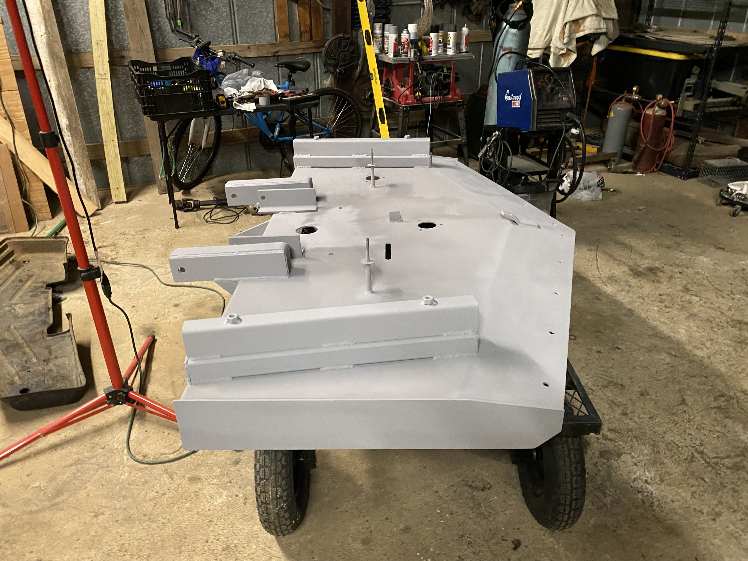

Got the belt hold downs and priming done.
Tomorrow I’ll do some light sanding if needed to make a good surface for the paint.
After that I’ll be prepping/painting things like the gearbox and wheels etc.

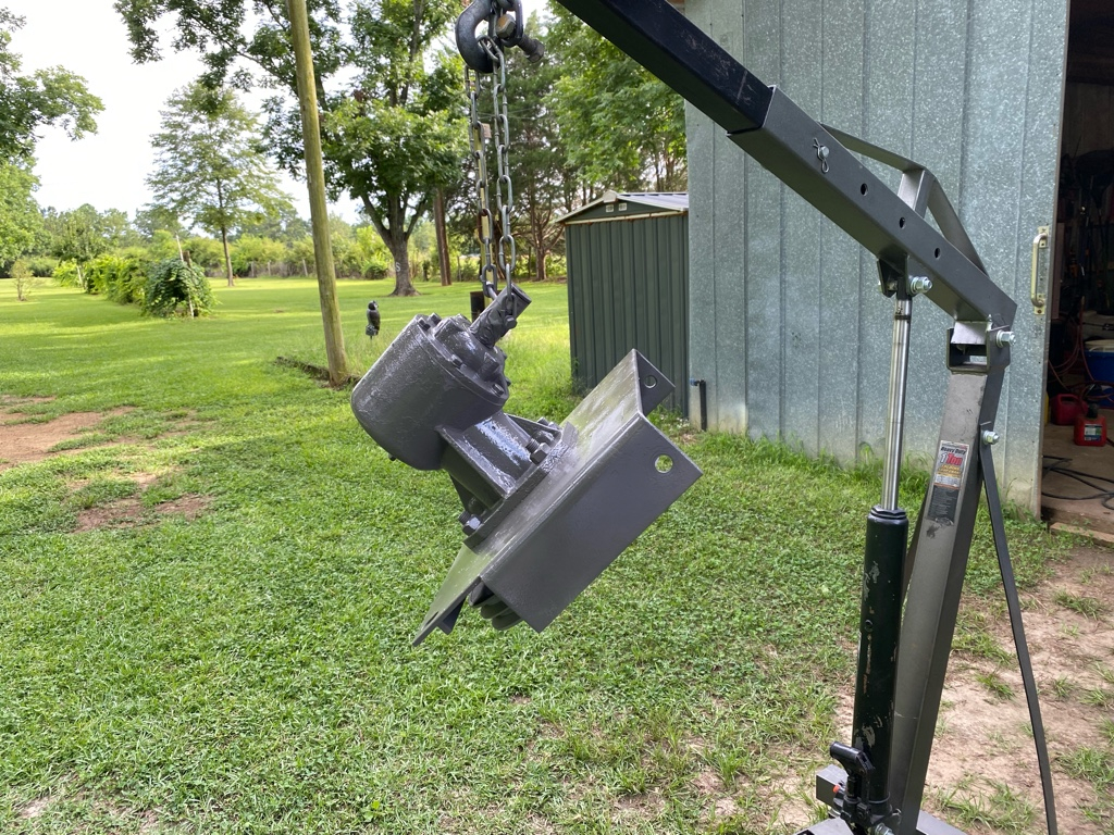

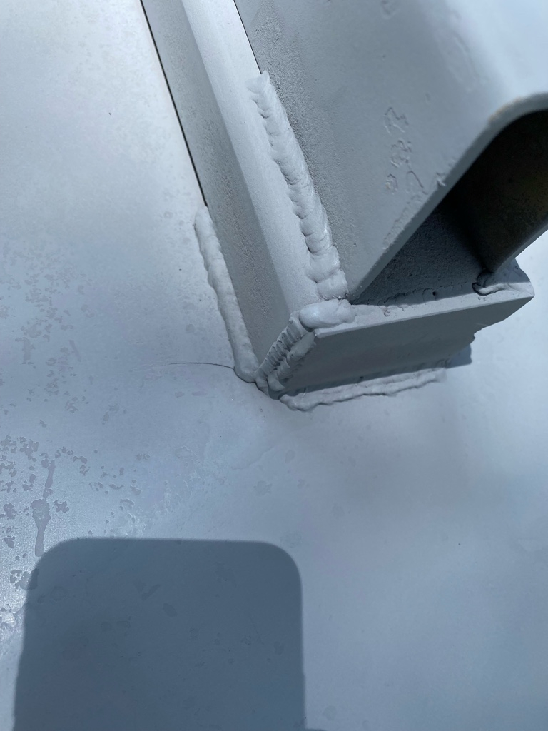

Discovered some cracks near where I capped the the rectangle tubing.
I welded the cracks up and painted the gearbox today
