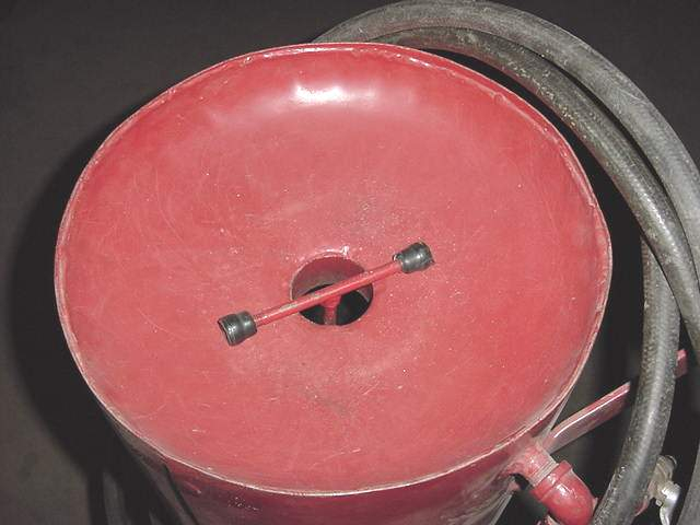

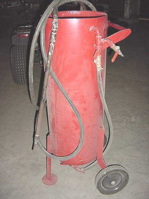

I've been thinking about building one of these for a while and finally made the time. You're not going to make a living with this little pot, but for small jobs it does a good job. I'm refurbing a 5' brush hog and debating on blasting and painting that. I'll probably regret it half way through, but a little regret hasn't killed me yet. Photo of the final product and my #1 helper.

Looks like we have them plumbed the same way. I extend the wand and used 1/8 xxh pipe nipples for nozzles. Got a bunch of 6 and chopped them in half. I need to get some more, I forget.
/ Homemade sandblaster #6
I once DIY'd a sand blast system.
Worked quite well for minor tasks.
To prevent my glass viewing window from getting blast fogged I added black nylon window screening about 1/2 inch from the glass. The sand beads simply bounced off of the screen leaving a clear view.
Another trick was to use duck (duct) tape on things you did not want blasted like perhaps shaft ends that fitted a bearing.
