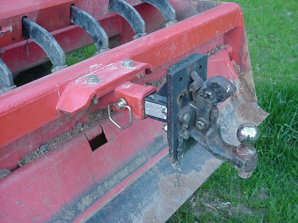

Here is what I added to my box scraper
   / Receiver for hitch on Box Blade? #18
I like the patriotic paint job.
